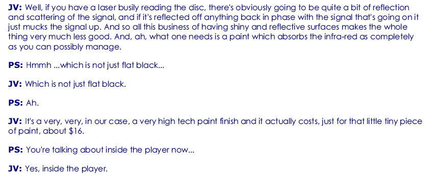

Any special paint used on the innards of the laser pickup device would be selected to be black at the specific IR light frequency. What looks black to the human eye may not be black at that IR light frequency. This would improve the contrast of the optical system, just like camera lens barrels and telescope barrels are painted black inside. This may cut the bit error rate down some, but beyond some point, you won't hear any difference, as error correction will mop up the errors.

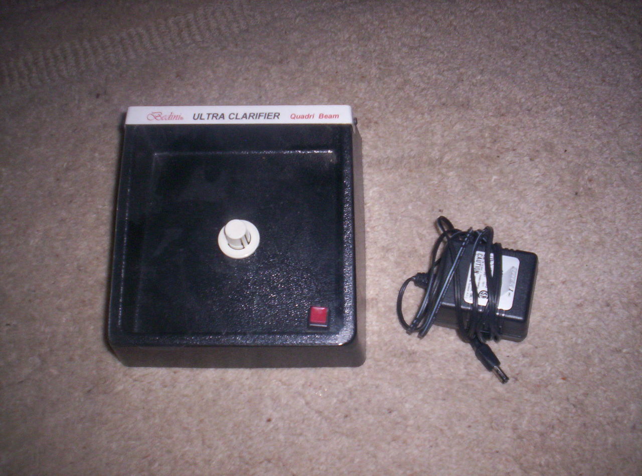

"The Bedini Ultra Clarifier is the ultimate amusement-park ride for your CDs" - claims Mr. Kevin Hunt.
Again another (a complete for me new) approach by same handling;
"Through its patented Electro Magnetic Beam Configuration, the Clarifier polarizes the polymer in such a way as to maximize the laser's ability to retrieve stored data."

Magnetic? Electric? They can't seem to make up their mind.
Data on their claims? Nonexistent.
Ripoff? Presumably.
Reviewers have even the slightest notion of what they're talking about? Nope.
Are they counting on the gullibility of their customers? Without question.
What's your interest here?
edit: I note that in the 1999 review you linked to, the reviewer promised to do blind tests. Did that ever happen?

Besides, this is now obsolete technology! See US Patent 6058078. This inventor, in describing the Bedini, says, "In the CD tone quality and image quality improving apparatus shown in FIG. 17, the hole in the central portion of a CD is mounted onto a protrusion on the central portion of the demagnetizer, a start switch is depressed to rotate the CD at a high speed of several tens of seconds within the entire magnetic field which consists of the strong magnetic field of a permanent magnet, plus the magnetic field of a coil. This type of apparatus is described in U.S. Pat. No. 5,487,057 (patented on Jan. 23, 1996) in detail. However, if a magnetized information recording disc is rotated at high speed, as in the prior art apparatus mentioned above, it functions as a kind of dynamo thereby shaking its surroundings and inducing an electromotive force to surrounding wires, the power supply, and causing jitters."
Do you really want a device shaking the surroundings and causing the jitters? I sure don't. Thank goodness someone has stepped in and fixed that severe problem!
