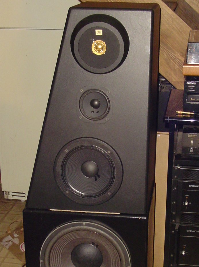

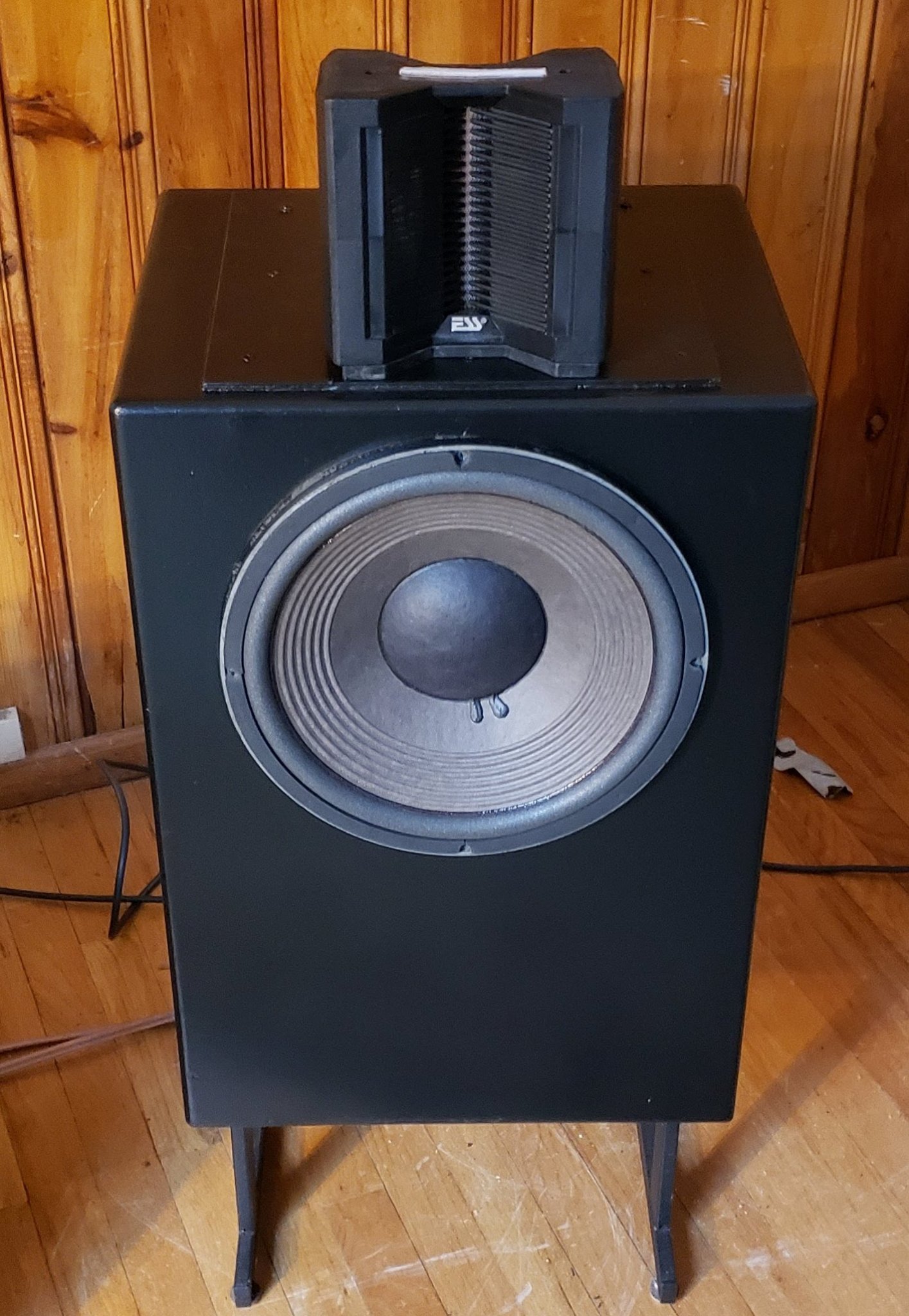

Depends on how you set them up. Are they optimized to be subs or woofers. I use a 12" bottom box that I have had 4 different tops on over time and plan to use them again I have crossed them over at 300Hz -800Hz depending on what the top was at the time. I have the driver close to the top of the cabinet and set the driver spacing with the upper baffle. I have done active and passive crossovers depending on the top. Last iteration I used them in a bi-amp set-up under Heil drivers. I have also had 3 way and a 4 way "head" so there no reason to do 2 way only.

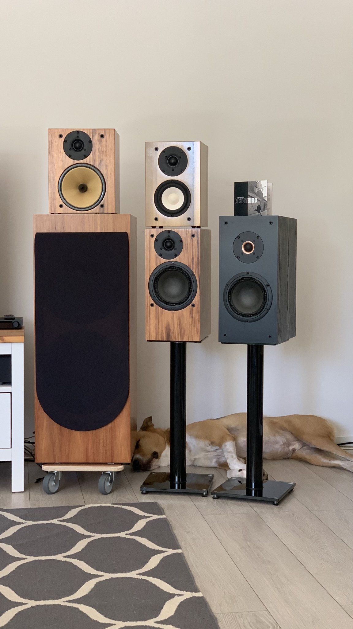

here’s my bass bins, loaded with twin 12” woofers. 2.83V sensitivity 93dB
Anechoic
F3 42Hz
F6 33Hz
F10 26Hz
in a living room it’s just slamming! (that’s an technical engineering term)
and that’s just one speaker playing!!
So now the problem is which midrange or tweeter do I want or need? Purifi ultra low distortion midrange or B&W high sensitivity very low distortion midrange?
And maybe my 35cm wide cabinets are too much. Maybe a pair of Purifi 8” woofers would be enough; in slim 24cm cabinets.
But most of the time the black Purifi 2 way is enough.
My favourite woofer is sleeping in the background.
It’s about rooms and meetings expectations.
Yes visuals shouldn’t matter but the science says they do!
