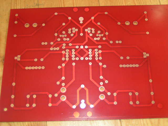

Henrik said:Hi Magura
It seems to me, that your fet pinlayout might be wrong.
Henrik
Hi Henrik
It also seems to me that my FET pinlayout is wrong 😉
Thanks again!!
Seems like I will have to make an ultra final layout🙄
Magura 🙂
Did you draw a schematic? Please post it if you did. It's a bit tough to follow your tracks😉
Steen🙂

A schematic??? What's that???? 😎
I have to admit that I am too lazy to make a schematic when 90% is a copy of Kristian's version. I have basicly added bypass caps, gain adjustment and converted the 680R power 10W power resistors into 4*2K7 3W metal film.

That explains the IRF parts, turning the wrong way😀I am too lazy to make a schematic
Well, the circuit looks good to me as it is, maybe Henrik can find something to pick on 😀 😀
Very good idea, those 10Watters are hard to come by.4*2K7 3W metal film.
Edit again, arent those 680r's supposed to be 750r's?
Steen😎

Nope, the explanation for that is unfortunately very simple. I simply remembered the pin layout being different, and felt no need to check the datasheet🙄

Hmmm, just studied yor layout a bit more!
The 0,22uF, is that a bypass for the output cap?`You saved a lot of space for that one! Wouldn't it be better to give room for one big MKP??
Steen.
Yep, that was the first time😀 😀

Yes the 0.22uF is bypass for the output cap. AFAIK there is little point in putting an output cap bigger than 10uF in this circuit, but if I should turn out to be wrong about that, there is room for at least 20uF MKP.
The 0.22uF film/foil cap simply need that much space, and I sure like to have a film/foil cap for bypass for the output cap.

I just finished etching the first PCB this evening, PCB's of that size are sure a PITA, it's like all the problems grows with the size of the board.
The board is about A4 size (200mm*300mm).
