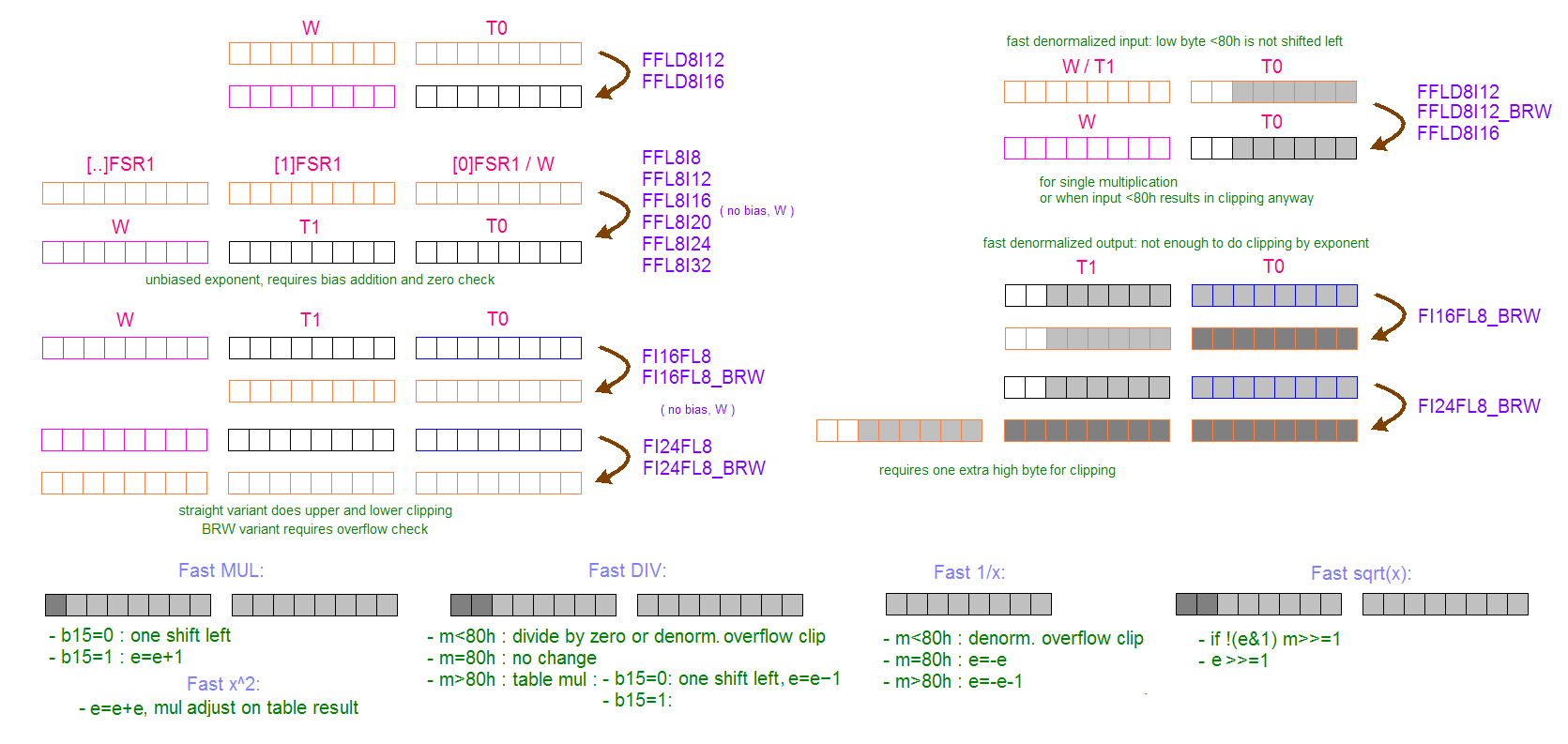

I wrote a custom SMPS floating point library for 8 bit PIC, 8 bit for exponent and 8 bit for mantissa, with an optimized call/parameter interface, that allows multiplications, divisions squaring and square root of voltages and currents in record times, also chained calculations with minimum overhead. You won't be able to do this in C, since first imposition is a fixed call/parameter interface.
In practice it means you will have to use a 16 or 32 bit MCU to get comparable processing power, but those don't have comparators, op-amps or PSMC, and the reason is chip construction and expected target applications. More complex MCUs use different fabrication process which is not so suitable for implementing CMOS op-amps and comparators in the same die. Company development teams are also lacking good analog brains in the more complex MCU families, for example in PIC32MX some of the analog functions (variable voltage references with DAC) were faulty by design, and not fixed until next family.
I know more than an instruction set, about 4. This is the point where the need for generalization/abstraction arises. I know digital computing by heart instead. First decision is choosing a suitable instruction set to minimize penalties for a certain application. For secondary side MCU I choose 32 bit because I knew there was going to be a lot of precision multiplications action, not due to the PSU which is a minimal task, but due to the other tasks involved, and MIPS is a highly rationalized standard.
btw: If you want to implement that AN1521 create a thread and start by studying the converter topology used and how to optimize it for min. losses and min. natural resource usage, and how to drive it (simulation model).
Attached picture shows call interface of mini-floating point conversions in the library I developed.

Hey thanks for this!, now I know what was keeping busy in 2016 😀
Your library structure looks similar to a q15 format, if I'm correct? this how we do brute force signal processing on a resource limited MCU.🙂

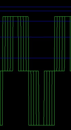

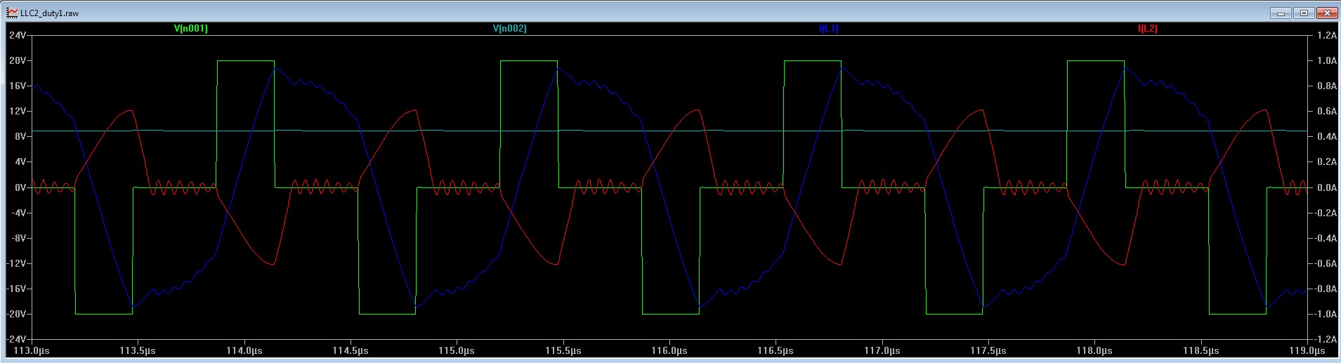

I have been playing with a mix of PWM and LLC as I like the low coupling of the LLC for noise reasons, but don't like the LLC for it's limited input voltage range. So I came up (and found later in litterature) with a 3 level drive. the idea was to sync it with a digital word clock to minimize interference, that's why i had only discrete pwm duties.( and do some post regulation later, for low power appplication. this could do pfc as well I guess.
below a sim showing the drive voltage. at duty=0.5 it is a standard LLC drive. you need a 3rd switch that can handle bidirectional voltages.

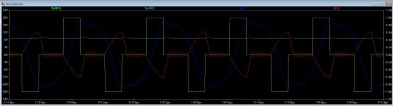

3 level is (at least) a 4 transistors and 2 diodes power stage, 2 transistors grounded to different fixed potentials, 2 transistors grounded to floating potentials. I already tried this for 230V to 120V quasi-sine inverter, being this mostly the field of application.
In SMPS there are undesirable losses during middle stage, transistor+diode are conducting close to peak current.
The single stage isolated PFC problem can only be solved by flyback, or a more complex mix of boost inductor and transformer-capacitor coupling for higher powers, in other words, non-linear converters and non-linear control.
The LLC was introduced due to lower EMI and the need to market new control ICs and power supply designs, not because it shines in any other field.
