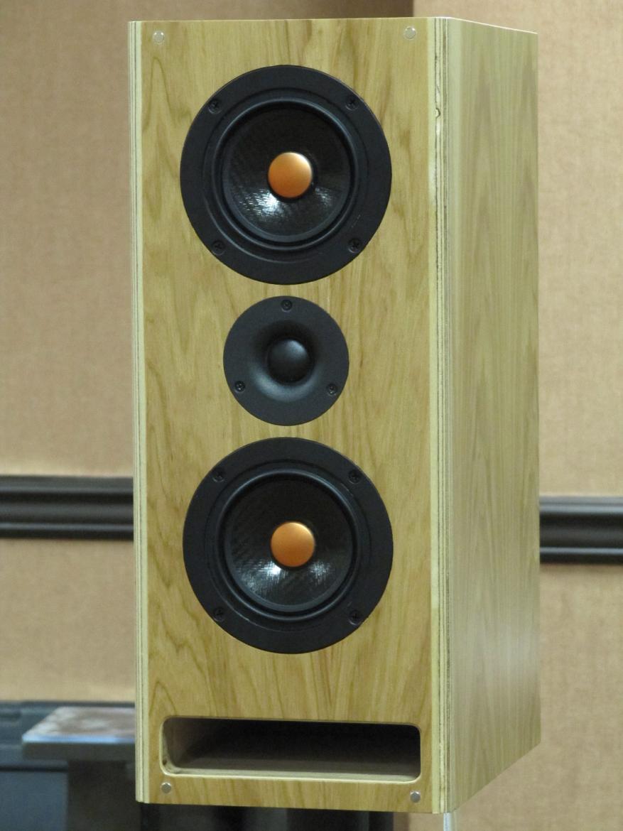

Triton MTM MLTL Stuffing Density Study
Attached is a study of the stuffing density impact on system response. Stuffing density levels of 0.25, 0.50, 0.75 and 1.0 pounds per cubic foot are analyzed. The recommended baseline level is 1.0 lbs/ft3.

I have a photo gallery on Picasa which shows some in process photos of the Triton MTM MLTL build. The link is:
https://picasaweb.google.com/108320796621723128031/TritonMTMMLTL#

Very much enjoying this thread, Jim. Your photos are excellent:
I reproduce a few images for the benefit of the sad souls who may be missing out on diyaudio membership here. 🙂
Jim Griffin's Triton MLTL conversion to a bigger box and more bass:
Jeff Bagby's original MTM Gem, in this case with rear port:
The Jeff Bagby crossover designed for the interesting CSS drivers:
The smaller MTM version frequency response:
