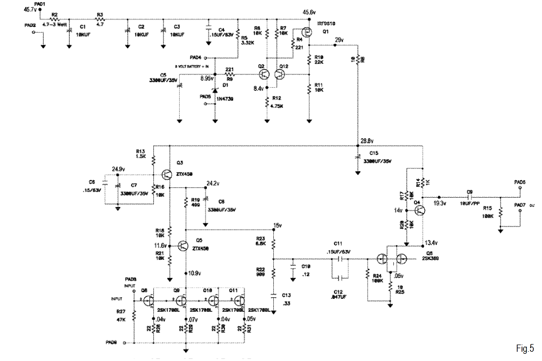

Hi there, Iam a proud owner of a secondhand Pearl one. When looking through the schematics of it there is an option to install a 9V battery between PAD 4 and 5, paralell to the diode 1N4739. What is the backround?

All that will do is put a 9volt source across the zener diode, (it already has one through R5). Nothing else.
6L6 Moderator Joined 2010 Paid Member 2024-10-10 7:06 pm #3 2024-10-10 7:06 pm #3 It was intended to be used as a voltage reference in lieu of the zener. C citationfan Member Joined 2013 2024-10-12 8:55 pm #4 2024-10-12 8:55 pm #4 Thank you very much guys for your answers! Now my Pearl dead shot 2SK389(Q6) on each channel... You must log in or register to reply here.
