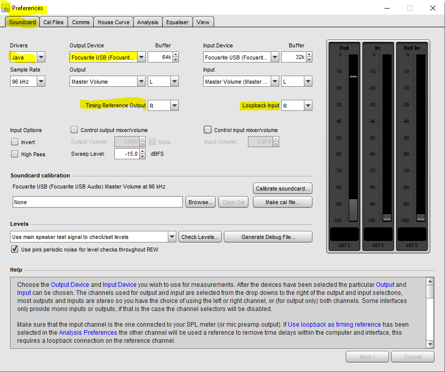

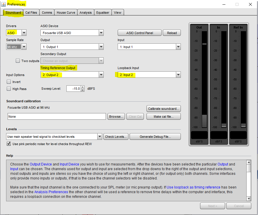

It'll all work properly once you master the basics in setting up REW's "Preferences" section.
- As mentioned earlier, you'll need to engage (ie; select ) a "Timing Reference Output" ( which is usually labelled R ( for right ouput ) when JAVA drivers are used .
- Outputs + Inputs are labelled differently when ( if ) ASIO drivers are chosen ( typically labelled numerically ).
See below;

I'm not going to turn my involvement here into a hand-holding session on navigating acoustic measurement software ( be it REW or ARTA ).
You don't seem to know your way around REW /// if that's true then I suggest you put your crossover design ambitions "On Pause" ( for the time being ) while you learn how to operate REW or ARTA .
- Once you've accomplished that ( basic REW competency ) return to this thread and we'll carry on.

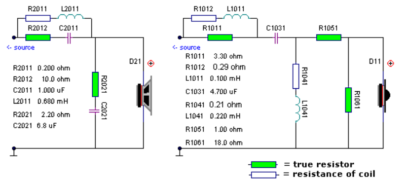

My idea would be to replace the monacor mid by Peerless 830875 and reuse part of the filter of the Nomex 164. Low pass for 830875 and high pass for 810921.See attachment. You will have to add LPAD for the 83075 and adapt the value of the existing LPAD for the 810921. The first order low pass for the mid which is the 65 mF cap on the original crossover could be a starting point.
IMHO designing and voicing a three way from scratch is a really difficult job wich need a lot of time for measurements and simulation.
PS : Peerless 8109210 and D2608/9130 are the same product.
