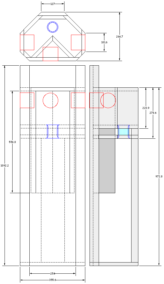

I am zeroing in on something for the readily available W3-879. I'm thinking of TL loading the Tangband using Rick Shultz's alphaTL methodology (can't tell you much about that until after it gets published in aXp -- but it is cool), XOing, at the bafflestep) to a pair of Adire AV3s i have kicking about -- they will be in a vented enclosure. With the box i'm planning -- this will be a box that should fit in the nonrectangular box thread -- i hope to get the XO in the 225-300 Hz range, and i'll try series XO 1st.
You may ask why XO a single 3 to twin 3s. The AV3s have 6x the xMax of the TB so the pr should move 12x the air.
The more exotic driver i am still throwing a lot of ideas around.
