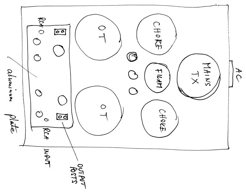

Looks a little busy, and heavy!
you can have anywhere from 4 boxes to 1 box.
idealy would be two monos with each their power inside but I don't think you have the iron for that. (2 boxes)
Your left with
two monos plus single external PS. 3 boxes! My vote.
1 stereo amp plus external PS.. 2 boxes.
That Piltron chassis is huge and means the rack/shelf required will have to fight against WAF. And besides, seeing your previous chassis creations I'm sure you can do better.
cheers
Paul
I would put the filament supply with the mono blocks that way you will have the ability to have power switches on the monos to turn on the filaments before turning on the B+ on your external power supply.
More steps for power on and power off but better tube life.
/Paba

Peter Daniel said:
I was planning to build PS and the amp in separate enclosures. Should I go with monos or one chassis for the amp section?
I would do an open plan signal chassis for the actual Amp (including the actual regulator should you keep it) and a big black box thing for the PSU, making sure to allow for long umbical cables. Make sure to place final PSU Bypasses on the Signal Chassis.

paba said:
Your left with
I always wondered if this was really the best approach. Your source will always have a single ground reference. Splitting the amp chassis creates the potential for a voltage difference between the the two amplifiers chassis, their common power supply and the pre. Isn't it better, assuming optimum internal layout to minimize crosstalk, to use a single chassis and tight ground reference between the left and right channels and externalize a common power supply.
Konnichiwa
Peter Daniel said:
paba [/i][B] Your left with two monos plus single external PS. 3 boxes! My vote. [/B][/QUOTE] That would be also my preferrence. Now said:
Originally posted by paba Your left with two monos plus single external PS. 3 boxes! My vote.
Exactly. The "common supply, mono signal chassis" is really the worst possible solution, unless the common supply shares only the Box, but the supplies are electrically seperate and NOT ground referenced.
I would vote the opposite as better, 2 Dual Mono Powersupplies with one Stereo Signal Chassis wired dual Mono....
Sayonara
Because of cost restrictions and preferable smaller size I have to share the main transformer and chokes between channels. I can go with separate regulators though.
I can also make dual channel boxes, but lets say with a possibility of tight ground reference between the left and right channels.

Konnichiwa,
That means you must share grounds and thus you must use one signal chassis with well arranged ground routing.
That might be an interesting choice but does not really help where the problems are.

Peter Daniel said:
So should I go with a single regulator or one per channel, considering one box for PS , one for the amp.
If the regulator does it's job any decently to start with separating it will not give any advantage, if it doesn't then split channels will not save it.

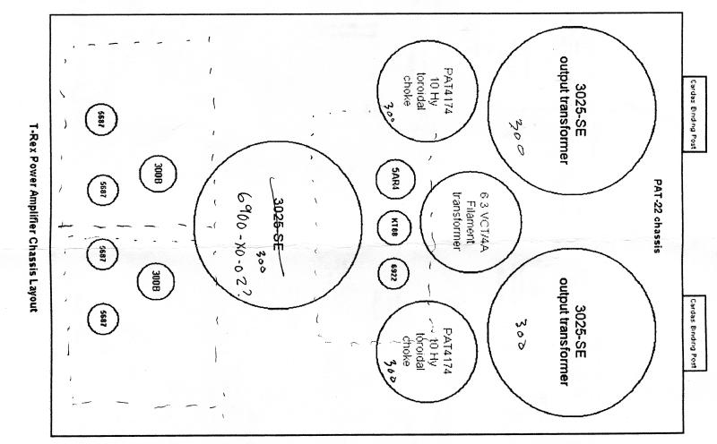

In a meantime, I did some thinking and came to conclusion to actualy use Plitron chassis for this version of the amp. I want to work fast to make the amp ready for New York Show.Two chokes and two power transformers, take the most of chassis estate, so why bother with an extra box just to contain those?
I will though make a special plate out of aluminum to hold the tubes and it will be easily removable from the rest of a chassis for modifications.
This layout was included with the parts. Is there anything that could be improved here?
