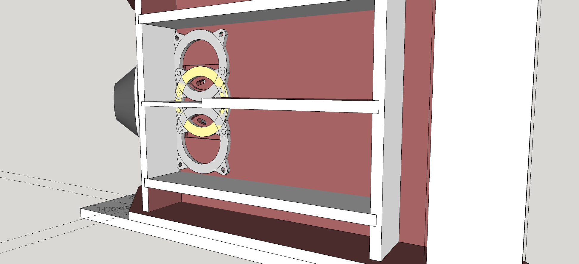

Here is graphic exported from the Sketchup of my Synergy corner horn design.
The grey shapes are the footprints of the mids as I built. The yellow footprint shows where I would put a single (4FE35) mid. As you can see, the single mid would allow the ports to be perhaps .5" closer to the apex, which would allow me to push the crossover up above 1.2 Khz, limited by the 1/4 lambda port spacing rule, from its current 950 Hz. The cost would be 6 db of headroom, limited by the Xmax of the mid, which plays down to 200 Hz. But I can hit 120 db at 200 Hz at Xmax so I can afford to give up those 6 db.

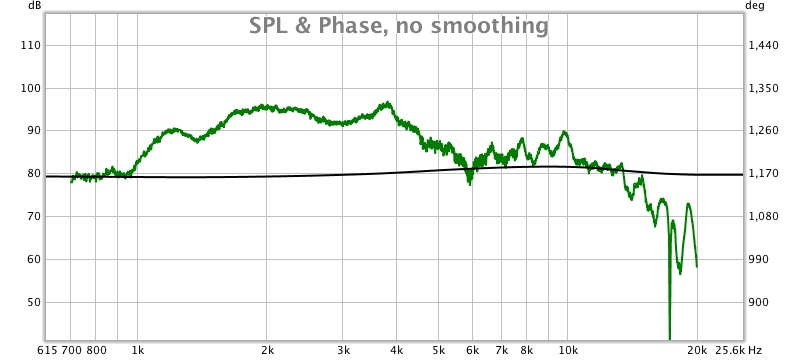

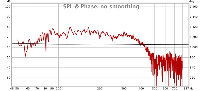

Ok so the monsoon rains stopped long enough for me to get outside and do some measurements over the weekend. Here are the 2m ground plane response charts.
Did the trick with a spare silk dome tweeter as reference impulse to do time alignment on the drivers. Realised last night that one of my woofers was wired incorrectly- so woofer chart is of a push pull config...😱
I can upload the MDAT files for the woofer/mid but the CD file is too large (even if I zip it...)
It appears as though my mids are lacking enough motor strength to get them to the CD xo point (1300hz). I've already added frustrums and reduced the cone volume but they are still struggling. Response worsened when I taped over one of the mid ports on each driver with roll off occurring earlier. Woofer sensitivity is probably messed up due to the incorrect wiring (I reduced the gain 3db on the DSP once it was fixed).

Mark,
Nice work! You are off to a good start - the measurements show pretty smooth responses on the woofer and mids. The CD needs attention to smoothing the transistion with sanding and putty. Every effort should be made for a smooth transition from the CD throat to the horn. You will see the ragged HF response disappear and smooth out as you file/sand/apply putty. Modeling clay is a good place to start to see immediate improvement.
My one concern is the lack of HF extension of the mid to adequately cross with the CD. That's the main problem with a lot of CD synergies is that the mid will fall well below 1kHz and CDs don't like to run below 1200Hz really unless you have one of the larger format ones. The problem is that the distance from the mid injection to the apex is physically limited. Try making the volume filler plug bigger to take up more room. But I don't see how you can cross the mid effectively as it falls at 800Hz.
You might be able to save it by changing to either a 2in format CD to allow tweeter extension down to 700Hz, or try a 2.5in full range driver as the tweeter a la xBush/Trynergy.

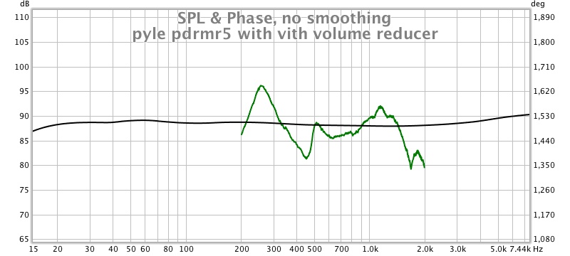

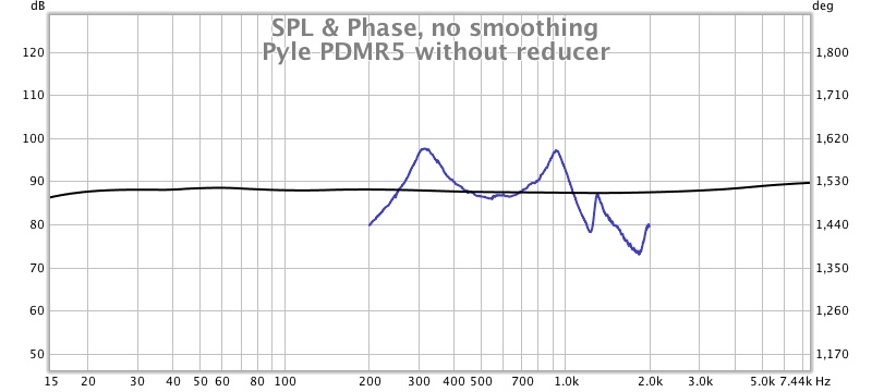

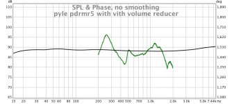

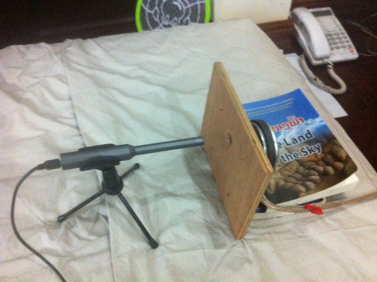

For todays viewing I have some REW screens of the Pyle mids. The purple chart is the driver simply mounted to a 12mm ply baffle firing through a 19mm port (no frustrum).

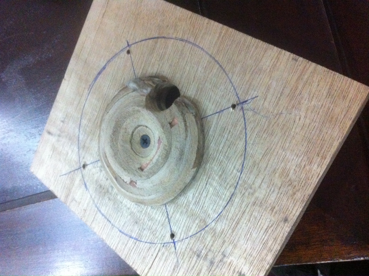

The green chart is of a fairly aggressive volume reducer (It took me a few hours on the belt sander to make it this afternoon- so i'd need to find a more efficient method if I was considering doing 7 more!). It does the trick of raising the passband to a solid 1.4Khz, but at the same time it introduces a few dips (450hz). The cone may be rubbing on the reducer and generating the dips. I can afford to take some more material off it to ensure that is not the case. Would making it out of plaster of paris work? I can imagine it being easy to work with sand paper and a file but would it be too brittle?

Do you know anyone in the dental business? You could duplicate the volume reducers to tolerances within a couple of thousandths of an inch using dental impression materials and dental plaster or stone. These materials are very durable as well.
Nice job on the volume plug.
I had a rubbing problem with mine that showed up as a sharp increase in distortion as volume crossed above a threshold.
Put some lipstick on the reducer where you think it might be rubbing and see if any transfers to the cone.

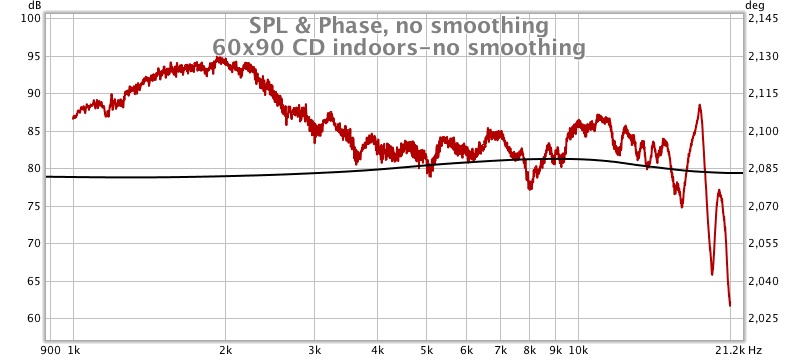

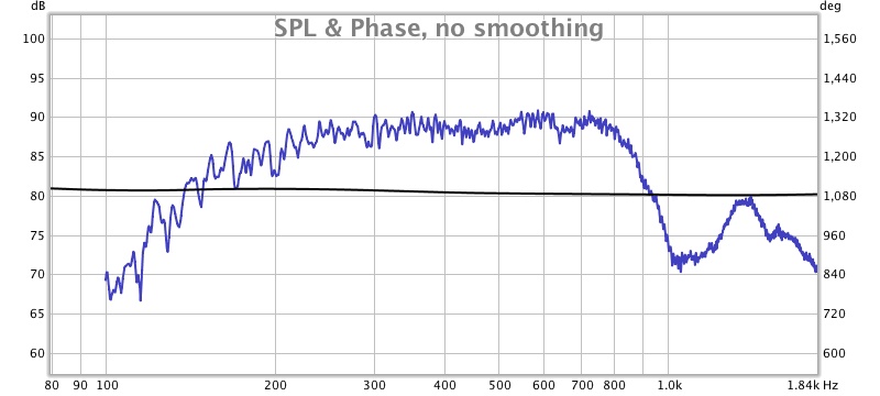

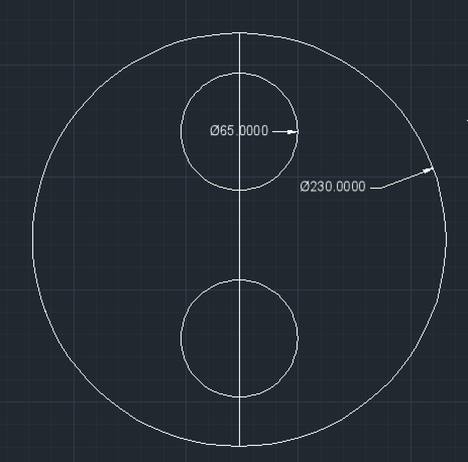

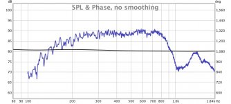

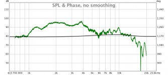

Ok so have a prototype 60x90 horn up and running to do FR tests and such.
Closest I could get the ports for the mids (line through center of the 19mm ports) corresponds to 1110Hz wavelength.
The CD response in the 60x90 horn is below- roll off is right at about 1100hz so that is promising.

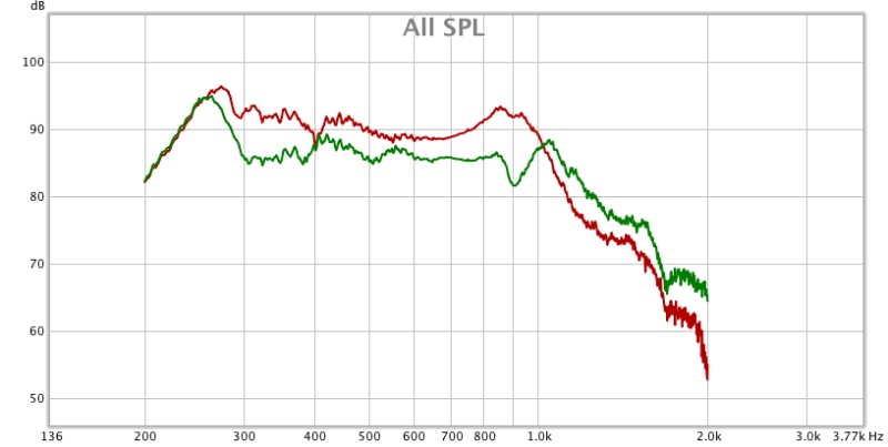

Also below is a comparison between a Mid with a volume reducer (green) and without (red) in the horn (not just on a baffle). 19mm ports are straight- no frustrums as of yet so hopefully that will smooth out some of the lumps.
The mids roll off at around 300 Hz which is perfect for me to hand off to to the Faital 10fe200. The 10" woofers will be mounted to a baffle with small stand off for the 6mm xmax. It will have the volume of the cone, plus the volume of a small chamber on the side of the horn to fire into, before travelling through 2 ports. This has to be done to keep the depth of the speaker to a minimum. I've seen pill shaped ports and regular circular ports used before. What size should I start at for a 10" ? 2x 32mm ports?
Any tips, concerns given the data so far?
Mark
A dip before the bandpass peak shows in a few of the hornresp simulations I have done, you might want to compare your real results again the sims to see how close you are. It is then easier to tweak the parameters in hornresp to see which will reduce that dip, or you can try the cut it and see method!
20% of Sd for port size to avoid chuffing is a good recommendation that would be 2 x 65mm ports for the 10FE200, it is also a good idea to allow more clearance than just xmax if you can (Xdam is 10.4mm), you can route a ring into the baffle board as well as use a spacer, routing into the baffle will help to reduce front volume slightly but that is less of an issue for 300Hz and below.

2x 65mm ports for each of the 10" woofers seem pretty large! The ports will be into the 60 degree face of the horn, If I was to do as you suggested there would be less than 65mm between each woofer ports on the left and right hand sides. I might go with the pill shaped ports so I can keep them closer to the corners of the horn. I might start small and just work my way up until I get a good result.
It's not really small for a 10" woofer, by making them smaller you increase the compression ratio, limit the maximum output and maybe increase distortion.
This is what two 65mm diameter ports looks like on a 230mm circle which looks to be about where the surround is. Maybe a picture of your horn would make it easier to see why they would be difficult to fit. The streched hotdog type ports can also be easier to fit, as long as the area is the same they will work the same.
