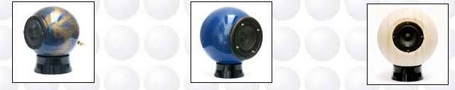

Anyways the basic idea was I streched pantyhose over a 6" foam sphere. I bought all supplies from Wal-Mart (Sphere in crafts section with fake plants, and pantyhose from ummm the woman section). Then stretch the pantyhose (get the big XL or queen size ones) over the sphere. I would wrap them back over twice, by twisting them at one end then folding them back over. Then apply resin. I did this about 6-7 times each....gonna need like 15 layers of pantyhose.
Lots of sanding, and a good amount of wood filler towards the end. I'll try to host a bigger picture later this morning.
Let me know if you have more questions.

Heres some of the pictures from the old website, from various angles.
