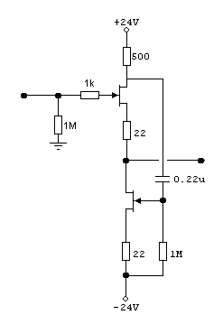

we should use an active stage to test. let's make a simple preamp. input shunt attenuator, gain or buffer stage of your choice. i like the Borbely buffer cuz it's got high input impedance (JFET), good ouput drive capability, is simple to build, requires a capacitor (so we can test those too), and sounds transparent. i have a supply already built for it, the black box can use a standard 3-pin XLR jack for power connection. but if someone else has a better suggestion please chime in.
Dorkus, I think you miss the point. It's not whether or or not you prefer the premium parts, it's whether or not you hear ANY difference.
The buffer is fine if you agree in advance that it is transparent and will not affect your ability to tell a filter made from grungy parts and wire (I might even use a coathanger!) from a filter made with your choice of premium parts and wire.

the buffer is a good circuit. it is not a filter, but it will have an output coupling cap, which is a LPF after all, and it also has a feedback cap of sorts (.22uF, value not critical). so we can test the performance of both electrolytics and films.
shall i start taking suggestions for what parts to use in the "cream of the crop" version?
below is a diagram of the circuit from the original thread (http://www.diyaudio.com/forums/showthread.php?threadid=2281). a couple resistors missing but otherwise correct.
i agree the first step is to see if i can even hear the difference at all. again, i think potting the switch should be sufficient. make sure you document beforehand which is which though. maybe we can use color-coded wires coming out of the potted block, and you hold the key to the color code. make sure it's six-9's copper with teflon insulation tho! j/k.

I have no problem with a buffer stage. Perhaps Nelson could suggest one, I would go along whith that. I seem to remember seeing somewhere that Nelson didn't think caps had much of a role in the sound of an amp, but I could be wrong.
As for a volume control we should stay with the KISS principal here. Unity gain or minimum loss so that the test box can be inserted into an existing system with out major change to system gain.
Does that seem reasonable?
