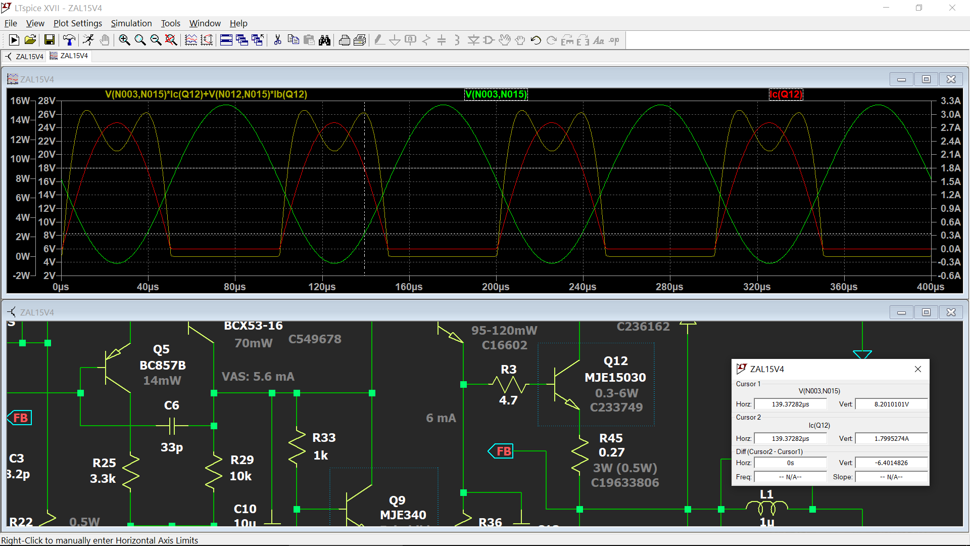

For the power output I thought about using MJE15030-31, which I used in my high-power amplifiers as drivers. I know they are not made for this, but do you think it will work for this little amp ? The transistors are rated for 8A and 50W. The peak output current in 4 ohms is 3A per transistor, and the average dissipated power per transistor si 6W max. Do you think they will hold ?
Another disadvantage would be that the gain is a bit nonlinear:
NPN hFE: 150 @0.7A / 100 @2A / 75 @3A
PNP hFE: 150 @0.7A / 120 @2A / 83 @3A
Will this matter much ?
I would be interested if you know of other more suitable output transistors, but only in the TO-220 package.
For better hFE linearity use D44H8/D45H8. They are not only flat past 3A, but they maintain full gain to 2 volts. Tailor made for low voltage supplies, when losing a miserable volt or not is a big deal. They have serious second breakdown issues at higher supply voltage, and above +/-18V or so the MJEs should be used. I think they are still available in DPAK, if you wanted to surface mount them too. Real world dissipation with music would be low enough (about half the 6 watt maximum). Can be driven with 2N3904/6 at these voltages too, so there would be a lot of SMD driver choices.
Use the H8 versions, not the H10 or VH versions, so that the gain will tend toward the higher bins. Unnecessary voltage or power handling always comes with a price.

It’s the D44/45’s that have a second breakdown problem at high voltages. Power handling falls off rapidly above 12 volts. There is a temptation to use the D44’s up at +/-25 or 30V, but but experience shows that they blow up. MJE1503x will actually stand up to it. On +/-18, either runs fine, but the D44’s will let you eke out a half watt more power because they are better in saturation.
The D44’s are actually easier on the drivers, because of that saturation behavior. When you go to turn them on all the way, a 200 mA transistor can supply the needed base current. Any reasonable choice of driver transistor works. I’ve used TO-92 2N3904/6. But if going SMD, I’d opt for a SOT323 over a 23.
MJD340 isn’t a good driver or output transistor here. Being a 300 volt transistor, something’s gotta give. Beta falls rapidly above 10V. So over half of your normal operating range, it’s not going to be very linear. On a 200 (or even 70) volt supply, sub-10-volt behavior doesn’t bother you as much. 10 MHz fT is the least of your worries.
So, after all, my output stage, with BCP56/53 and MJE15030/31 it's ok ?
From my simulations, the biggest V*I product (power dissipation) is at 8V and 1.8A.
For D44's, the DC SOA at 8V is 5A ! And for MJE15's 8A. They both should hold at +/-16V.

Sure, that driver/output will work. Real world with a speaker load it will hit 1.8A at 16V (30 degrees reactive). You’re plenty safe at low voltages and you can see that as you raise the voltages, the D44 runs out of room sooner. Low voltage behavior is a little better - like when driving 2 ohms on a 12 volt supply. Start pushing 5 or 6 amps peak and that’s when you really see the limitations of 1503x at low volts. Even with 3.6A peak, you will probably be able to push a couple tenths of a volt more output swing with the D44’s. I guess the question is whether you want them badly enough to put together a Mouser order.
How can I simulate someting like a real speaker, 30 degrees reactive, in LTSpice ?
For a single frequency analysis (for power dissipation, etc), make the R+jX (or R-jX) with a resistor and inductor (or capacitor). Set the R and L values to get the phase angle you want. To gauge what a speaker’s impedance curve does to frequency response, stability, or distortion you need a model for it. There is probably a way to import a .ZMA file and use it for the model. I know how to do it in the simulators I usually use (they are not free Spice derivatives, so procedures are different but the idea is the same).
30 degrees is often considered a practical worst case. Woofers will often hit as much as 60 or even 70 degrees at maximum phase deviation but the magnitude is always still high just on either side of resonance. When it gets down to about 30 degrees, the impedance is near the minimum, often only a few tenths of an ohm above that minimum. It usually happens in the upper bass/lower midrange where most of the power is.
