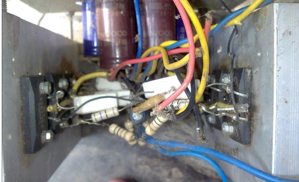

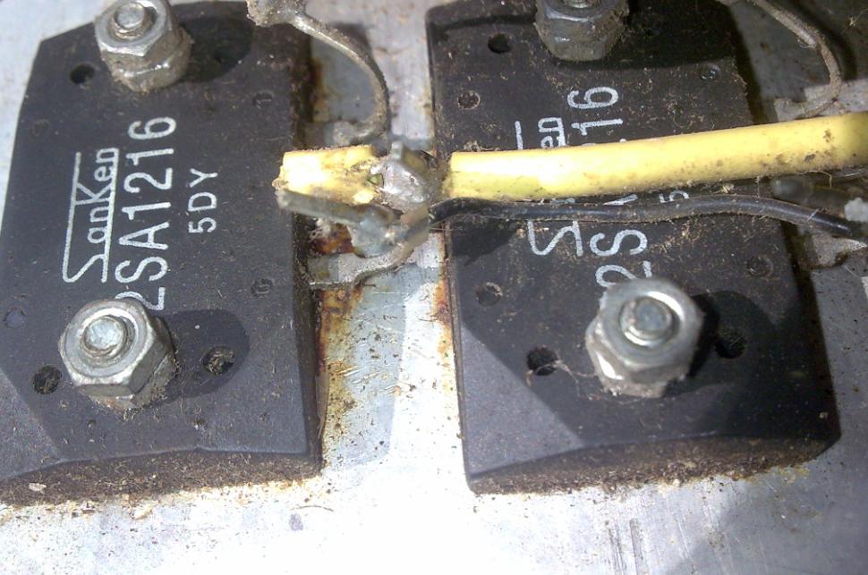

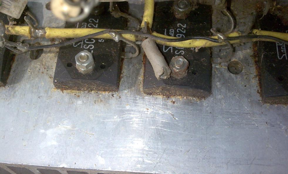

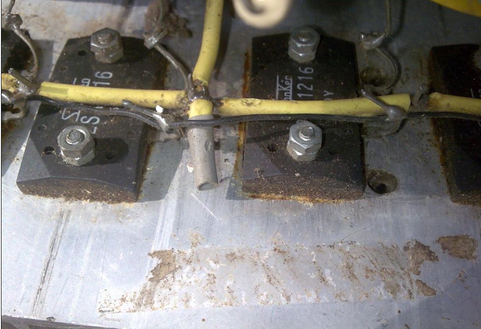

I remember in the past when I just place 2pair 2922/1216 original and 2pair fakes, all 4pair with 0.5ohm Re. The sound is better than all original version. The amp is now blow up at driver stages during thermal cycle. Many of my friend also ask me to restore it or built another but I just not.
Funny fakes sanken, the seller says it is the best transistor he has, only two pair left, Rp 40000/pair while original only around Rp30000/pair .

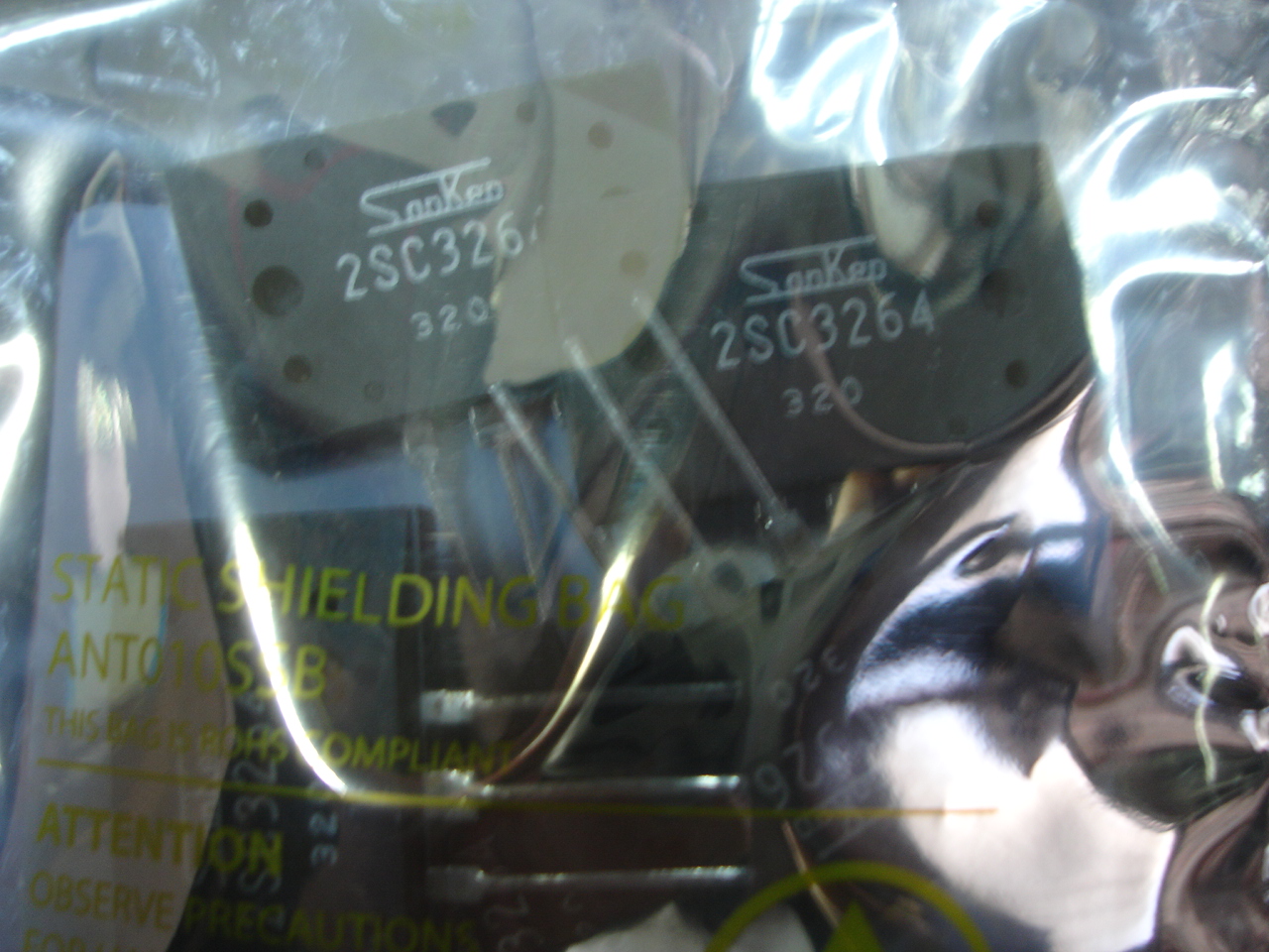

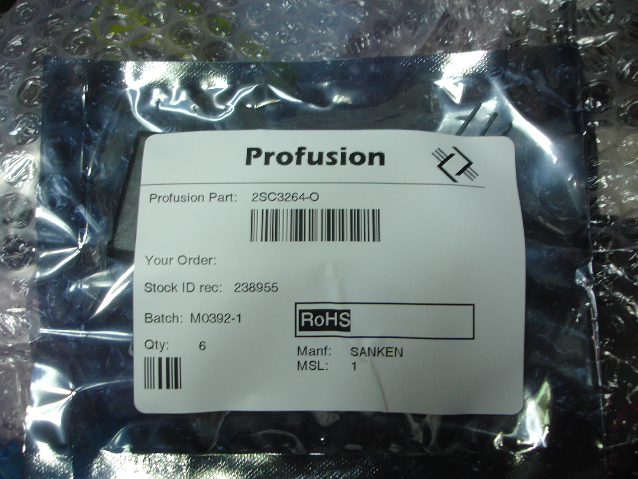

I has bought from here.Profusion plc, Audio Semiconductors and Components - Splash ScreenHi Jacco,

I hope that these are original.
Thanks for the link! Is Profusion a UK company? They got 2SC2922 / 2SA1216 in stock ...and I thought this pair was obsolete and out of production line?

I bought these a month ago.
It seems that Sanken puts these in production again
The shipment from Profusion looks professionel just like packages from RS or Farnell. Nice to know.
