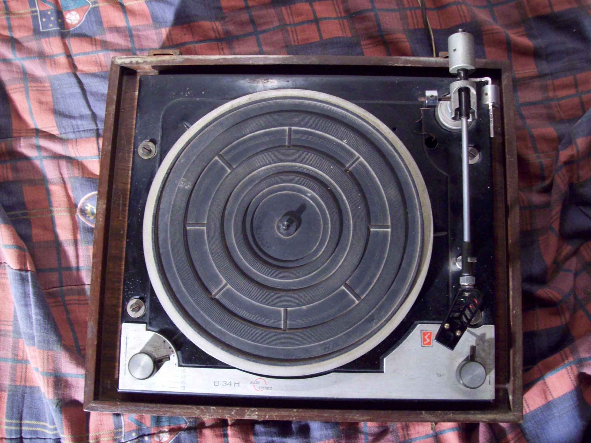

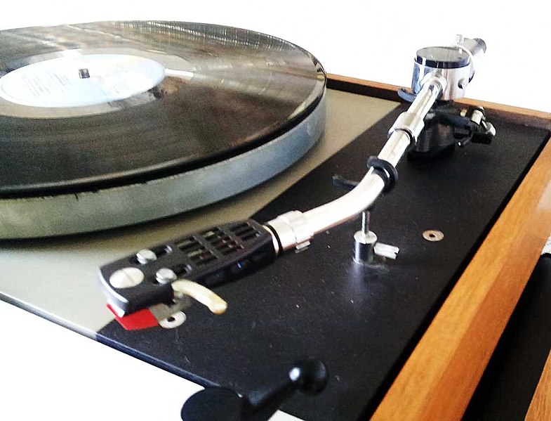

It was highly recommended by DJs in the 70's for its strength,fortress . Pulley traction. There was a little problem that can be seen in the design of the tonearm. Let's see if they discover it, there are no prizes for first place (whoever gets it right first), just the satisfaction of being recognized as an "expert" in TT. 😊

There was a little problem that can be seen in the design of the tonearm. Let's see if they discover it...

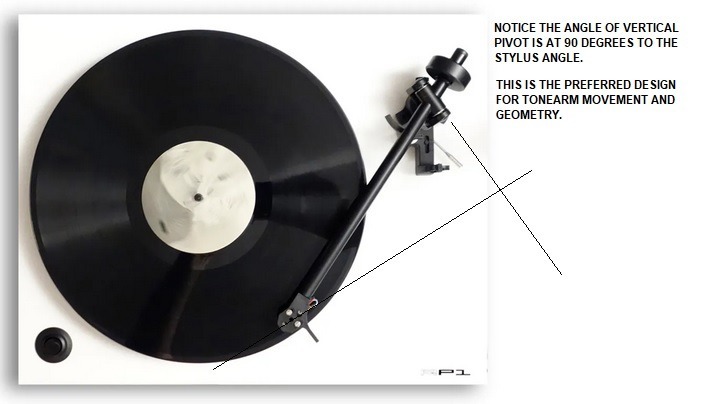

Does the arm not have the appropriate vertical pivot angle?
I would have chosen another photo of a TT to attach to the article !
So, are we talking about an inherent design fault or has someone tampered with the particular turntable shown in the image?
Yes, we are talking about an inherent design flaw (also unforgivable) .......So, are we talking about an inherent design fault or has someone tampered with the particular turntable shown in the image?
So, you're looking for something else other than vertical pivot angle and I don't win the non-prize?? 💰
Hi wiseold!
I've got you to thank for the vertical pivot angle image! 😎
Are you referring to the adjustable outrider weight on the right hand side of the tonearm?

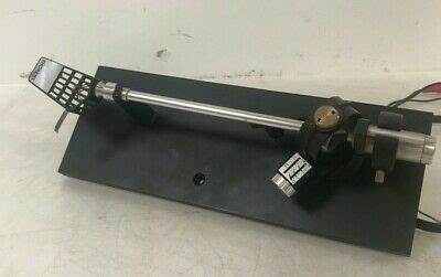

SME have used a similar arrangement (see attachment).

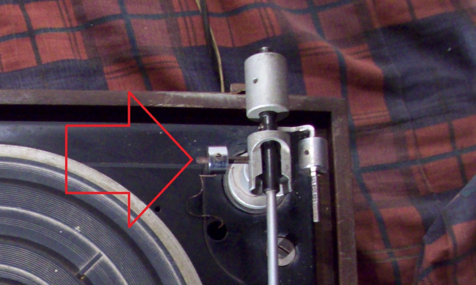

It's that stubby weight jutting out at right angles on the left hand side of the Sincron arm that is puzzling me. An anti-skating arrangement I'm not familiar with?

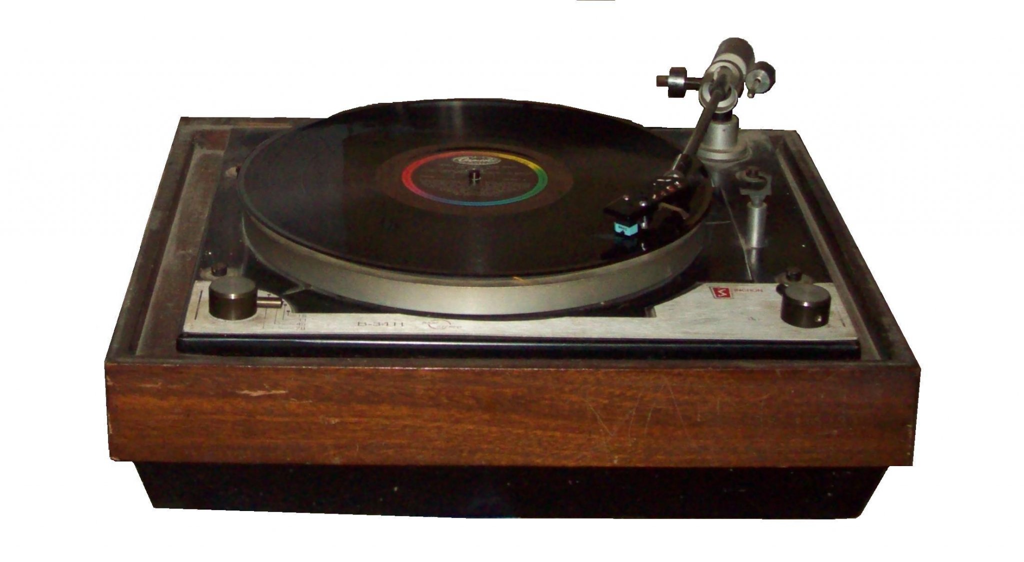

It's got a goofy stylus pressure adjustment - poor design.

The TT had terrible feedback, impossible to use in small rooms, that's why I sold it, (I was a teenager and the dimensions of my bedroom were normal, about 3 x 4 meters) but the main design problem is not that, because it could be used well in large environments. (Club's, dance halls, etc). Simply the fault was not something perceptible that bothered a DJ's or those present in the auditorium ......
The creator of the Sincron was an electromechanical engineer, without deep knowledge about the requirements that a TT arm has to meet.
He simply looked and copied, a little here, a little there, and that monstrosity came out. Yes, it's hard to believe, he sold thousands, that is, he wasn't the only one without minimum knowledge, buyers also fell into the trap, and I began to get confused and fell into it when it was time to calibrate the tone arm.... I seem to remember that the simple manual (brochure) of instructions only said what each piece was for....
Look carefully at the straight arm that this gentleman decided to create and manufacture and assume that you are the designers.
What regulation systems should a straight and cardanic movement arm have for optimal performance?
1 - Weight regulation for balancing
two . Vertical force regulation (VTA)
2 - Regulation of the anti-slip force
3 - Side Balance Compensation (S-arms only)

That's right, make an effort to study the photos, I don't want to give the award to YOUR friend.....So, you're looking for something else other than vertical pivot angle and I don't win the non-prize?? 💰![]()
Good ! The false AS does not work! You are the winner ! 👍🙂It's that stubby weight jutting out at right angles on the left hand side of the Sincron arm that is puzzling me. An anti-skating arrangement I'm not familiar with?
The genius who created this design mistook a lateral balance weight for S-arms with the anti-skate system.
In fact, put it in any position after the static balanced, the arm doesn't even move ...........😳
In other words, an arm without an anti-skating system, but who cares?
Not the DJs, surely.

I anticipate those who want to introduce elements of discord in this thread and argue that the aforementioned weight is to compensate for the weight that regulates the VTA, and thus avoid uneven wear of the tonearm supports in the left and right sector.-

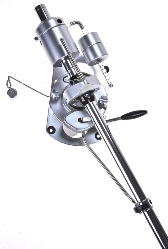

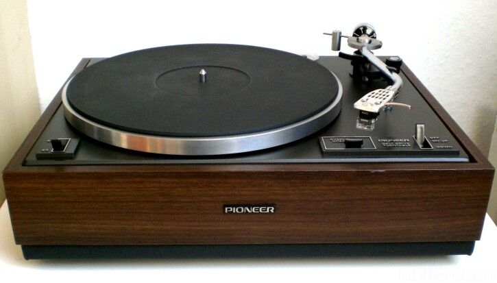

The Pioneer PL-12D S-shaped tonearm famously had a lateral balance weight (see attachment).
Many users removed it, following the (dubious?) advice of others. Then, when they wanted to replace it, they found they had lost it! 😆

There is nothing doubtful. I don't remember seeing S-tonearms without the counterweight on the left to compensate for the mass on the right (draw a straight line from the pivot to the needle contact point and it's easy to understand)The Pioneer PL-12D S-shaped tonearm famously had a lateral balance weight (see attachment).
I used the word "dubious" with its meaning of "not to be relied upon" or "of questionable value" with regard to advice to remove the lateral balance weight.

The lateral balance weight arrangement is there for good reason. I'm not arguing otherwise. I fear my meaning has been lost in translation. 😀
Some so-called 'experts' claimed the lateral balance system of the PL-12D produced unwanted resonances which were detrimental to the reproduction. This persuaded some owners to remove the system. Obviously, I wouldn't be so easily persuaded! 😉
