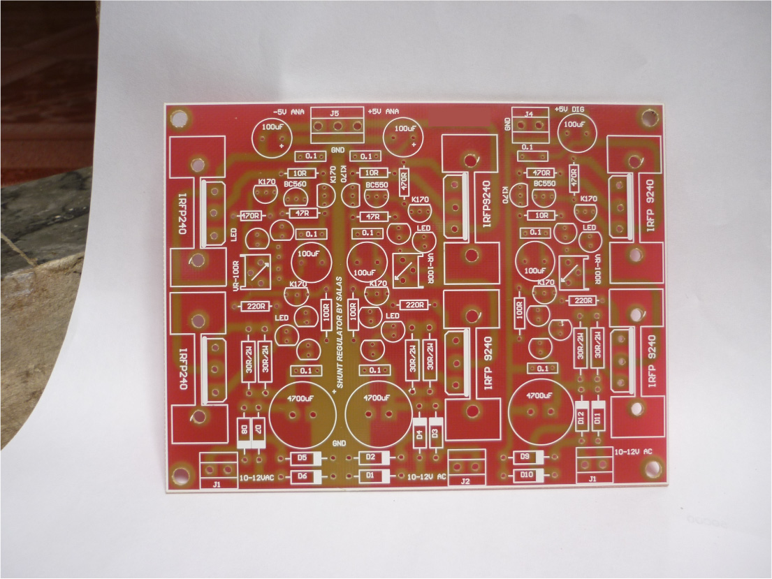

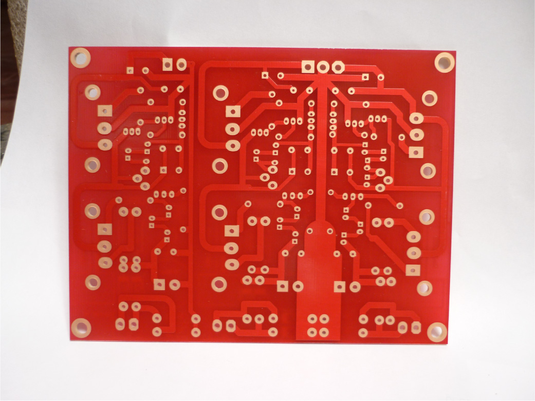

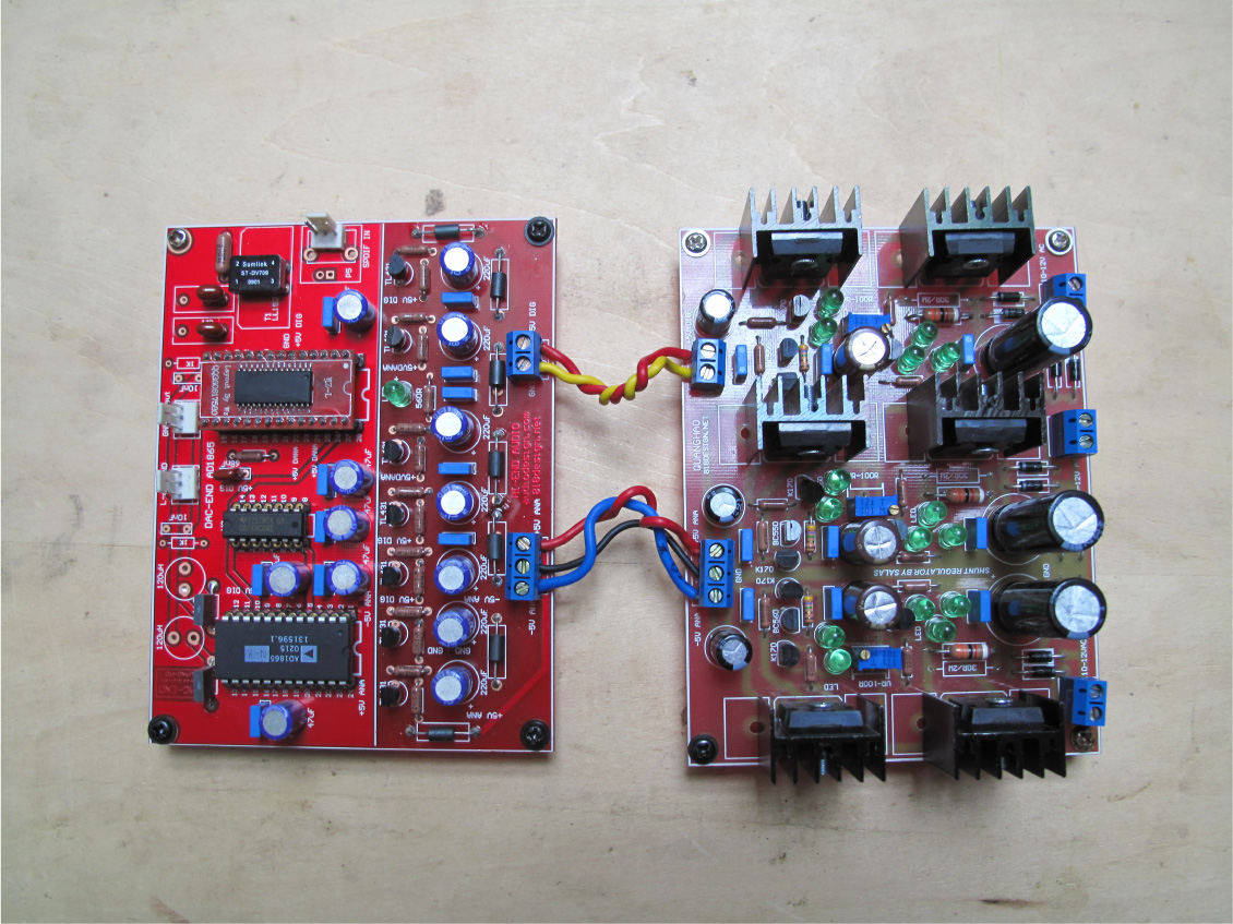

The Salas low shunt is very wonderful. I use for DAC , It is ver good!
you can see in board
! thank Salas!

Quanghao, how can you produce professional looking pcbs quicker than we can even think about? 😀
Do you work in a pcb factory? Can we send you some drawings and have them produced as samples?
It goes without saying we pay for them and cover shipping costs
No! Im design, I'm just a diy, I do Board for me and for my friend use.
Ok! I can help you!
if you sent me you file, I think, It is standard after a week production is completed.
You can sent for me by e-mail: mythuat818 @ gmail . com Or
quanghao168 @ yahoo . com . vn
Thank
Salas
