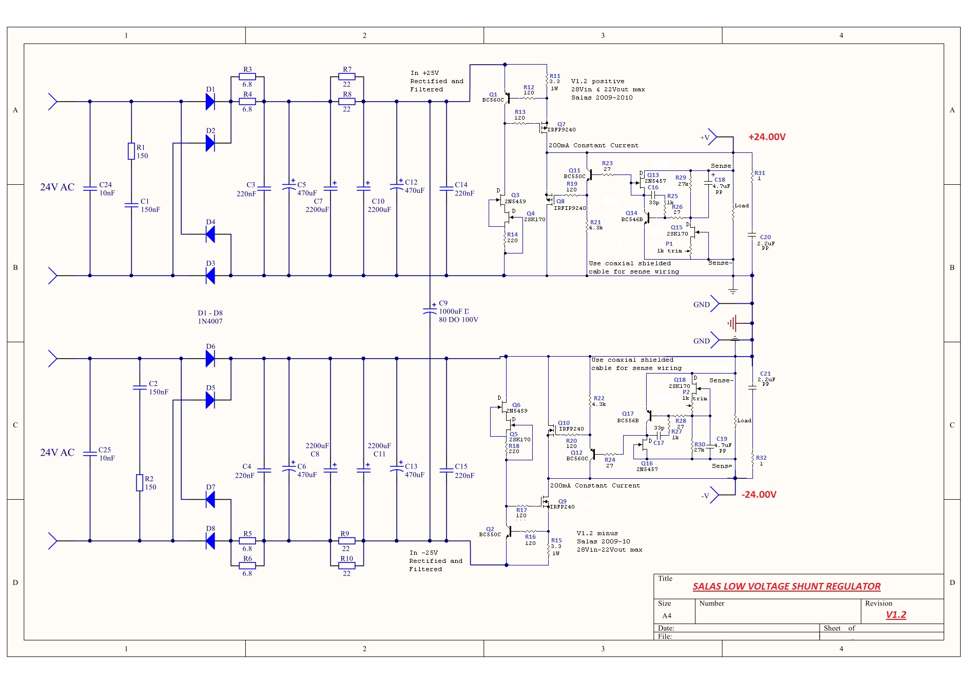

I need to build this excellent shunt regulator V1.2 and here is the schematic that i connect together in paint so if someone can check if i connect right all before i do PCB Layout?
And need advice:
1. Input is 24VAC which gives around +/-34VDC before rectifiers and filter capacitors with resistora...i need to get output +/-24VDC (200mA).
So what i need to change in schematic to get desired output voltage and current?
2. Can i change BC550C/BC560C with 2SA970/2SC2240 to get better output impendance and noise? (I have both at home)
3. Can i add on SK104-25,4 heatsink both MOSFET so i need then on heatsink and smaller PCB or do i need to put separate each MOSFET on each heatsink?
4. My BJT Preamplifier draws 30mA so i guess it is ok to lower the input current from 200mA to 100mA to get same charactersistics like simulated in LTSpice or i need to leave it 200mA? 6,8R is then for R11 & R15 needed to get 100mA current? 0,66 / 6,8R = 97mA
And here is the schematic that i added snubler for toroid on start limit, bridge rectifier and RCRC filter to get @100Hz -75dB PSSR (if i don't use RCRC only large C i get PSSR -57dB so i use RCRC because it is excellent filtering device)

You can't go >28V Vin because Q3 & Q6 won't take it. If you got other low noise type with >30V VDS max and VGS (OFF) >1.5V you could.
The BC transistors are working in practical layout with enough phase margin in there, for other types you would only know after you have tried them.
You should insulate the Mosfets.
100mA is OK.
100mA is OK.

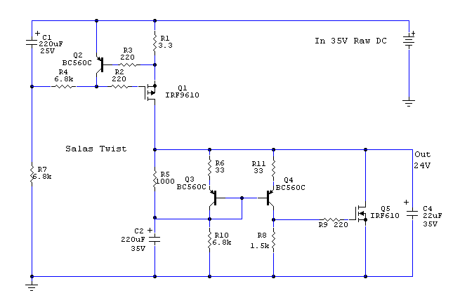

Im planing to use a Salas Shunt for a Juma BF862 Preamp tha Salas publisged in post #84
I think this is a kind of simplistic Salas low voltage shunt regulator so i hope im doing right here.
It will be my first Salas Shunt so there are a few questions i hope to get anwered here.
1. How much dissipation will there be from Q1 an Q5. I plan to use this one from Fisher. OK?
2. What kind of Resistor should be used in order of Watt especially for R1?
3. Is there an option to regulate the voltage outcome (in/decrease R10, R8?)?
4. Did I forget something that i should attent?
Regards Christoph
Regards Christoph
1. It will be what current they run times what voltage they have across them. The input mosfet will dissipate for the full set current limit (circa 200mA) times the voltage drop from raw dc to regulated output. The output mosfet will dissipate the set limit minus the load's current draw times the output voltage. Calculate the above and use large sinks enough not to go above 60C however they gonna be installed i.e. will it be free air, ventilated box, fully closed box, forced air cooling.
2. 0.5-1W
3. Make R10 a 10k trimmer (rheostat mode)
4. No. If you want to change the CCS current the formula is VbeQ2/R1.
