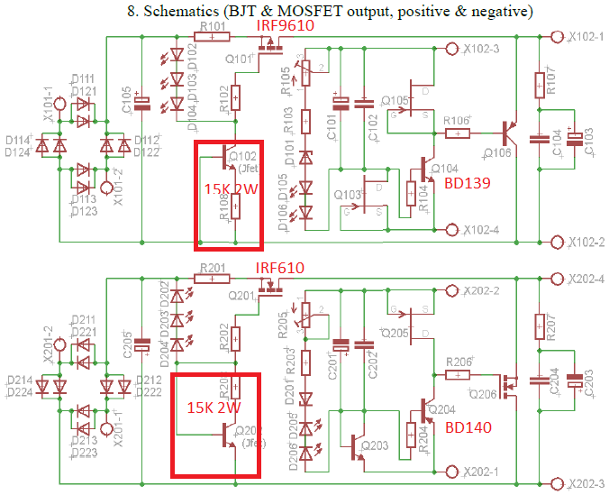

Does anyone know if SSLV BiBs have been used for powering a BoZoS, +/-60 V @ 80 mA? Can it be done, is it recommendable?

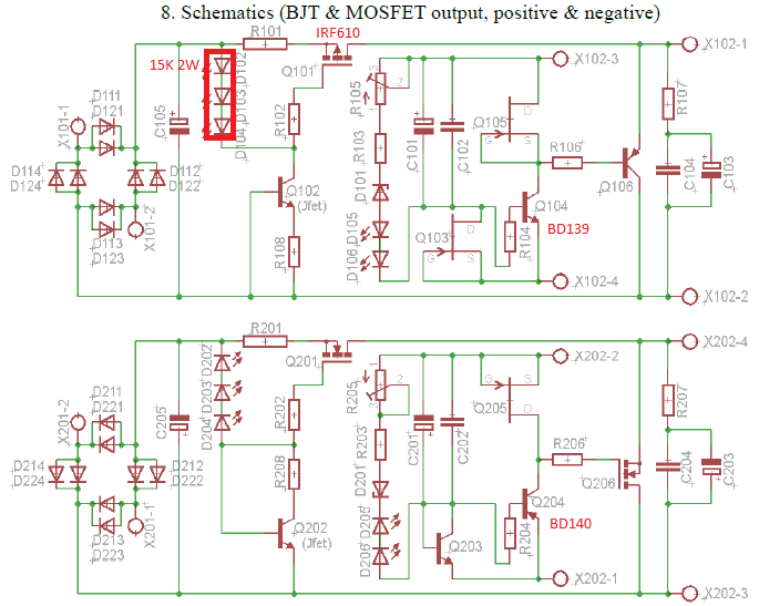

They can do it when exchanging the JFET tail of the 3-4 LEDS with a 15K 2W resistor and the BC550/560 error amp BJTs with BD139/140 or better. I.e. lower Cob, higher hfe, higher Early voltage. If adequate VCEO TO-92 like BC546/556 is preferred, some dissipation aid should be provided for long term reliability. That's the technical part to meet the output voltage and dissipation spec you seek.
Thanks Salas. What base schematic are you refering to. This?

You asked for BiB. That is the pet name for SSLV1.1. There is full instructions pdf in its "builds and fairy tales" thread.
Not the LEDS, their CCS change to 15K (delete Q102/108 R108/208, put the 15K from R102/202 node to gnd).
Q104/204 are the BJTs to upgrade for higher Vceo and dissipation. Correct.
*You noted 610 wrongly, its 9610 on the positive side and 610 on the negative. Its clear in the guide's BOM.

Yes, its good now. R103/203 should be 18K 1W, the trimmers 5K for 60Vout.
Your electrolytics should be 80V and you will need 70V raw DC level.

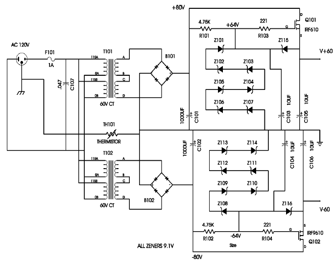

It will be bit worse in performance than lower voltage standard 1.1 but better than the Zeners and series pass element one.

Q106 is a PMOSFET IRF9530, don't mind the BJT symbol. Q206 is IRF530. Use about 3.5mA IDSS for the K1117GRs.
Thanks. If I would go for 65-67 VDC in and 55-57 Vout, since dual 24 V trafos is kinda more common then dual 25-26, what do I adjust?
Edit: I meen am I ok w above components and just adjust trimmer?
It must be substituted altogether by it because of its VDS max and dissipation limitations at Stajo spec voltage level. I.e. all he shows red boxed in post 6107 gets deleted and replaced by 15K 2W.
