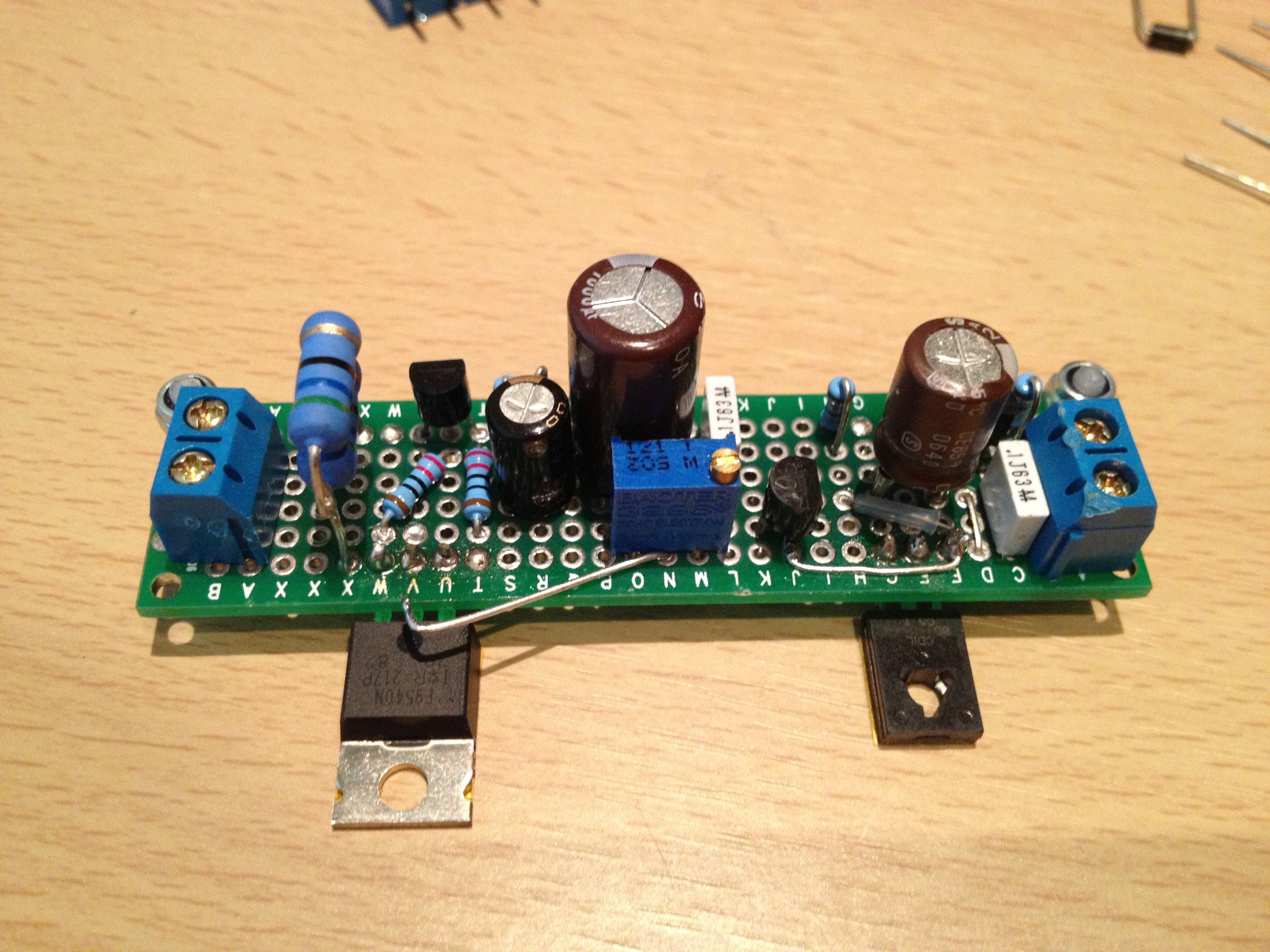

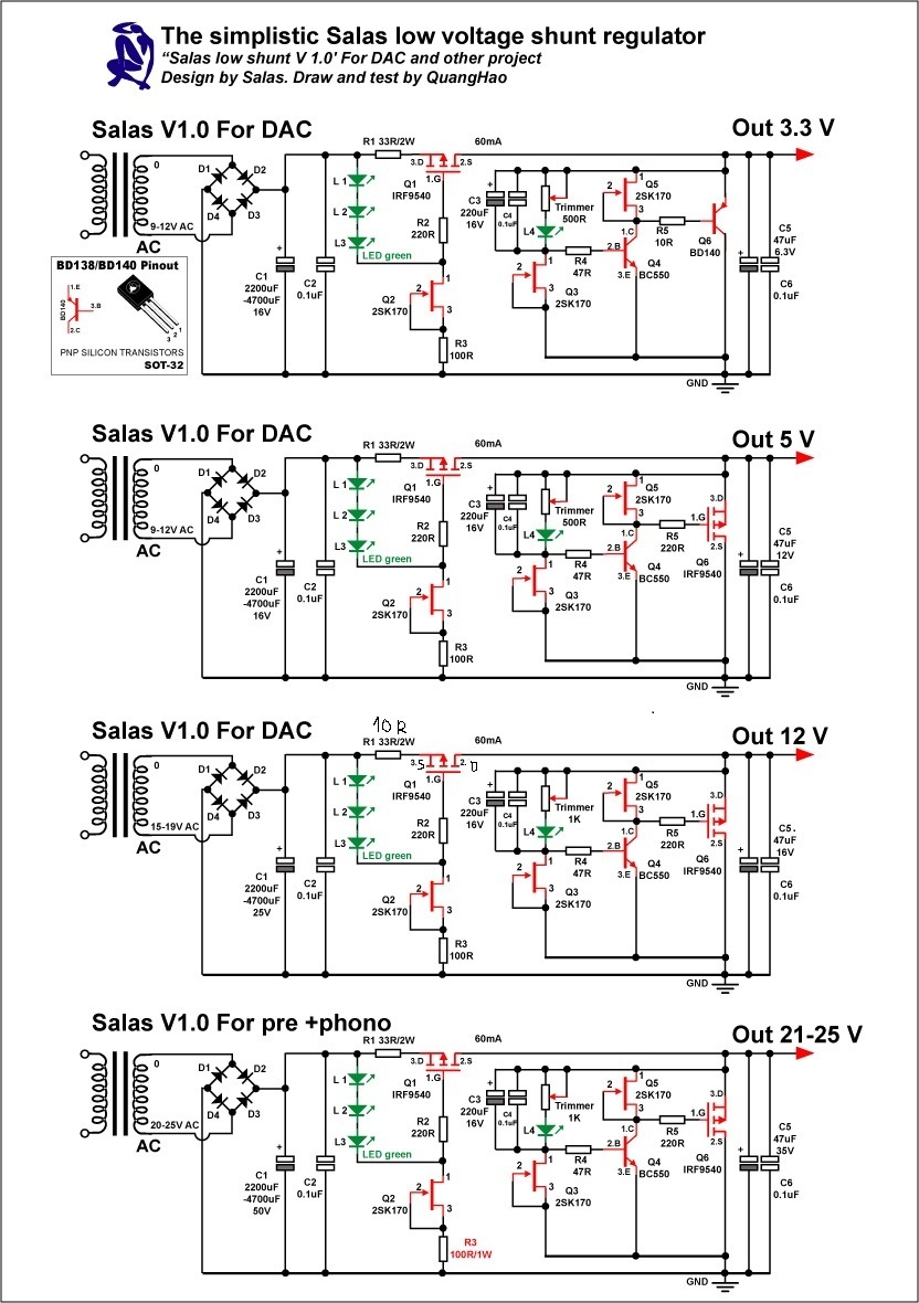

could anyone please confirm that this circuit (att) is correct? It is needed as PS for Red Baron TDA1541 dac. Other circuits work fine (+5V; -5V).
I get zero voltage on the drain after 1st mosfet, does it mean that there is a problem with bc560 (it doesn't look as shorted when tested with dmm).
Would appreciate any help!
Those were working specimens as far as I can remember. Maybe you forgot to do the green lines linking in that one?
P.S. Its a BC550 not 560.
you mean Q2? will try then!
and I put no leds as on the initial pic.
No, I mean Q4. Each BJT showing about 0.6V Vbe in circuit and each Mosfet showing 3-4V Vgs in circuit, works.

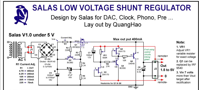

Just have checked the reg and it's so as you've stated for Q1 and bc560. Q6 doesnt get any voltage at all. If I measure q1 drain and ground I get zero and on same working reg (but with leds, 2nd circuit) it shows about 5vdc.
I've already replaced q1, triple check the circuit. Damn thing getting me really frustrated😡 Worst scenario I'll replace it with leds if run out of patience...
BD140 has reverse pin order to the one designated on the schematic.
I thought it's (Bd140) a direct replacement to D45H, isn't it?!
If I disconnect the drain of Q1, I still get zero on it. Seems to me the problem is in the left part of the circuit.
I've attached the reg itself and another circuit with bd140 I found some years ago in this thread 🙂
Many thanks for your help, Salas!
