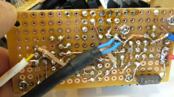

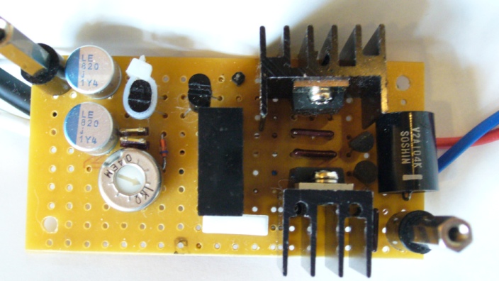

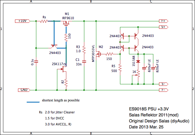

Hi, Reflektor lovers.
For last three months, I have tried to optimize the Reflektor, and found some useful knowledge.
1) M2
I guess that lesser the Cxxx of M2, better becomes the sound.
For this reason I replaced STP55NF06L with MTP3055VL.
2) R5
R5 acts important factor. This determines the current of Wilson Current Mirror. And M2 is driven by this. After some tests, 500R is preferred.
I realized 500R by paralleling two 1K VARs.
3) Zobel
As for C1, we must take into account two factors, that is, value and quality. When either factor was missed, I didn't satisfy.
As a result of a lot of testing, I adopt 33nF capacitor made of mica.
Outcome is very remarkable.
IMO there is no peak, no valley no noise but is open, smooth, and clear field.
I am noticed that my previous Reflektor had some weak points comparing to new one.
There is only real music playing soulful. I am satisfied very much.
It may be strange, I feel the volume has become larger than before, approximately 3dB or more.
Again I would like to say that Reflektor is excellent. 🙂

Hi Kazuo-san,
Thanks for sharing this. I've noticed you got 2 820uf Nichicon LE polymer caps on Vref. Have you tried others? (Polymer caps usually have high leakage current which result in more noise on Vref) For the zobel, I got good result with C0G/NP0 ceramic, but I like your idea of silver mica. I guess HF is important for digital power here.

I replaced the potentiometer / led (or diode) combination in the reference leg by a voltage reference diode from the LM4040 range. I did this in order to make the reference leg as low-ohmic as possible. In that way the Reflektor will give the largest possible reaction in the regulation leg, and doesn’t only rely on capacitor impedance. The disadvantage is that you can not trim the output voltage exactly (unless you add a small pot or resistor anyway), but have to search for the best combination of available reference diodes, taking into account that the two transistors add 1.2V to the output voltage. In this case for 3.3V output voltage you would need a 2.1V reference diode, or a single green LED could do the job to start with. I bypassed this with 2x 1000uF/25V Nichicon Muse KZ capacitors, which are the best I have tried so far. I have bypassed these Nichicons with foil capacitors with small resistors in series, like a zobel circuit (resistors are a few Ohms or less). Experiment with different resistor values. This gives the opportunity to voice it and get the best sonic results. I use multiple bypasses ranging from bigger to small. The results are amazing.
For the zobel across the shunt, I measure with an oscilloscope the output for stability. As long as that there are no oscillations I lower the capacitor value to as small as possible. My application remained stable with no zobel at all. So I don’t have a zobel here. But I don’t use the original CCS, because of stability issues I ran into. Others seem to have no problems, but I switched to a different CCS design.

Hi Kazuo-san,
Thank for your sincerely advice.
In fact I am using BG caps on +5.0V Reflektor. But I did not test difference of changing caps.
It may be worth to try your idea.
Thanks 🙂

Some notes.
1) M2. Higher gfs Mosfets in higher output voltage Reflektors will have less disadvantage for Cxxx than under 5V operation. The various capacitance phenomena lessen with more voltage. So for users of higher Vout they should compare again the two types mentioned. Higher gfs will lower Zo.
2) R5. Using lower threshold Mosfets lowers the mirror's current with same 1K as it was for normal threshold Mosfets. So 500R looks in the right direction in your build. But other users with higher voltage outputs and normal VgsTh Mosfets should try again and compare.
*About snubber across Vref capacitor it was there in the original posting describing the Reflektor idea. R.C. had played with that back then also. Then dropped as too tweaky, but happy to know such an approach provided for the patient builder in the end.
**About active fixed ref good parts let me remind IR LEDS and LM329 6.9V precision reference low noise also for higher outputs.
Many adequate parts we can't afford not to check in different situations must be in our parts bins.
