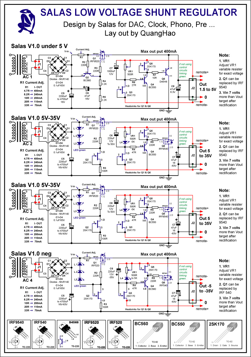

Hey Salas.
Sorry for asking a similar question yet again, but I've recently purchased the following shunt PCB from 'dvb-projekt' from this forum:
He said although it was designed with your 5V Shunt design in mind, it can easily be used for 24V output instead. My question would be is there another schematic of yours I can use so I can make use of this PCB for 24V output please? The schematic you kindly posted for me in post 4946 calls for 10 LEDs, but this board only has space for 3. I guess I could mount them off-board, but if there's a different schematic I could use to 'fit' this PCB for 24V I'd prefer to use that.
Many thanks Salas :cool:
- John
This one uses a variable resistive reference. You should use 5K Voltage Adj. trimmer instead of the 200R. Don't stuff those two 0.1u caps, give it proper input voltage, use 15R 3W Current Adj. resistor. Should fit your purposes.
Wonderful! Thanks Salas that's faberino! So leave all the values there as they already are (on the PCBs screen printing) but increase the variable resistor and leave out the pair of 0.1uF caps?

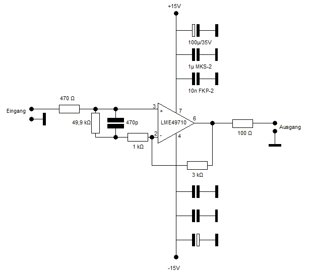

I have another quick question regarding v1.0.
Currently I'm feeding 2 LME49710HAs (used as a simple preamp) and would like to add another pair to the same reg for feeding DAC's output. It's 100uf MUSE + 1uf mks + 10nf mkp per rail now (47uf cap was replaced in accordance to preamp's scheme), do I need to add additional 47uf + bypass caps?
Also would it be enough to stay with 2200uf PS caps or they should be doubled?
You mean you got those caps on the rails after the regulator's output? It may oscillate as a system with the reg. Use only 1-10uF tantalum local to the opamps +/-Vcc pins I suggest.
Stay with 2200uF, will suffice. Opamps aren't heavy draw.

thanks, Salas!
yes, C7 47uf was replaced with the set of 100uf MUSE + 1uf mks + 10nf mkp (att.) The caps are placed on PS board then goes 10cm coax cable to preamp with no caps near +/-Vcc pins at all. Not sure though if that is a good solution...:confused:
Use the chip decouplers locally as the opamp circuit shows. I would simplify it to one Tantalum which has enough ESR or delete the film cap parallels to the local electrolytic, or use ceramic as Andrew said. I would restore the 47uF at reg's board. Thing is you play with decoupling and stability issues that without investigation with oscilloscope you can't know what is optimal or even basically stable for that system. Guess work involves too many layout and interaction parameters to be of any value, even theoretical.
