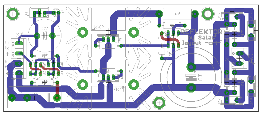

There is something wrong going on initially. There should always be 4mA available to charge the filter capacitor. Can 2000uF be overkill to start up? Here is an alternative routing by the way.

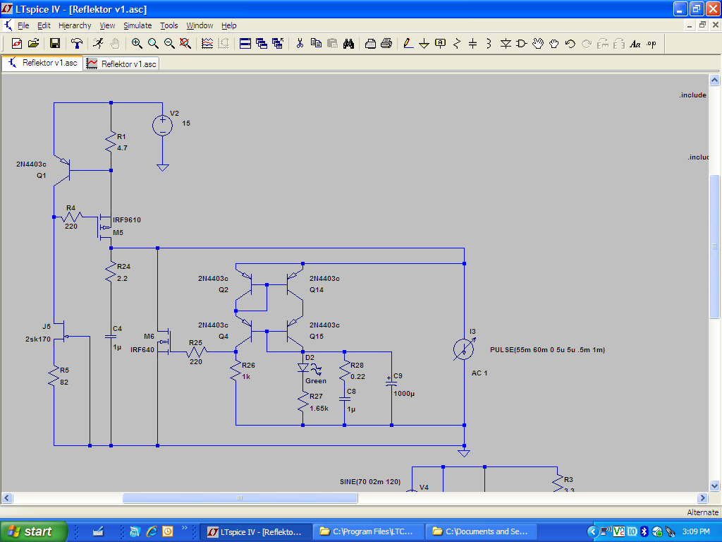

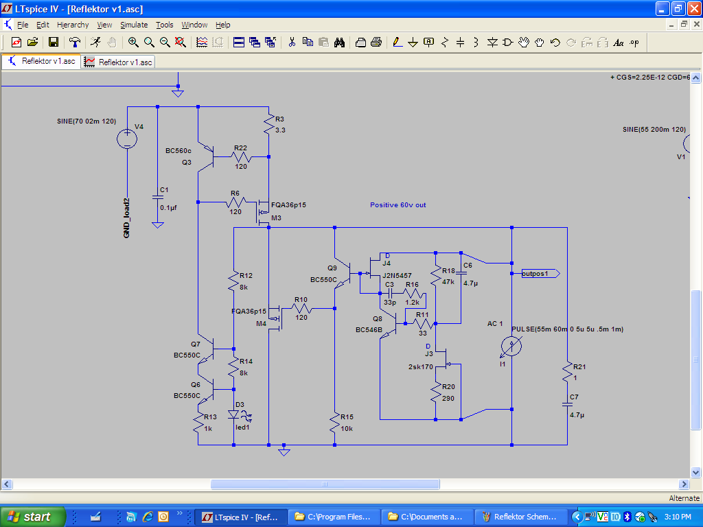

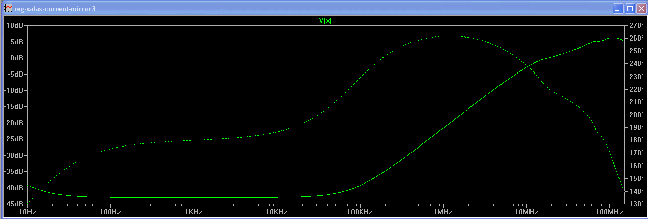

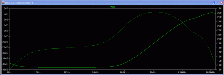

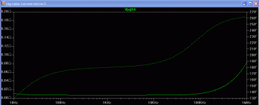

I have run simulations comparing Reflektor and V1.2. The V1.2 is at 60v out the Reflektor is at 10v out. The first image is the Reflecktor, the second the V1.2, the third is the AC analysis V(005) is the Reflektor, V(outpos1) is V1.2. Are my results correct (relatively speaking) ?
Ken

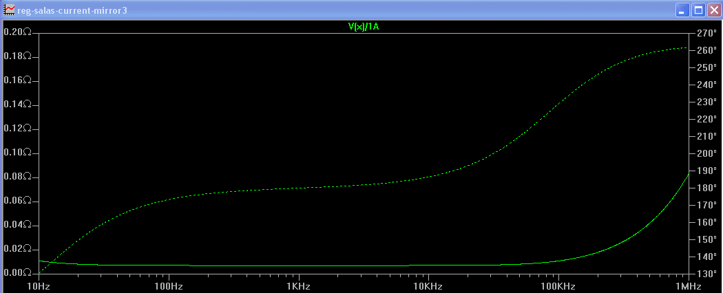

They are output impedance traces versus frequency. Dotted is their phase. You can read the one I posted before in dB, also in Ohm as such (~7mOhm flat portion):
Salas, I know I've probably asked this before, so, forgive my poor memory... How do you get the impedance analysis? Which simulation CDM are you using? I understand how to make the formula in the graph output...
