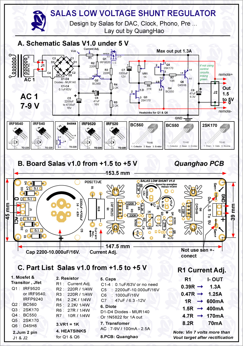

I realized a 1.2r version at +70V in and +60V out with zener and 680uF in parallel. All works perfectly and sound fantastic (I feed a CCS BOSOZ).I' m using a zener string (5 x 12V).
It's better to use a string or a single zener? Any suggestion?

A string has more impedance to filter easier by the cap and staggers the dissipation between pieces which is a good thing. If with one fat zener, add 100-220R in series to help the filtering. They don't add up noise linearly so its not that bad using more. The cap should be bigger than when with a resistor ref (you did well with the one you used), the zeners are livelier noise sources (like pink type noise), unless we talk TC compensated defence contract style ones which are silent, though hard to come by. Any pics?

1.1 stands in the middle. Tries to break some bandwidth performance ground towards 1.2 family while retaining less components and no compound feedback pair or CCS that needs scaling. So your last phrase I borrow and change to ''I implemented the 1.1 ver NOT only because this version is less problematic for a lot of different circuits, but to improve V1 family also.'' You guys are going to decide on what V circuits are going to be subjectively more synergistic with certain applications or not. The BJT output option of BiB is as much open as 1.2 by the way, but not same low Zo.

We have given before for squeeze in this thread I remember. It was 1.0 with remote, set on high CCS.
R1, best resistors?
I am using V 1.0 (Quanghao boards) in my DAC, with great sonic results, thanks Salas/Quanghao! I will be building V 1.1 as well. I am fine tuning the regs, mostly to get the heat levels manageable, and I am wondering what most people are using for resistors to set the CCS current? Right now I need about 550-600 mA (for my 5.3 VDC DAC supply), and am using two Panasonic 3W metal films, but these resistors seem to drop their value a lot when they heat up. Is there a type/brand of resistor that would be recommended that both supports high performance (I suspect low noise is important here?) and relative temperature stability?

Salas! Mills 5W was one that I was considering.
Parallel 2 x2 w, it is better than only 5W

I use Kiwame & Mills, Mills better in subjective places: Vref, CCS current. To set the Vout the best trimmer Vishay 1280G 0.75W 15ppm
