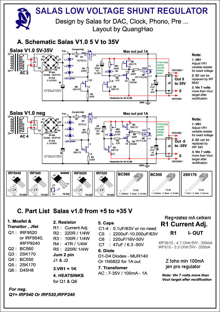

I have running Salas v1 regulator for in my JHL headphone amplifier powering both channels. CCS is set for 340ma. Sounds superb, maybe little dark, but it could be headphones or amp itself.
As I was reading the whole thread I noticed I have few little differences in schematics I have used.
Referenced to positive scheme:
First, should I bypass the CCS leds with 100uF elyt? Some schematics have this bypass some not.
Second, should I put 10r resistor between Q3 2SK170 FET and ground?
Third, output cap is only 47uF, should I raise it to 220uF as on the other schematics or lower is better?

What CCS Mosfet type and have you added remote sensing? RS helps resolution further. That CCS leds capacitor helps the PSRR but not too drastically in practice. You may check subjectively with or without it. That 10R was working towards better transients with the initial V1.0. If you take out the CCS Leds cap, take that out too. 47uF is good when your tone in general tends to darker.
Forgot to add my schematics...
OK, now I see what you made. 9610 is nice for CCS. Its OK as a whole. You may short R3. Use remote sensing or use very short strong cables. C6 different brands to try, some can brighten up your tone. How high voltage for the JLH?
Thanks for reply. So I can leave the schematics as it is and experiment with output cap - smaller darker sound and bigger brighter sound I suppose.
Input voltage is +-18V and output is +-10V.
You can experiment with C6 which is across the trimmer and Led. That one you can make from 47 to 220uf, change brands, esr, bypass with poly even. The output one never bypass with poly or mkt and you can play between 47-220u and qualities. But not super low esr please, to stay stable. Can't comment on how it will affect the total of your components, since I can't experience them, but I know its effective enough. You tune. Always use remote sensing 4 wires for best resolution.
Hi Salas,
I would like to build your shunt regulator psu for T-amp. The current draw will be around 200mA.
Will Q1 and Q4 be hot under this current consumption ? Will 0.5W rating resistors be suitable for this application ?
Also in your design, the input voltage is 20V while the output is 12.6V. Can I use a higher input voltage say 22V to get the same output voltage of 12.6V ?
Thanks for your input in advance.

during which operating conditions is the current draw 200mA?.... shunt regulator psu for T-amp. The current draw will be around 200mA.
Are there any operating conditions when the current draw from one or other supply rail is less than 200mA?
Are there any operating conditions when the current draw from one or other supply rail is more than 200mA?

200mA for a T-Amp? Maybe just at cruising level for the 15W model. Use a current meter in series with your now supply and play at full tilt tracks with strong dynamic range on your most difficult loudspeakers. Register medium and peak current draw and then set the reg +20% peak. All the excess above median SPL current draw will be constantly burning at no peaks time on the output Mosfet's sink times Vout, while all the available current will be burning on the input CCS sink times Vin-Vout. Draw your wattage and sinking needs from that. HOT. External sinks for sure. The resistor that needs to be reviewed for Wattage rating is R1. It must hold what voltage you will measure across it (around 2V ballpark) times the full current set. Choose X3 that for its rating so it stays reliable in the long run. Yes, you can use 22V but be economic with Vin-Vout if you will end up at some high current setting because every spare Volt will kick up CCS heat dissipation.
Imho a shunt regulator for a T-Amp does not make sense at all. Total waste of energy!
Why Switch Mode Amps? Very energy efficient!
As Salas pointed out, the use of the shunt regulator would lead to a constant power consuption of ~Pmax. So the major benefit from using a T-Amp is lost.
