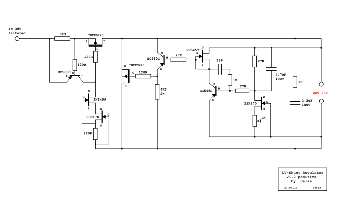

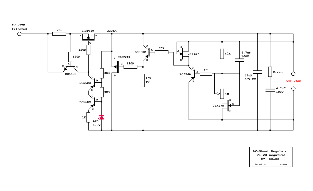

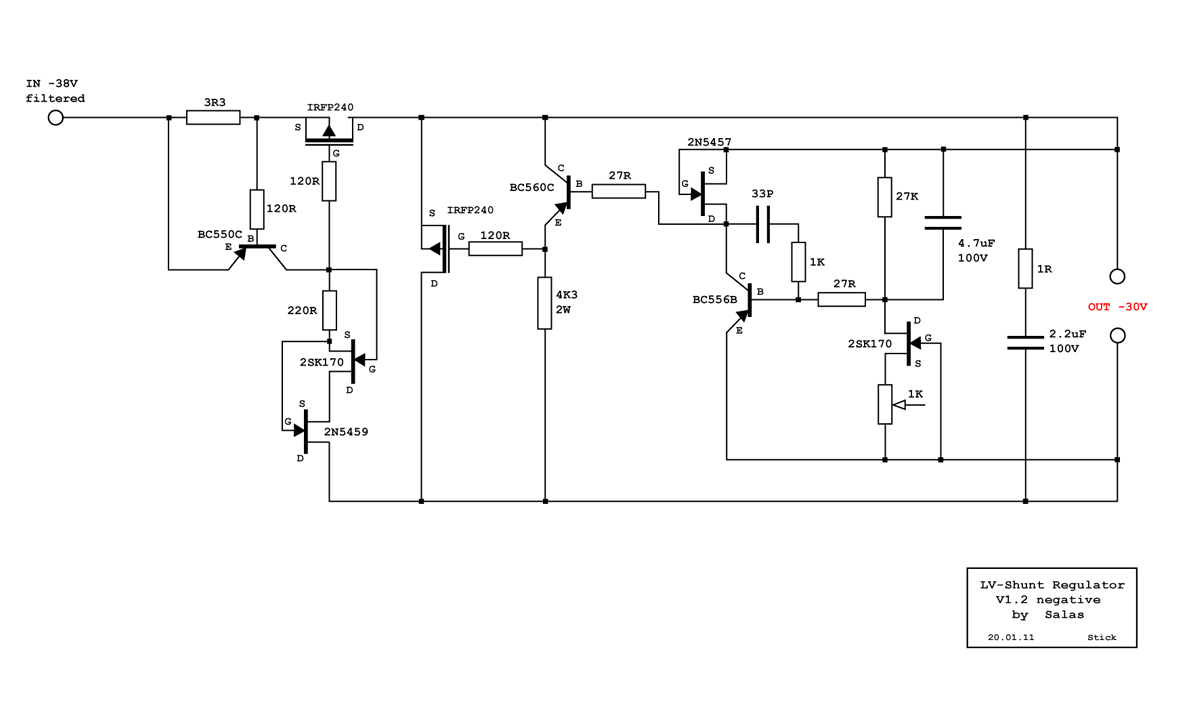

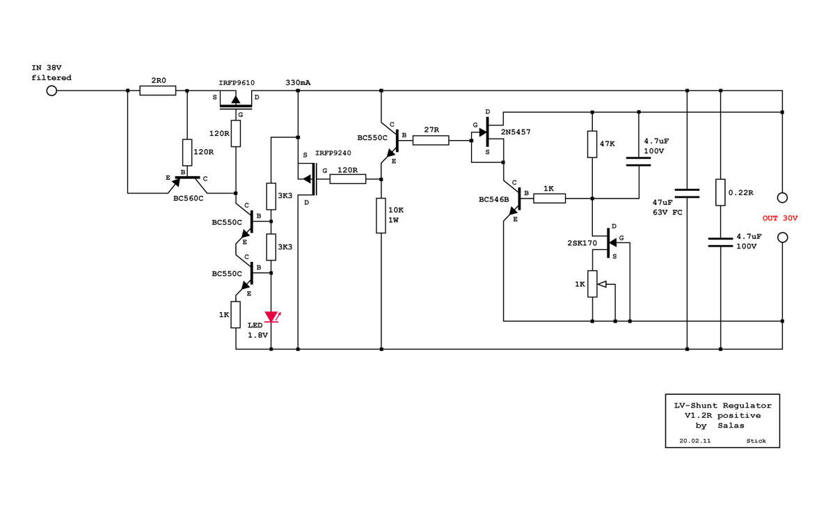

I am about to start building the Salas reg 1.2 pos. and neg. for a hybrid headphone amp (EHHA RevA). I am doing this per recommendation of Salas to use these schematics when no scope is available.
I will use one reg (per polarity) for two channels so I will set them at about 350mA.
Attached I have redrawn the schematics (as usual ;)) and marked the pinouts...
Q Did I get the SK's and 2N's right...?
Anything else that might have escaped me (I know it starts to get tiring...:D)
Thank you
Thank you
The 2N5459s in the CCS tails will not take your projected voltage levels. Up to 28VinDC tops.
