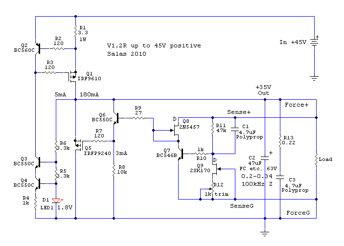

The simplistic Salas low voltage shunt regulator

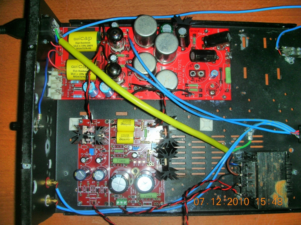

That is the preamp, as you posted it when you added a high voltage regulator and a heaters chip regulator, shown on a common QH board.
*In the AN schematic there is heater potential lift as in most totem pole arrangements. Is it there still?

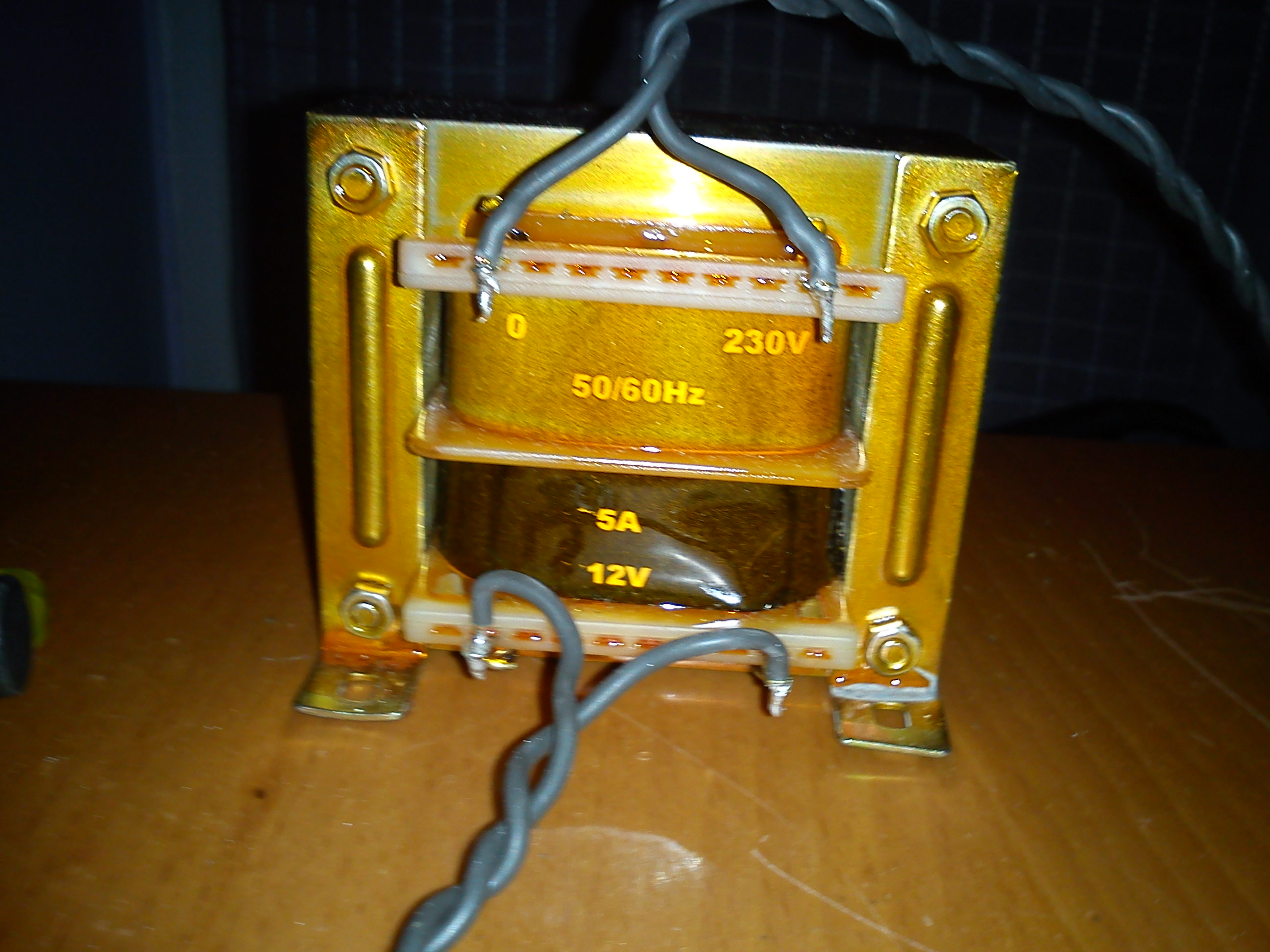

Since the CCS output voltage is ~12V then the input voltage should be ~22V. This can be achieved with 0-15 + 0-15Vac transformer 36VA (1.2Aac)

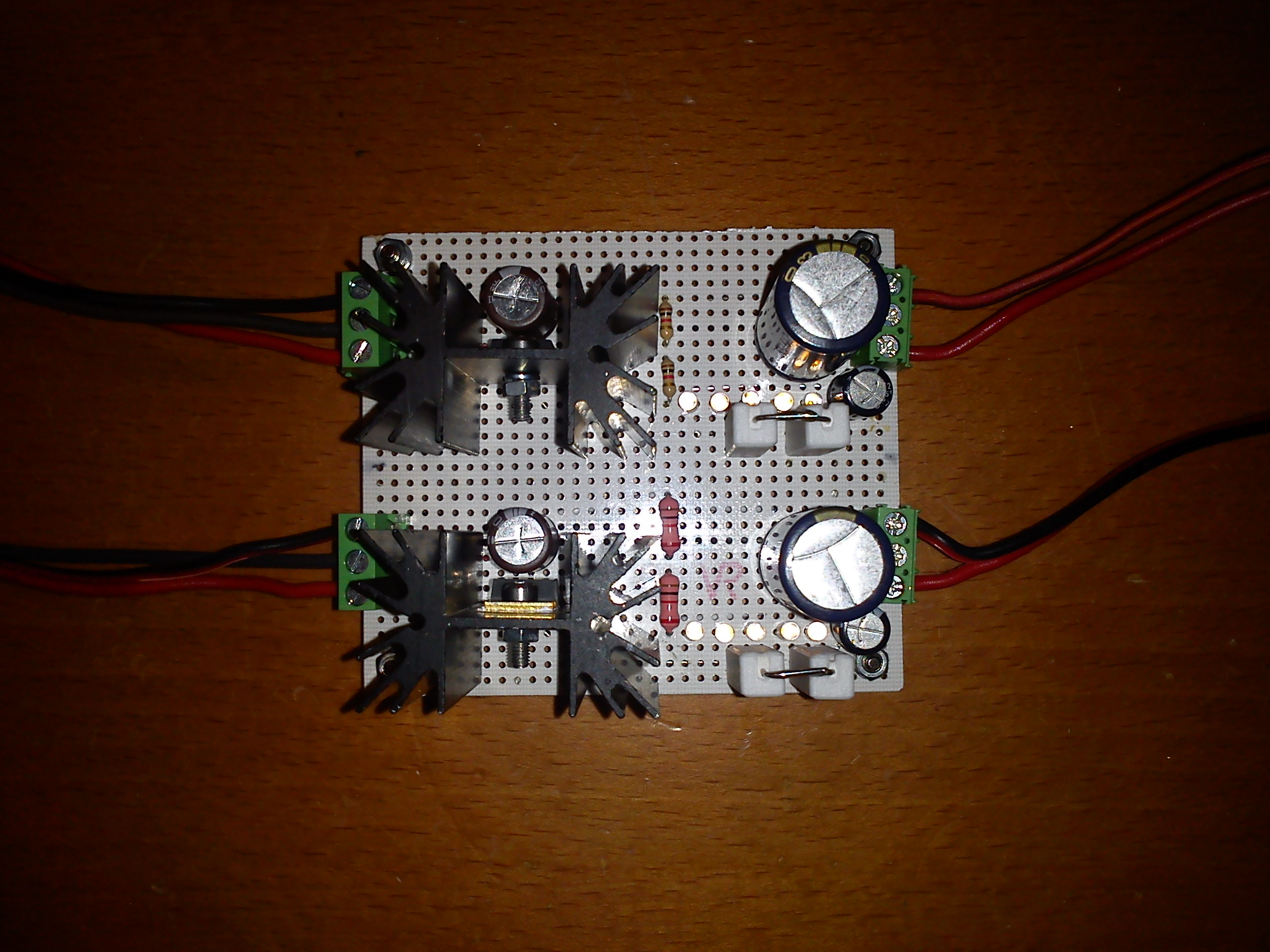

Before start the new CCS I changed R1 for 16R5 & with one tube I get 6.20V & with the other tube I get 6.42V with the same CCS so my question is whats happen when both tubes are working shunt regulated? surely something goes bad not?
the heater that shows 6.2V is dissipating 6.2*0.295 = 1.83W
the other heater is dissipating 1.89W that's an extra 3.5%. Does it matter if one heater is 3.5% more heat output?

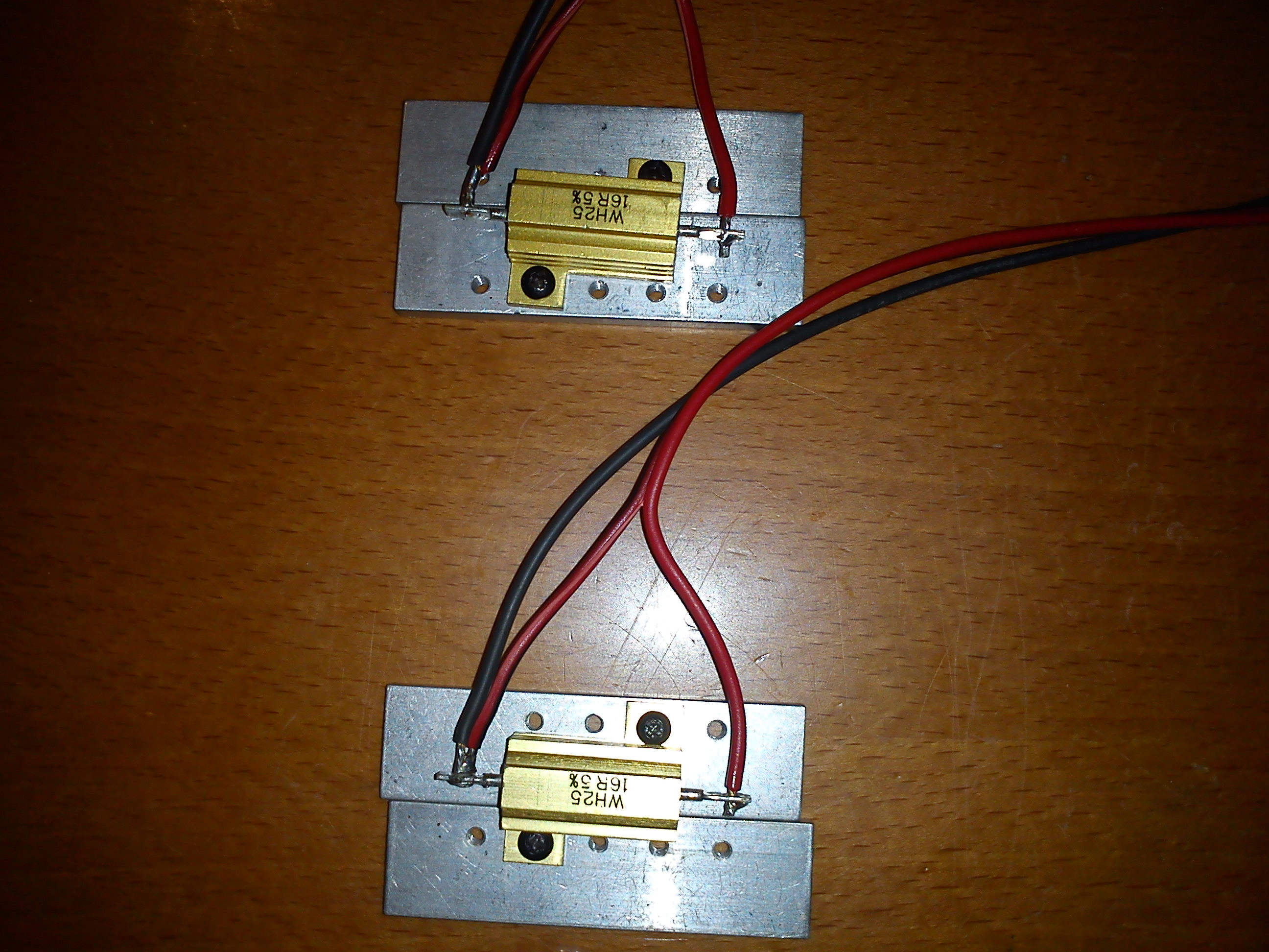

Both CCS: connected 1 Tx, R1 16R5 & dummy load 16R 25W
2nd CCS measurements:
DCin 14.89V
Across dummy load 4.65V
Across R1 4.70V (0.284A)
Across R2 5.90V
Across LEDs 9.07V
1st CCS measurements:
DCin 14.89V
Across dummy load 4.75V
Across R1 4.81V (0.291A)
Across R2 5.85V
Across LEDs 9V
