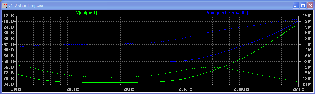

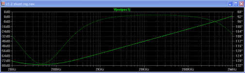

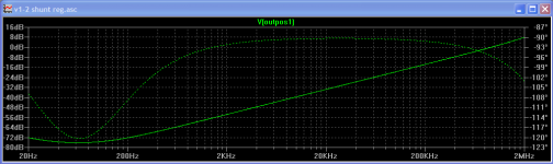

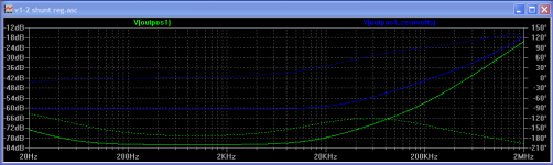

Did the simulator indicate any difference in regulator performance when the cable inductances were added/subtracted? .
See attached. First is without inductors, second is with 6nH = 1cm of wire inductors, third is with 85nH = 3inches of wire, 4th is with 172nH = 6 inches of wire.
In the second graph I measured between +ve and the zero volt location you suggest.post2928.

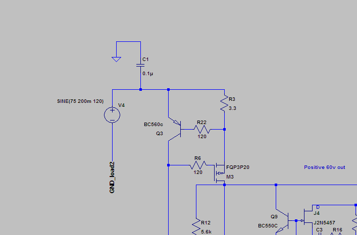

I see you have +ve out and -ve out in the two diagrams.
You have omitted Zero Volts out in both diagrams.
The zero Volts is NOT at the ground symbol.
The junction of L12 to L13 is outposZeroVolts.
Ken
I think there are a lot of different messages in those 4 simulations.
I would to learn how to read those messages.
In the second, it is clear (I think) that the added inductance due to 10mm connections is adding a bit of phase change. Moving the Zero Volt tapping point brings the phase nearly back to where it was when connections were 0mm long.
I think the lessons here are threefold.
1.) longer wires changes the phase more.
2.) simulating with some real world estimates gives a different result from assuming every item is theoretically perfect.
3.) that the ground point must be modeled just as accurately as the +ve supply point.
4.) conjecture, not a lesson: Are the increased phase changes an indication that the longer wires are more susceptible to misbehaving due to component types and values and layout?
What other messages are in there? I suspect there are dozens.

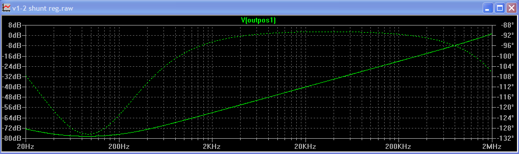

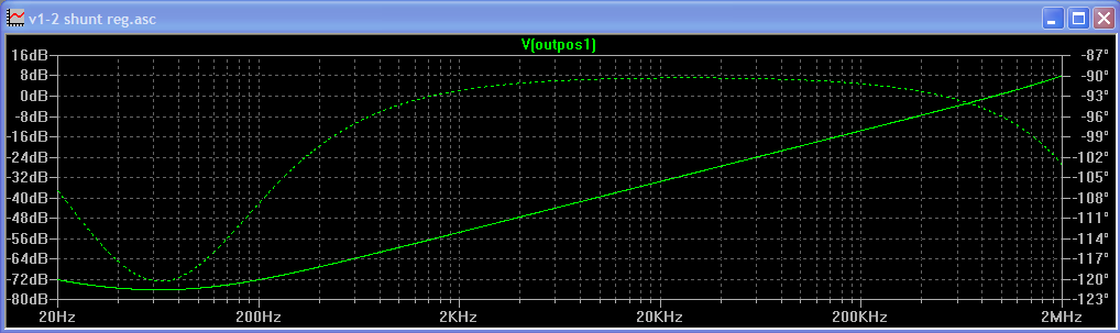

What is this meant to do?
Also, Ikoflexer generates plots of the impedance for the circuit, with the outputvolts / 1A (or something like that). What is the formula I want?
Ken

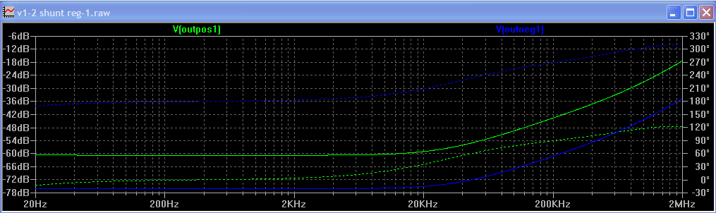

Did you make the V1.0 RS you were laying out once BTW? You would need a text line .params prb=0 and to give 1 on your Vsource and Isource AC amplitude, then run man and probe output. If you click on Vn you can edit it /1A and choose linear over y axis by hovering the mouse and left click there. You can set your Ohm scale limits there too.
Impedance of the output is calculated by measuring the effective resistance of the regulator with frequency. IE, if when drawing a 1A load, the output voltage sinks by .01V, your reg has an impedance of .01ohms as per Ohm's Law. The way I simulate this is to use a current source at the output set to idle load current (say 100mA or whatever you expect from the real load) and use it as the AC analysis source. LTSpice will then give a plot assuming theoretical 1A AC current draw, and clicking on the output node will give you the AC voltage change in volts. This effectively tells you the output impedance in ohms (volts change/1A current=ohms impedance). leftclick on the left scale and select "logarithmic" to see values in units instead of decibels.
Your inductors as they are are only arbitrary. There are no interacting magnetic fields, as there would be in real life. For example two wires next to each other will have inductive coupling along with their separate parasitic inductances. The commands I described allow you to add this coupling to the simulation.

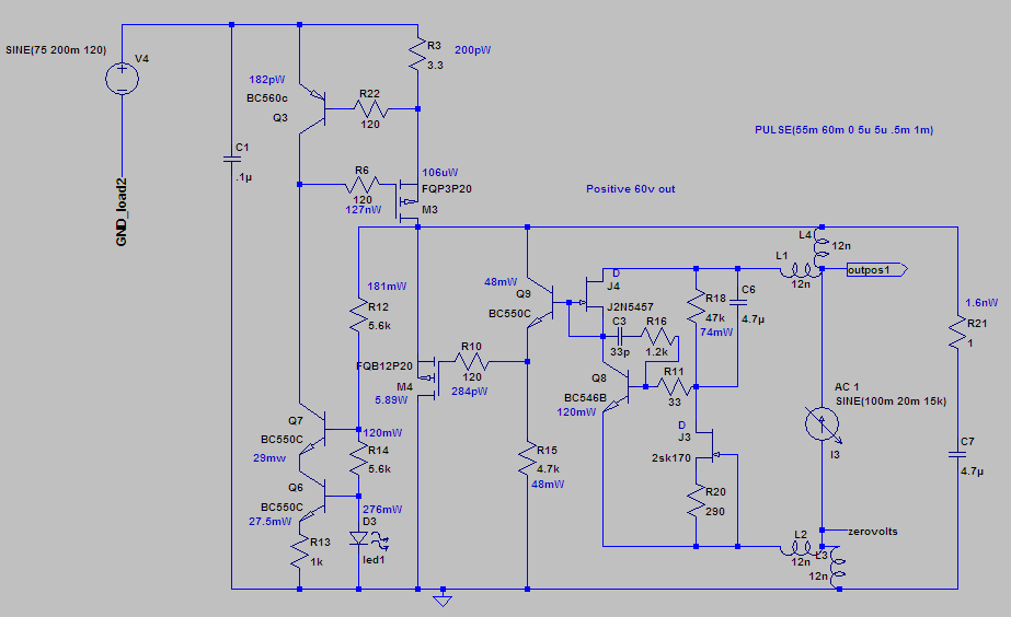

I went through the simulation and recorded the Watts at each device. This is for 75v in, approx. 60v out 120mA peak load (100mA base, 20mA excursions). I don't show the value for several of the devices if it's in the low pW range. The only thing surprising to me was the load at my R3 (R1 in Salas version). Does this look right?
Ken
Ken
3W for the CCS and 6W for the shunt Mosfet when set at 200mA and connected to a 100mA load are the numbers you look for in your case.
