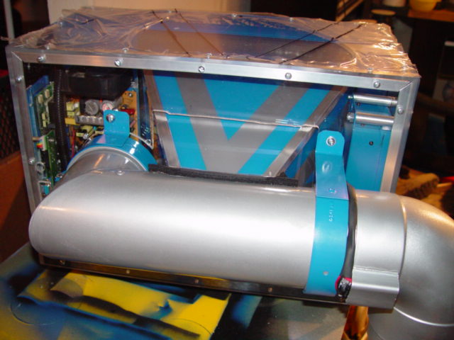

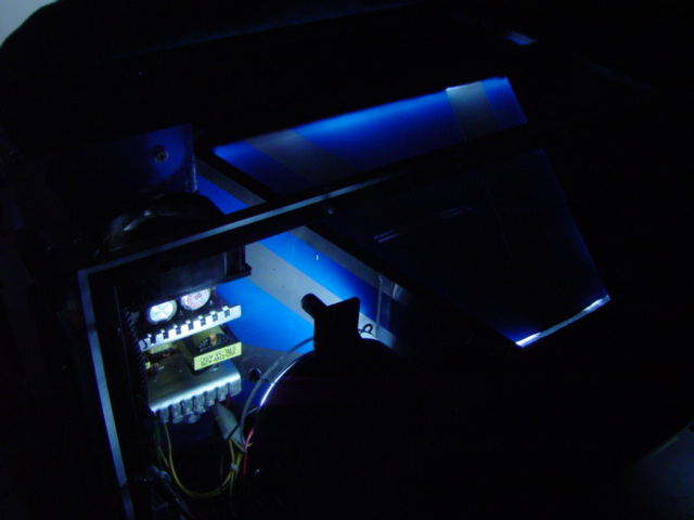

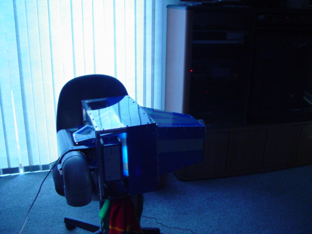

that also makes my light tube 1 1/2" long so i cut the tube down
well the good thing is the overall length is 1 1/2" shorter now 🙄 so now i reassembled it and wired up the powersuply and fans and this is the result
i fired the bad boy up and all works nice now i have to construct the lens assembly and its time to ship her off to her new owner
all the way to california from here in new york "i just hope it gets there ok" since i had it fired up i took a pic of it running with its beautiful glow no results yet but dont worry they will be coming this week

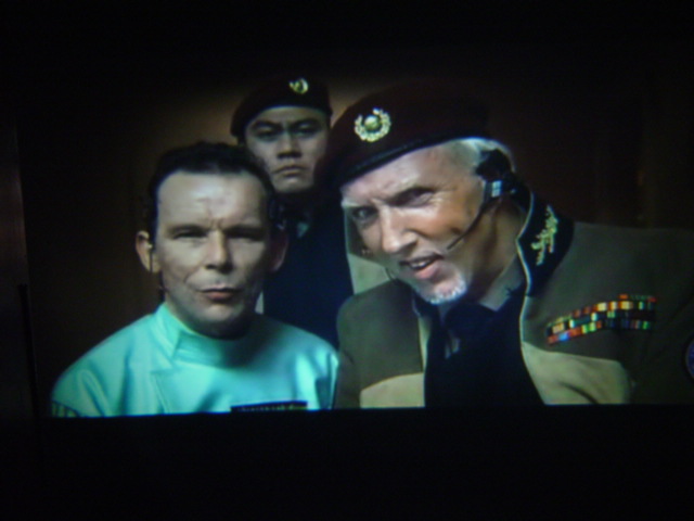

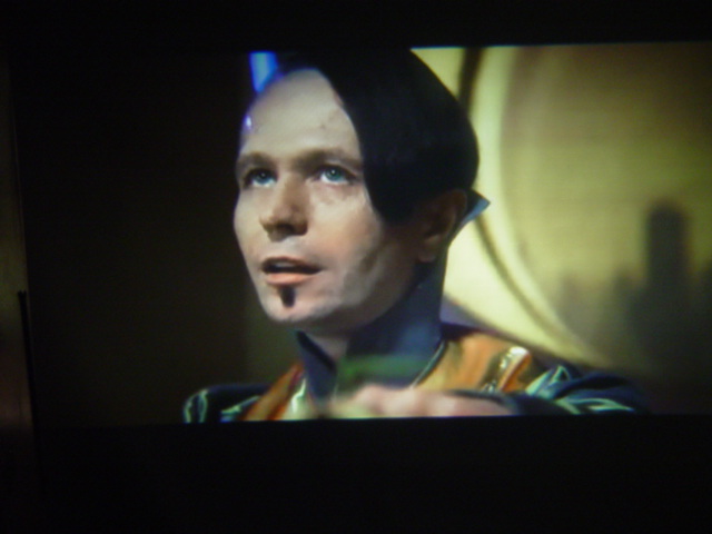

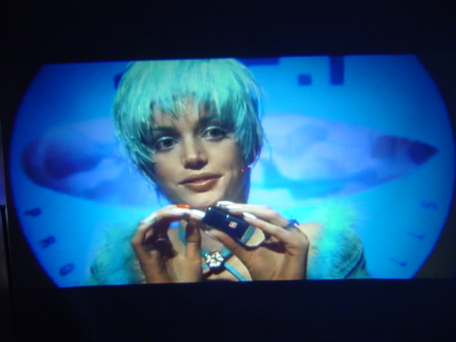

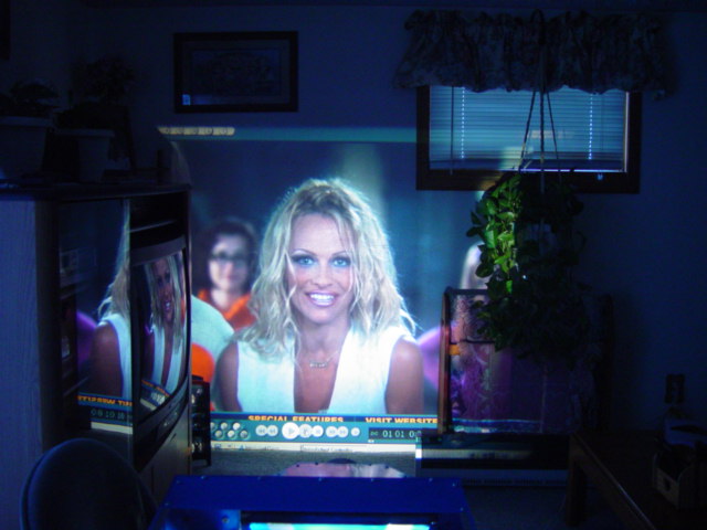

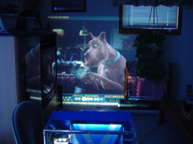

and finaly time for sone result screen shots i didnt have a long enough video cable to get to my computer so i had to take it upstairs to the family room computer and i dont have a screen up there so i just used the wall and it was not big enough and it was 2:00 pm so the room is lit up from sunlight
well anyways here we go this is the pj sitting on a chair you can see how lit the room is
there is no flash on

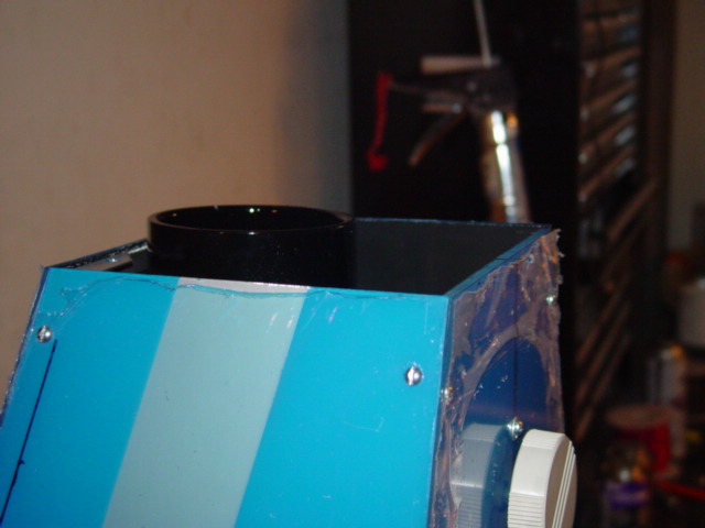

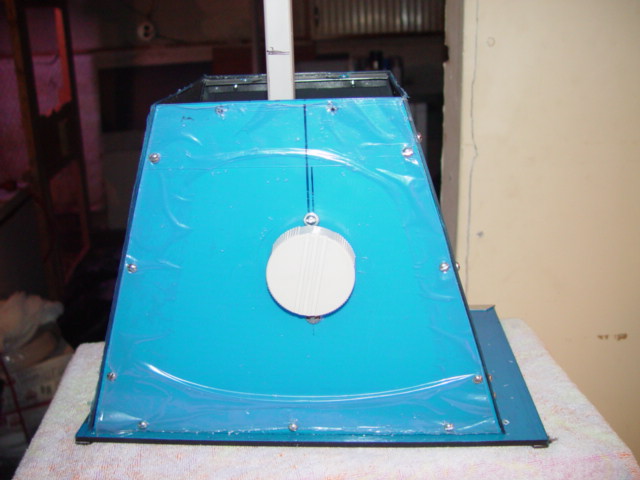

Question: didn't you used condenser lens at the end?I saw you spoke about it on 1st page...but I saw only reflector in your light tube enclosure

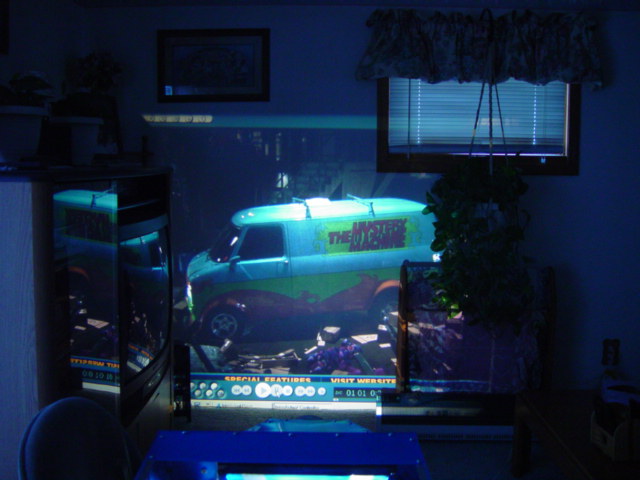

cruser said:
heres a screen shot of scooby doo from behind the projector
i can amagine how nice it would look in complete darkness

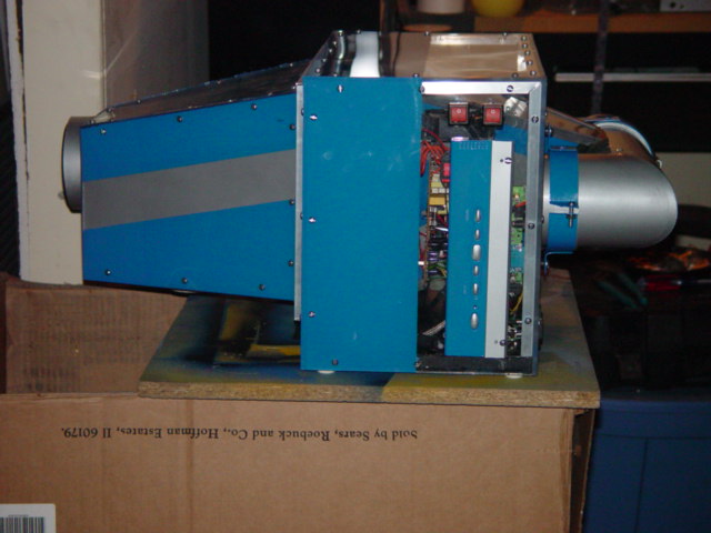

yes it is the smallest one i built yet it measures 13X19X28

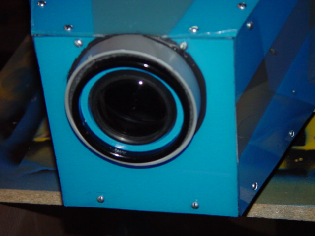

MicheleRaponi said:
You're on top!!!
Simply the best!!!
Anyway best compliments!
P.S: someone is trying to do something similar....🙄....glad to take inspirations from you! 🙂
Regards
Michele
man i cant get nothing past you people very observent
i had 2 condensors to try in this projector and neither spread the light enough so you are correct there is no condensor in this pj
nice to see someone trying on my design if you need any help
when putting that rig together dont hesitate to give me an email

Cruser: How did you solve the mirrored image problem?
mirrors are not nessary unless you have to conserve space they are good to fold the optics
but i prefer to project straight thru horizontaly because when you put the lcd over the lamp it just creats more heat and heat is the biggest factor in these setups
split the fresnel and its even cooler because more light passes thru the lcd instead of getting absorbed into the polarizer
but anyways all you have to do is flip the lcd over and the image is corrected
