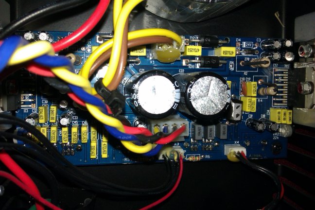

Okay, just being cautious. First time I've done this sort of thing, so don't want to step on company toes. Plus, my photo'ng days are well behind me, I have zero interest in doing such things unless if it serves a very direct, immediate purpose. Just had a look around, and there appears to to be plenty of other Behringer material exposed as such, so I shouldn't cause a bother here.
This is a roughie, as said, was done some weeks ago for a purpose, but gives the picture:
TDA7293Vs at each end of board, mounted on small pieces of aluminium. Note the fattest components are the rectifier diodes, on top ...
Frank

As you can see, the power supplies are pretty ridiculous, from my point of view: the level of crosstalk, once the bass driver is starting to work hard, on the voltage rails would be dreadful. If I was starting with a clean sheet, and wasn't worried about costs, and fitting it into the space, I would use 3 separate transformers, and 3 following, dramatically more independent, power supplies. One for the treble power amp, one for the mid/bass, and one for the filtering and other circuitry: this alone would lift the dynamics to a whole new level.
But, that wouldn't the "smart" way, so the trick will be to isolate voltage rail fluctuations in the various areas from impacting each other. This is where something like LTspice can really help, by showing you what actually happens in real circuits -- no pretending you have pure voltages just because a schematic has a neat symbol, like V+, claiming such.
As far as I'm concerned, a voltage rail is a varying input, just as much as the wire marked <In>. This is the sort of thinking that has allowed me to make good progress over the years -- don't assume anything!!
Frank
