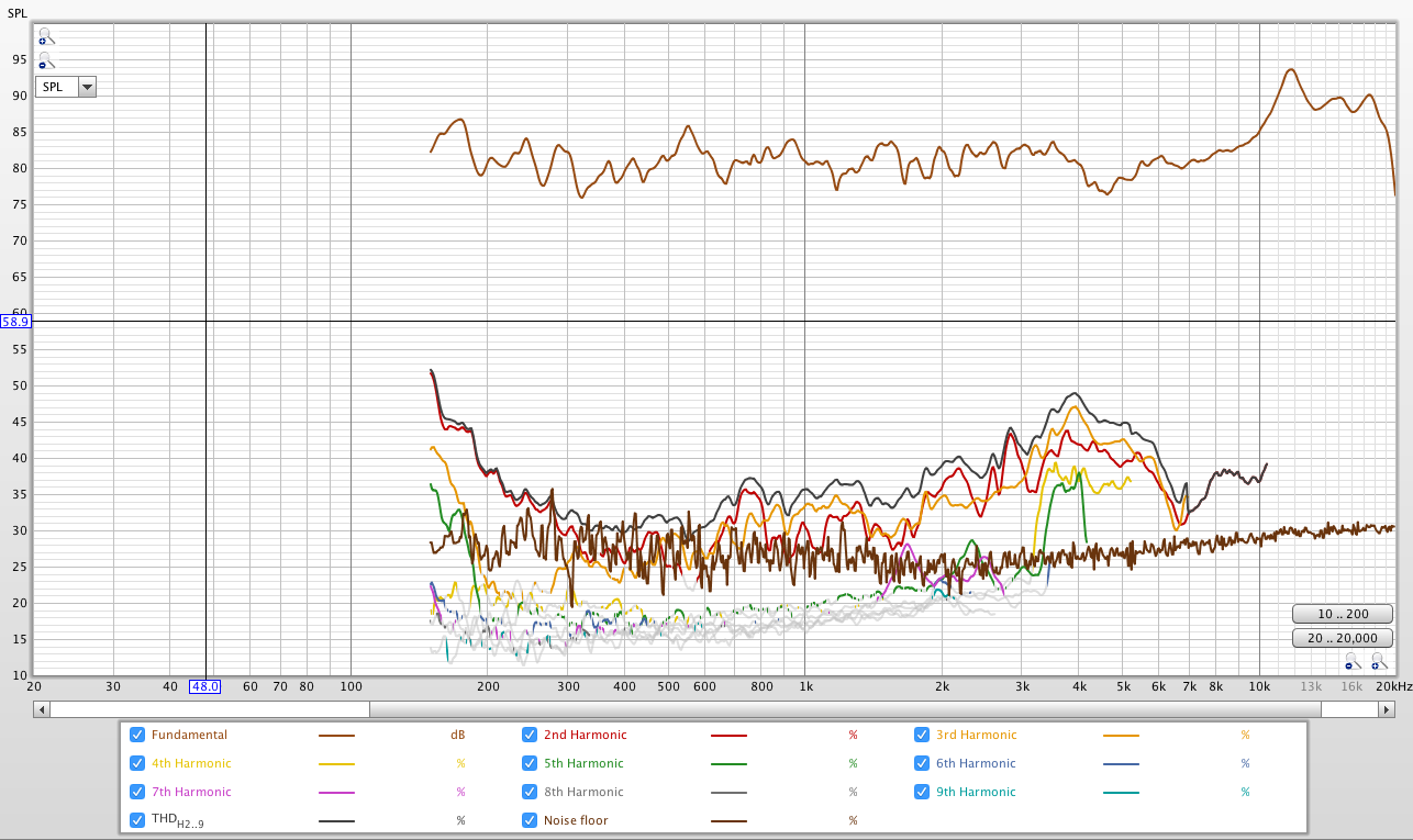

What do you find strange in distortion ? It has 12dB peak at 15kHz so i do expect third harmonic to go wild at around 5kHz. Bare in mind that this is THD so it is presenting 2nd, 3rd and all other harmonics with one line.

I saw that but i consider those measurements weird. Measuring level is too low to be able to see the distortion profile. It should better be presented as percentage, not like that. Frequency response should be measured raw. If that is raw, then it measures nothing like in SB datasheet and that is weird given that SB frequency measurements are quite good.

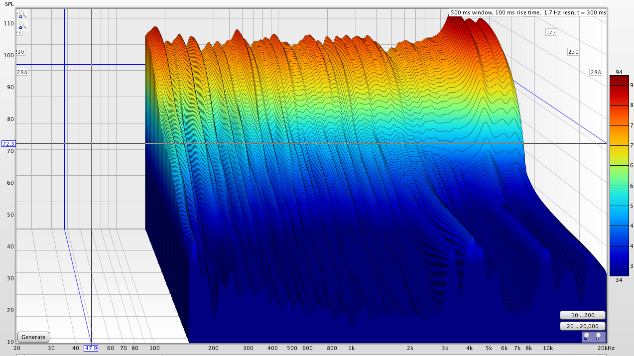

ok, I tried to calibrate as best as I could.
That distortion peak is there to stay, and same things happens with the waterfall.
Thanks for measurements.
I don't really know what did they try to achieve with this driver. It doesn't have a metal cone but measures like it does. I wouldn't mind peak in distortion if it had stellar distortion under 4kHz which could make it a good midrange in a threeway, but distortion is quite average.
Peerless TG9 (although not black cone) is a lot better driver.
Yeah, a bit odd - I actually have a couple of these coming ,but those results aren't quite what I was hoping to see. I wonder whether a notch on the break-up will help with the amplified distortion products at all. If you have to notch that 4k resonance in the waterfall, it's not going to be a particularly useful driver. Definitely not the 'poor man's 10F' I thought it might be.
