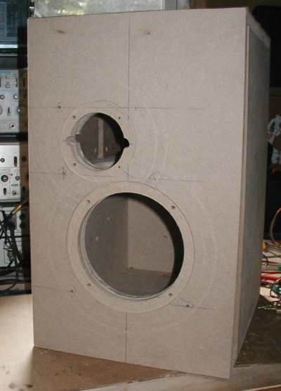

Current build is a mix of dark and light MDF. Both sourced from Home Despot. Both have the problem I described. I have not had the oppertunity to get a delivery from one of the top line MDF suppliers. I am pretty much stuck with what fits in my GTI from local consumer stores.
I just squeegeed on the first layer of poly resin. It seems to stay tacky on the MDF longer than it does in the pot, and this pair is too big to fit in the oven to fast cure, so it will be a while before I have a solid hard plastic substrate to finish and see if it bridges the seams permanently.
With my typical 3/4 edge radius and sanding the sides flat, all sides have cut through the slightly harder surface layer. Getting really flat will be a matter of blocking them out after the resin buildup. Just like blocking out a car. High build primer, guide coat, stiff sanding boards and a lot of elbow grease.

I'm wondering if I can put filler right on top of the sanded primer. Basically my thoughts were to sand the entire surface until I start breaking through the primer at the high points of the mdf surface. Then I can put filler over the entire surface (something I didn't do when originally prepping the surface) and then sand until my surface is flat. Does anyone know if the filler will adhere to the primed surface of the mdf?

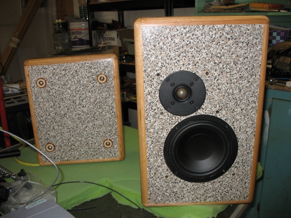

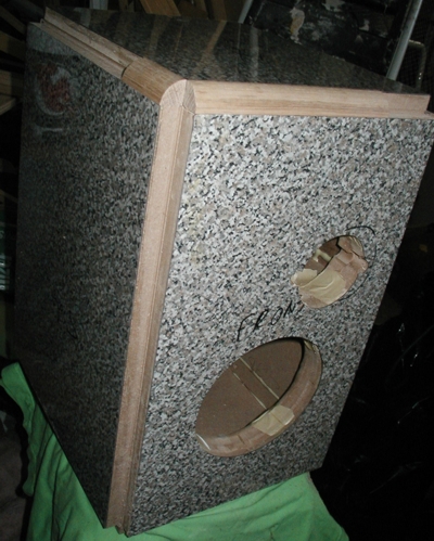

I ran into the same problem, and decided to simply cover the MDF with formica, and they turned out great,
Lukas
Nice work! Did you route out the edges where you put the pieces of trim?
The cabs were made with 2 layers of 3/4" MDF, so I had enough beef for the 1/4" rounds, I just ran the assembled cabs thru a tablesaw to notch the edges.
Just be aware that stock 1/4" from Home Depot is not symmetrical, the 2 edges are not guaranteed to be equal. I notched the cab edges for the shortest sides, and used a trimmer bit in a router after gluing the formica & 1/4 rounds to trim the 1/4 rounds' longest sides.

I hand sand with a large straight edge to knock down high spots and avoid creating more dips. You can put fillers over primer in fact its designed for that purpose fillers adhere to primers better than just about any other surface.
So that is what I am going to do! Sand the primer that I have on there until I hit the mdf, and then I will throw on some bondo auto filler to level it all out. I will give it a go on one of the smaller speakers first to see if it works out and then I will hit the rest of them.
jerseyguy1996 ... I'd source out a long sanding belt ... about 100-150 grit ... from the home depot. (think like 4"x36-48" here). Fabricate a block of hardwood long enough and wide enough ( and flat 😛 ) to slip the belt over. Use this sanding block to work the cab faces. Then use the filler. Do not try to sand down to the mdf using it as some sort of guide now. Your aim is to flatten the surfaces.
