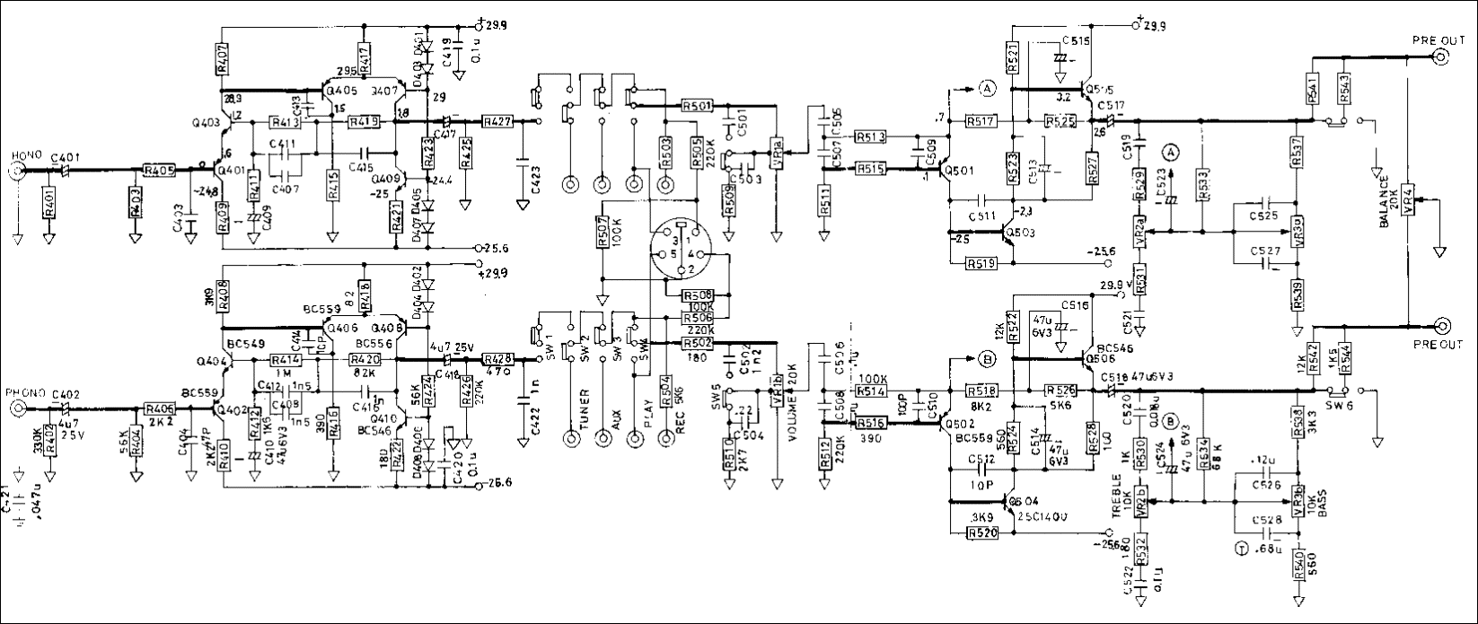

P.S.: Maybe the reason for the exceptional good sound of NAD's 3020 RIAA phono amp is even the use of Rush Cascode (NTP = "no-tail pair") as input stage.

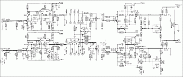

I did it. Send me an MP. However the circuit shown in the paper is not a Rush circuit as currently discussed here.
By the way, I thought the name of the inventor of the NPN-PNP coupled emitters circuit was Christopher Rush. I may be wrong, Ed Cherry attributes it to Charles Rush.
This circuit, just as the NAD3020 phono preamp, have two inputs, non inverting and inverting, which clearly demonstrates that a Rush circuit is not a cascode.
