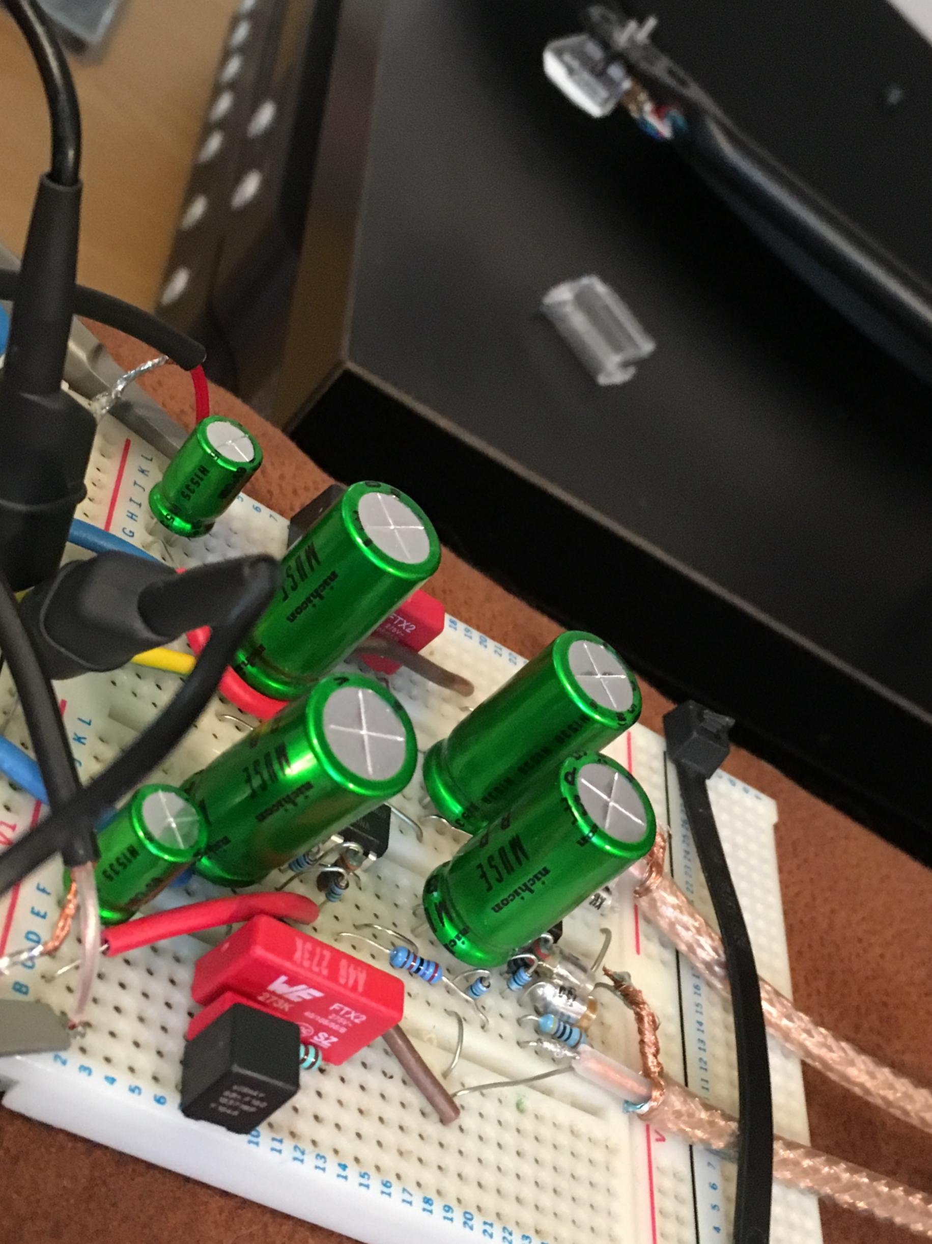

Following on from the Mosfet amp gurus thread...
I've now got a working Rega Planar 3 too. A drop of Superglue on the motor pulley was all it took.
I also did a new layout of my TI phono amp (page 1 here: http://www.ti.com/lit/ds/symlink/lme49720.pdf) to cure some instability (I'll take a look at the RE phono amp layout for you).
My passive RIAA phono amp is on a breadboard and runs off 9V batteries. Polystyrene and polypropylene except for the Nichicon ES 'litics.
Because I am using a moving coil cartridge I changed the TI design to have an input load of 470 ohms in parallel with 300pF. I tried to make an educated guess at these values by researching other MC phono amps. I'm sure it is not optimum. I also increased the first amp's feedback resistor to 10k to boost the gain by a factor of about 3.
