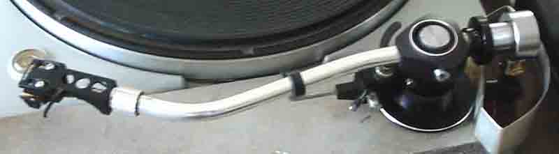

A poor pic.
Hi Keith,
Here is a poor picture.
Note that the arm does not have any antiskate. If it did have it originally I never got the parts. I should have the one page leaflet I got with it.
It did not show any antiskate assembly.
The tank at the back is an oil filled damping device. Looks crude and works well. The only hitch is that oil tends to creep up to all the parts close by and so the unit has to be cleaned off and on. I cleaned it in a hurry for the pic!
The sound off this arm is quite good. The cartridge in the picture is a Shure M95ED. But I use others mostly. The turntable is a Thorens TD124AB.

Hi Ashok
Nope you got me stumped although I have seen something similar but can't think where. I dont find it on Backspin's Technics page either , he lists most of there stuff. (list supplied by ex Technics Design Engineer)
I'll look again I found the one I mentioned on either google or altavista.
NB I see the recommended load impedance for the AT3200 is 4K7 ohms and output is 2mv as apposed to the AT30 which is 47K and same output.
