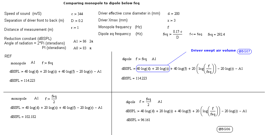

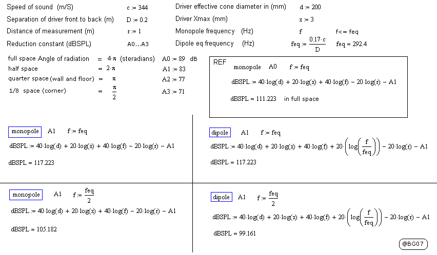

I hereby recall my earlier posted(#6) picture containing some derived SPL equations: ‘dipole-feq.gif’ as the picture partly contains errors and assumptions not valid thus should not be consulted and is replaced with the submitted ‘dipole-feq- rev.gif’. Sorry for this inconvenience.
