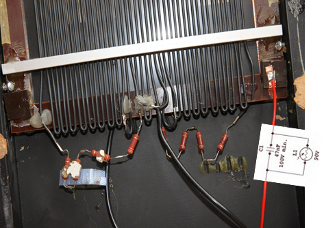

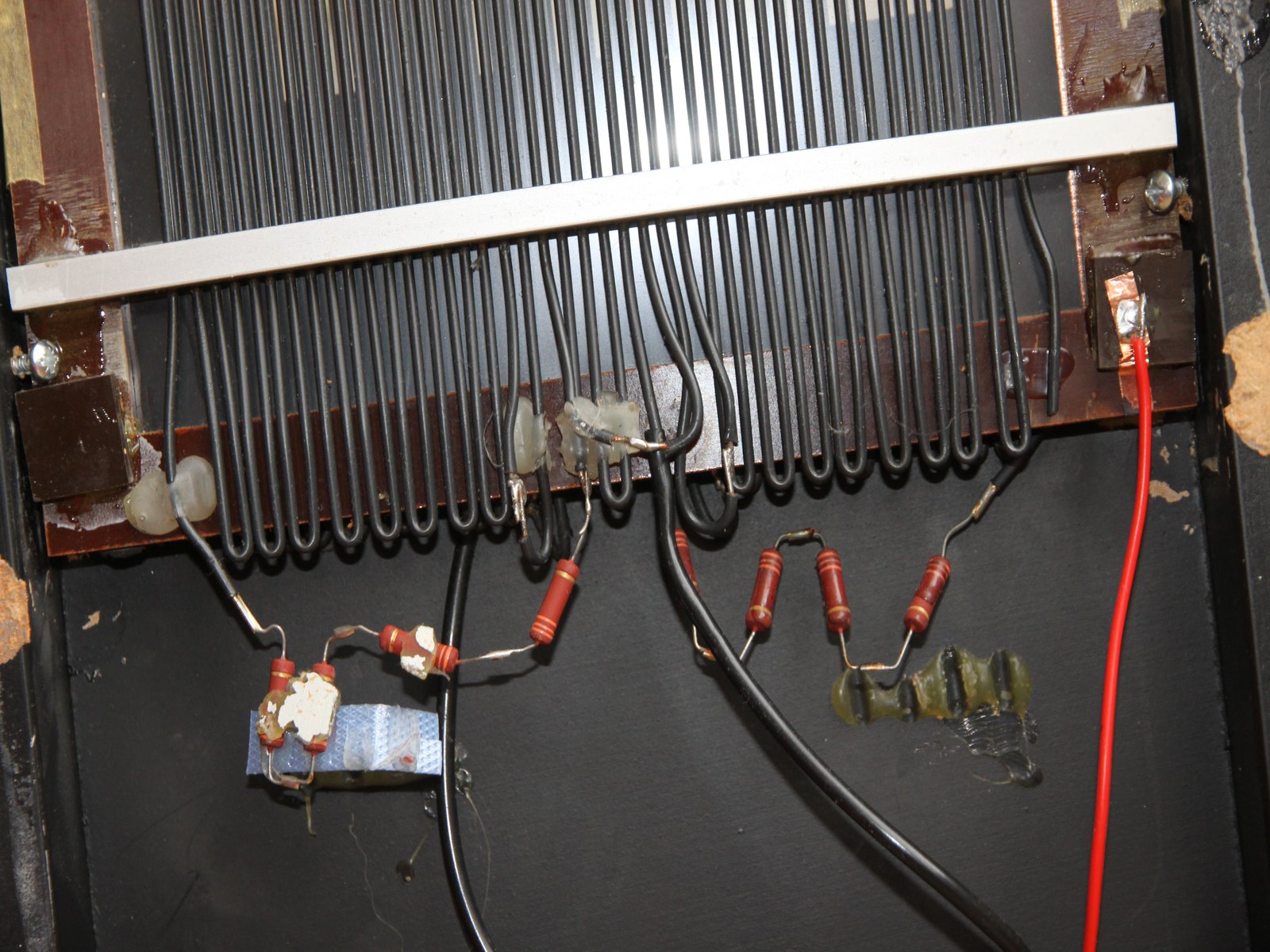

In the first picture you can see the resistors of the stator segmentation. Are these the correct resistors ? I have read that some people use a different segmentation. Is this recommended ?

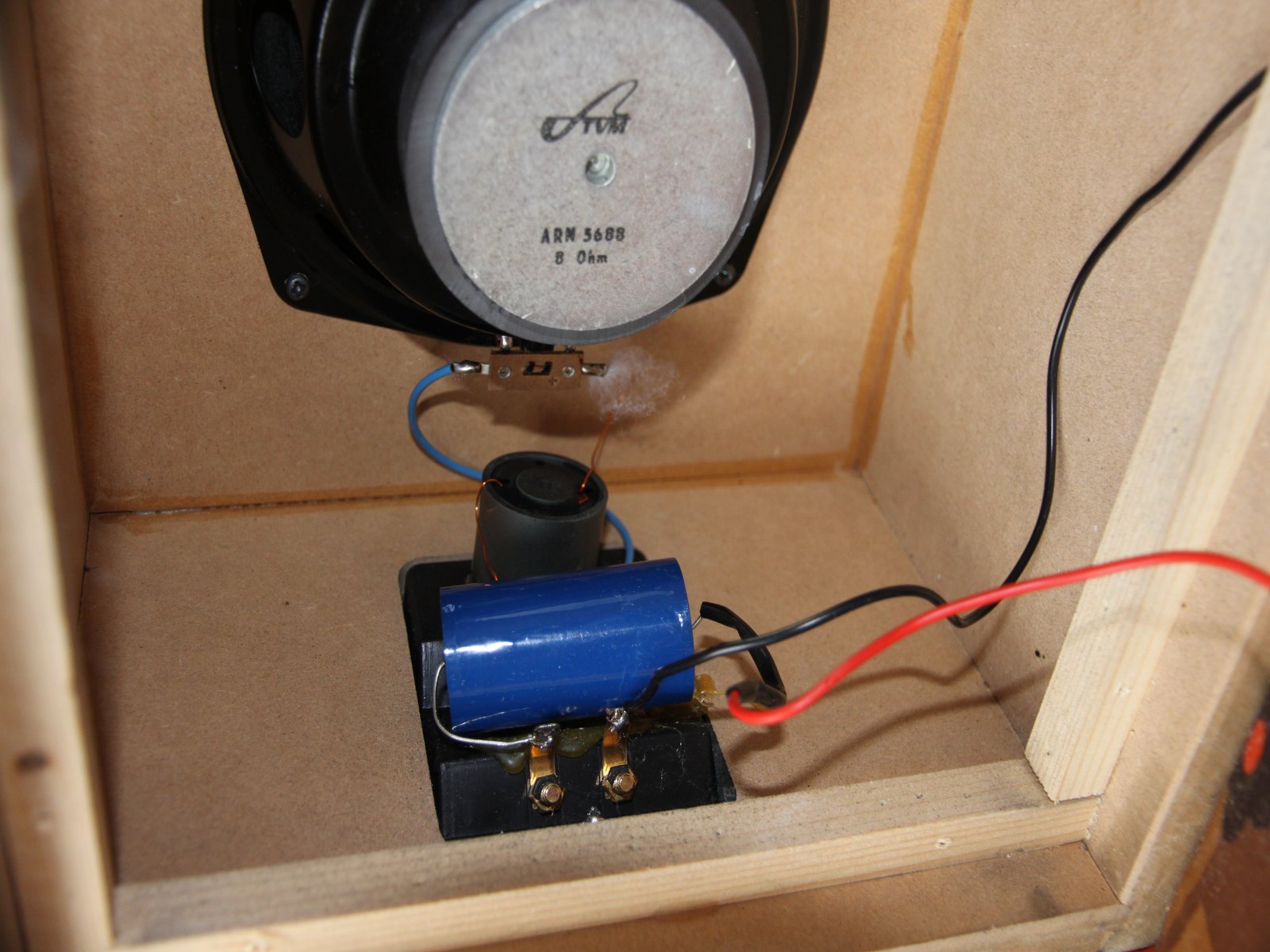

In the third image a picture of the crossover. You can see a fat capacitor and a coil. The capacitor doesn't seem original to me. Could it be a (useful ??) mod.

#1. The resistors on the wires are ok. Only the 2-4 wires in the center get all frequencies. The resistors do filter out heigh freqs. This is because the amp will not get burned by 0 ohm.... Kortsluiting....

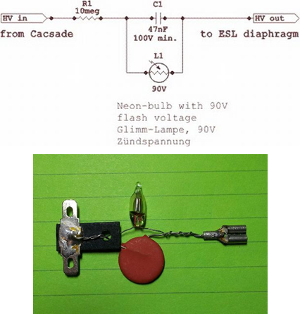

…I have read about incorporating a neon in the hv circuit to check for voltage leakage. Can someone tell me how ?
The neon bulb leakage indicator circuit is made up of a neon bulb in parallel with a 0.047uF capacitor.
It is placed in line between the output of the HV supply and the diaphragm.
In your case, you could cut the red wire leading to the diaphragm contact and insert the circuit there.
Alternatively, it could be inserted where the red wire connects to the HV board if that location is easier to work with.
Afaik, at the moment the neon bulb flashes the power supply is connected to the diaphragm.
Then in a fraction of a second the diaphragm is charged. Therefore a high flash rate is an indication of unwanted charge losses in other words: possible hv leakage !
I’m sure more knowledgable members have a more complete answer.
