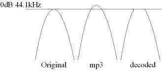

I don´t know about this Goldwave bug. A CD can´t store higher values than
the 44.1kHz spec defines !?
You mean clipping at the mastering point? Sadly more and more recordings
introduce this due to bad mastering to make the music feel louder 🙁
A good explanation:
http://www.prorec.com/prorec/articles.nsf/files/8A133F52D0FD71AB86256C2E005DAF1C
Here is what i mean with en/decoding:

You can find a tool doing replaygain here:
http://www.geocities.com/mp3gain/
When i encode an entire album i analyze all files and apply a constant gain to all songs to the point none of it clips anymore.

Hi Wombat,
Nope.. goldwave isn't buggy... it real in the data.. instantly wave-cut-off because Full-Scale is reached.. it is recorded like that!!!
Every, (yes every !) MP3 I open, I open not with a media-player of any kind, but with a sound analyzing program (Goldwave (standard) or Audacity or Matlab) , and I have never, (yes never !) seen a clipped MP3.
What software are you using for visualisation/encoding/decoding etc, Wombat ?
Kind regards,
Thijs

Hi Wombat,
I s does not depend on the recording offcoarse, but on de encoder/decoder. I have many mp3 recordings downloaded from the internet (properbly with encoded diffrently), but no clippping! So it must be an error in a your decoder? What decoder are you using... ?
can you give us an example of
WAV->encoded->decoded->clipping?
I really really have no examples in my music library...
Thijs

Where do you know from it doesn´t clip?
When you opened it in an editor it gets decoded in the way i described above. The higher peaks are not there anymore when you look at your waveform.
Did you try Mp3gain i linked to and tested the original mp3s for clipping?
A nice one was Rammsteins Mutter, it was released at the time we encountered these problems.
One Thread here with some:
http://www.hydrogenaudio.org/index.php?showtopic=7140&hl=
Wombat
Wombat
You can see it when you look at the transientwave form. I do this on default.
The original recording (on CD) you mean. I trust it clips here and there. But if you encode it (what encoder did you use), and then decode it (what decoder did you use), did it clip? Did it clip more? Did it not clip at all? Did it sometimes hit Full Scale but without cutting off the waveform?
To make my point: I can send you several MP3 without clipping (at least on using decoder), but I really can't send you any example of clipping after encoding/decoding. If I encounter such an example I will be convinced.
Thijs
I do this allways (default program to open MP3 is goldwave) and I see no waveforms being cut-off. So no clipping.When you opened it in an editor it gets decoded in the way i described above. The higher peaks are not there anymore when you look at your waveform.
I looked at it but decided that not every musical piece is intended to be equal loud. I trust the program does achieve it's goal fine, but I don't agree with the goal.Did you try Mp3gain i linked to and tested the original mp3s for clipping?
Thijs

Dear Wombat,
Now comes the fun part....
I read the link you provided and , allthough I find the explanation a bit quirky, understand quiet well what's going on... and got me really interested....
So I did my onw test.....
1] made a wav file containing quare wave (2Hz) ('metronome') using the Full Dynamic Range (mono, 5 sec, fs=44100Hz).
2] using LAME to encode to MP3 (setting = 'hifi' / 160kbps)
3] open the mp3-file with cold wave....
And.............😎
Behold ... (due to restricted bandwidth ?) the quare wave rings, and the ringing is clipped.... even if it is still a digital respresentation (NOT analog) .. it is clipped... I am confinced: it can happen.
I think this is not all ... there more to consider.. but I'll leave that for a nother time...
Cya,
Thijs😉
