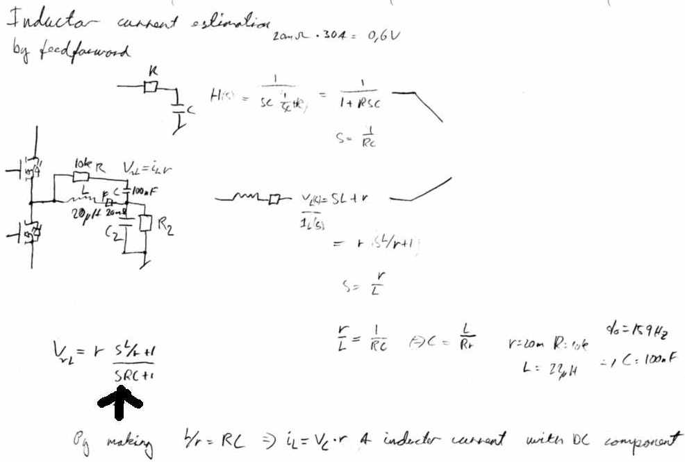

Btw. it's not easy to sense the current down to dc, with a resistor it has to be done differentially and with a very low offset, but it can be done. Instead of using a lead network as in the UCD, you could use feed-forward. I did that in
http://www.student.dtu.dk/~s042302/diy/Small-signal_modelling_of_self-oscillating.pdf
but I didn't explain that it could be used to sense the inductor current down to DC (assuming a series resistance in the inductor).
I've derived it in the following attachment if you can read it.
I can see that there's some oscillations in the step-response with Leap-Frog feedback gain constants. Have you tried pole-placement (Ackerman's formula, LQR etc.) to decide the feedback gain constants?
