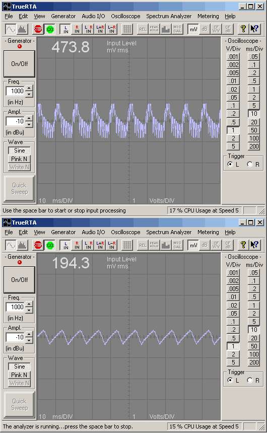

The soundcard preamp (in between the sound card and the amp's speaker outputs) is running off a 12V battery and isn't earthed. So the sheild on the rca lead leading from amp to sound card is earthed through the mains at both ends, but these are the only two earth points.
I just decided to measure the ripple on the PS. Not sure if this indicates I've stuffed something up, or maybe one of my PS caps is dud, but the difference between -ve and +ve rails is quite severe (could also be a result of whatever nastiness is going on with the right channel). The search continues :)
Test done as before in previous thread, with amp cranked to just before clipping, 1Khz signal as input, 7.5 Ohm load resistors.
edit: +ve rail is the top one.
edit: Also with no input signal the ripple on the -ve rail is about 33mV and on +ve is about 342mV. Something nasty going on here I think.
Tony.

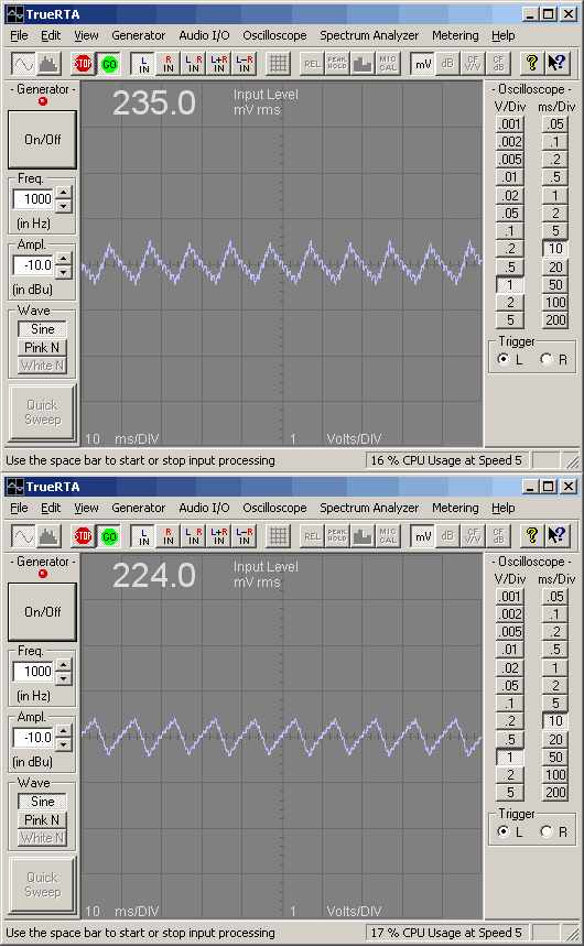

Well I've fixed the ripple problem. Though I really don't know what did it. All I did was test the PS without the amp connected virtually no ripple (like about 0.5 mV) same again with a 25W 240V bulb connected as a load (about 9mV ripple). A 25W 240V bulb is great for de-energising power supply caps BTW......
Then I connected each channel up in turn and tested with a load and both behaved nicely, finally I connected both channels back up and tested and the horrible ripple on the +ve rail went away. I can only guess I had a dud solder joint somewhere in the PS, and all the unsoldering and resoldering fixed it....... Pretty strange though since this ripple problem has been there through Two previous power supply rewirings......
Also today (after having to debug the input switching logic, which decided to die) I changed the earth wire back to running from the star point to the earth lug, and my distortion problem went away. I only did this as I was measuring voltages around the amp and found the supply rails were only registering 33V (instead of 63V) when I measured with the negative probe on the case. I was seeing no resistance between the case and 0V but that was the measurement. Could be that the lug I soldered to had a very slight resistance but I don't know. Anyway the distortion problem went away so I'm not going to complain.

Pic of PS ripple attached:
