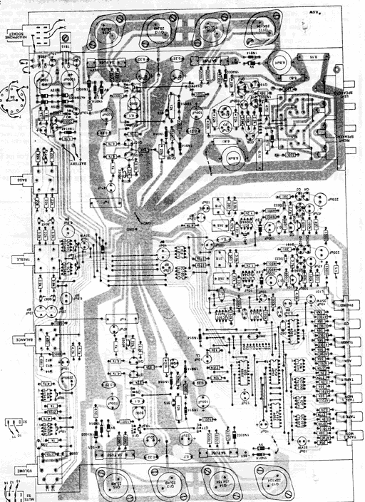

Attached is a scan of the circuit board layout showing the "star" earthing.

Hmmmmmmm...... The rectifier and filter caps are on the base of the chassis with the ground on the filter caps going to the chassis earth point and the star point on the circuit board goes to the same earth point. (not obvious from previous posts).
Wouldn't cutting the track (so there are no loops) and wiring back to that same chassis point be effectively the same thing as having the current flow through the circuit board and and then back through the wire, to the same point on the chassis? Or am I missing something fundamental here?

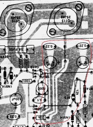

Just looking at the circuit board diagram, I think I have just spotted a loop in the main earthing!!! (although both branches end up back at the same point...... probably nothing but may be worth fixing 🙂
Tony.
edit: attached the bit I'm talking about circled.

Hmmmmm, I just rechecked the wiring diagram, and the main filter caps Ground is connected to the pcb ground then a separate wire runs from the pcb ground to the chasis....... Time for some experimenting me thinks...... :devilr:
Tony.

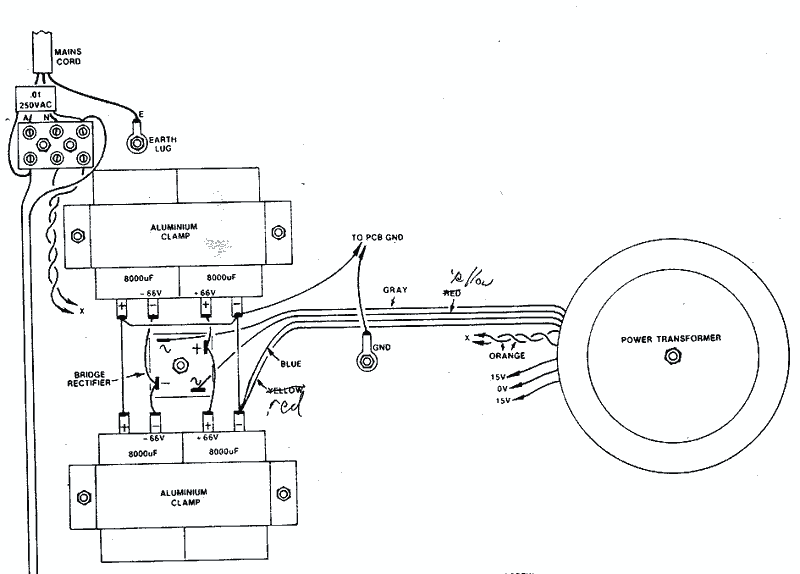

Ok here is a pic of the PS wiring (very basic PS)
1st I think I'll run the earth from the filter caps to chassis ground instead of the pcb?
2nd assuming point one is valid should I have a separate wire from each cap to the chassis ground rather than the way it is wired now?
3rd what's with the 0.01 uF cap wired accross the mains switch? is it to filter switch contact bounce?
4th should the transformer center tap go to the caps as shown or to the chassis?
hmmm I keep editing....
5th should the mains earth be to a separate point on the chasis to the main ground point?

changed the filter caps ground wire
Ok I simply removed the lead from the caps to the star ground on the pcb, shortened the lead significantly and soldered it direct to the chassis earth lug. Didn't change anything else.
The result? Better noise performance especially over 4Khz! and slightly better distortion performance (but I suspect that this is simply due to the lower noise since the test tone is 1Khz and there were noise peaks at 2Khz, 3Khz, 4Khz etc).
Note that I also shortened the leads I had running to my load resistors from about 3M to about 10cm, I tested before and after doing this and the only change was that the crosstalk improved by about 6db.

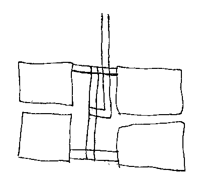

The existing ground (chassis connection) is not the star point.
The star point is on the PCB and should connected via heavy
wire to the centre point (OV) of the power supply capacitors.
Heavy connections for the +/- rails will reduce rail ripple.
All the P.S. wiring should be heavy duty,
especially to and from the diode bridge.
The case should be connected to mains earth at the mains input.
The earth lug is correct.
The ground lug should be disconnected.
Asumming the case is single insulated mains earth and the star
point will now be not connected, but the amplifier works.
The case is connected to the star point with a short link to
the single ground return track next to the phono socket.
No extra operating currents will flow through the ground return.
(P.S. does your PC have a two wire or 3 wire mains connection ?)
🙂 sreten.

I wired up the 0V wiring on the caps as in the diagram thinking this should be better than the existing way. Should I put the ceter tap from the transformer to the centre of the 0V wiring or directly onto one of the caps? I'm leaning towards directly to a cap at the moment (its currently on the gnd lug)......
