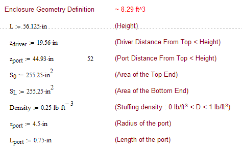

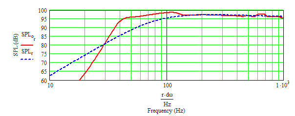

The Purple speaker: an $18, 8" fullrange!
This too big?
GM
No, I just 'run the numbers' for folks. You can make it square, though theoretically a golden or acoustic ratio is better to average out its Eigenmodes to make them easier to damp: 12.56" x 20.32", 13.5" x 18.9", 14.18" x 18", 13.17" x 19.38" to list a few.
