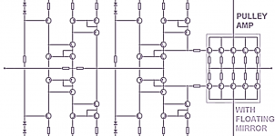

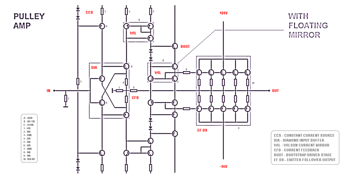

The Pulley amplifier - Wilson mirror
this original project it's based on Wilson current mirror
applied to the driving stage :shhh:
the forefront of science should not keep secrets :)
then it's possible apply the same concept on input
so have floating reference fo EF input
