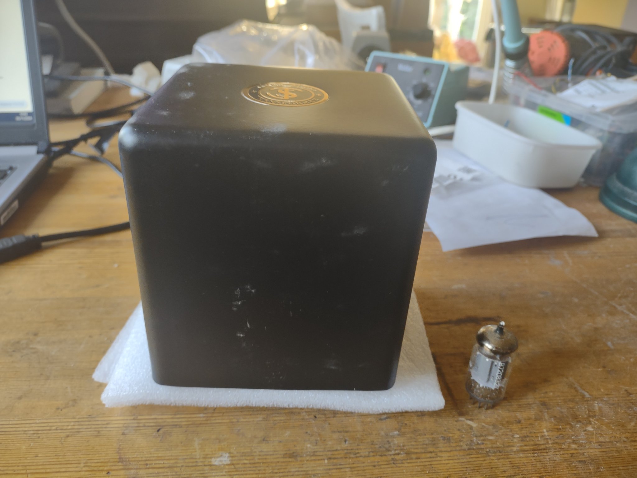

I have recently bought some quality SE OPTs that are 600R primary impedance. The thinking was that I could use 4 x EL86 in parallel with them since they are rated for 350mA current. EL86 is a high current low voltage EL84 and usually has 2.5K as plate load, so 4 in parallel matches well with the OPTs for impedance and current.

The OPTs are designed for 6C33, but I have a shed load of PL84 tubes, so thought it could be an interesting experiment.

Now I need to clear the decks a bit and do some planning. The transformers are auction finds, so did not break the bank, but are huge. The PSU isn't too demanding with TV tubes. I have some 70V 100VA toroids, so a doubler for the output tubes and an extra section to make a trippler for some head room for the driver and gain stage.
I get stuck with the finishing details in my previous projects, plus like to make the builds compact which requires a lot of planning. This wiill be a breadboard so I can experiment, but looking at those transformers maybe it needs to be a butchers block :-/
