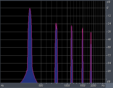

Here is spectrum of 375Hz fundamental with:
- H2 -22dB
- H3 -26dB
- H4 -30dB
- H5 -37dB
Attached is wave file with above construction on left channel; pure 375Hz on right. I'm sure HD850 will allow you to tell the difference.

Your file is nice, but it's the original spectrum, not the final one produced by the amp and speakers/headphones. That's what counts.
Function of the ear? Mine apparently function quite well; The distorted version of the 375Hz tone sounds like crap. I changed phasing of harmonics; still sounds like crap. I changed fundamental between 200-1200Hz. All sound like crap.
Any real circuit that forms harmonic structure like this:
- H2 -22dB
- H3 -26dB
- H4 -30dB
- H5 -37dB
In any portion of its bandwidth is a crappy circuit.
If all the signals pass through driver with harmonic distortion as above, telling the difference between clean v dirty becomes very difficult. The majority of compression drivers exhibit distortion profiles not unlike the above.
If point of reference is high distortion amplifier playing through very good driver, then performance of high distortion speaker is perceived as less distorted than it really is.
