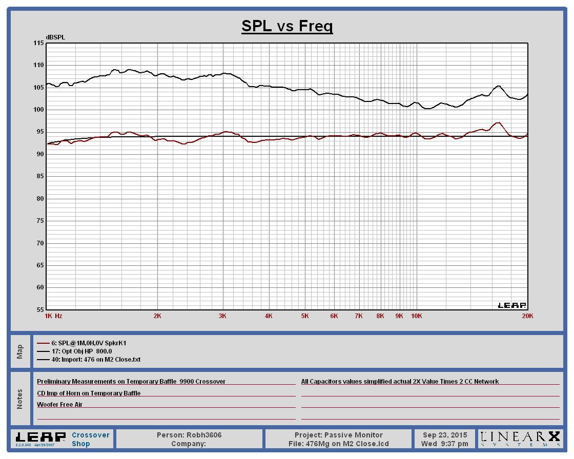

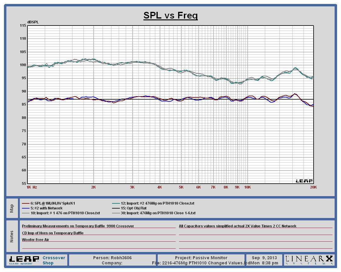

Are we really sure that horns and waveguides don't color the sound in subtle ways that are hard to measure? I recently discovered this excellent resource on horns/waveguides and the factors that can affect their sound: Factors Affecting Sonic Quality of Mid & HF Horns & Waveguides
Yeah I remember that glad you posted it but that was many years ago. One of the biggest issues was the periodic ripple in the responses you would see. If you look at either the DSP for the M2 or just a measurement of a compression driver on that horn you don't see that. There is definitely improvement in that respect. I have measurements of the M2 and a JBL S/R waveguide and they look quite smooth in comparison to some of the other horns referenced with the exception being Earls Oblate Spheroid in the original posting. So I am not to sure this is what was heard and the difference between them.

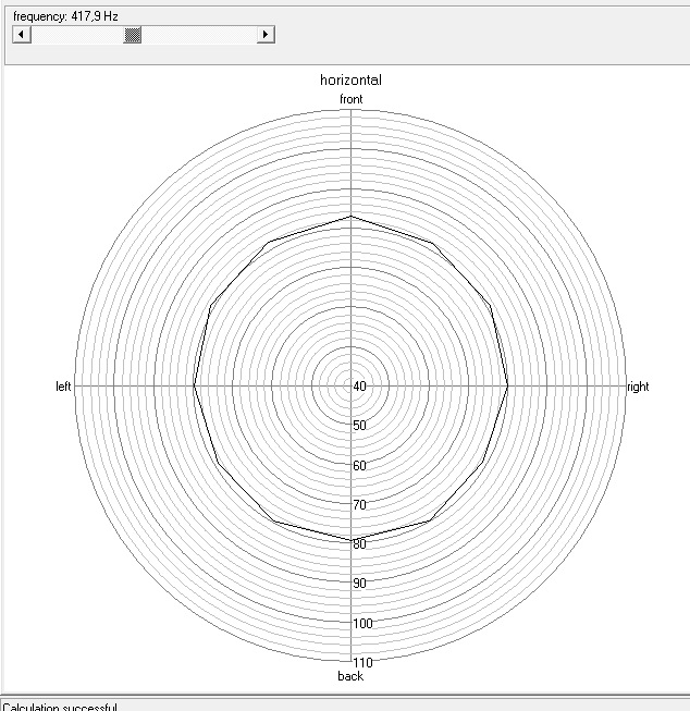

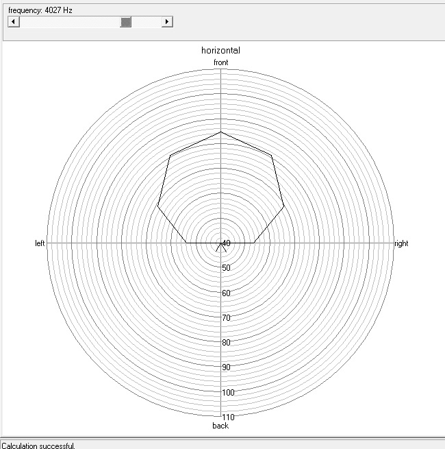

It could be useful play with a simulator.
A driver radiates in the whole space, wavelenghts long compared to the baffle.
It radiates high frequencies in half space. In beetween it's a mess.
Two images: a box 30cm wide, radiates 400 and 4000 Hz
It is possible to create any directivity at any frequency. It isn't always easy.
