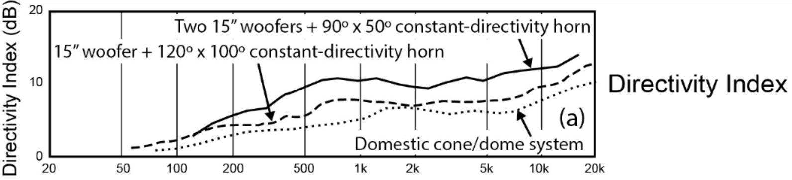

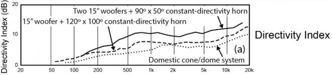

The 2 x 15" with 90 x 50 waveguide is the JBL 4722, which I use. The single 15" with 120 x 100 waveguide is the M2 and the cone and dome is the Salon2. From: https://www.avsforum.com/forum/89-s...iewed-speakers-ever-made-10.html#post54613040

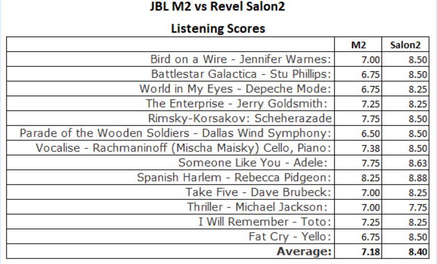

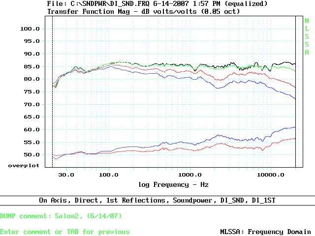

The M2 and Salon2 are close in directivity, yet the Salon2 is the preferred speaker, at least in the shootout thread. Listening scores with 6 participants:
And comments like this from one of the participants seem to confirm that it is about the directivity:
"My assumption/guess is mainly due to dispersion pattern and room interaction. The controlled directivity of the M2 will likely minimize that of early reflections in the room. The Salon2 would likely energize the room since its directivity control is dictated by the driver size. How else could one provide the perceived difference in spaciousness in a test like this?
My biggest take away is that Toole is likely right about people preferring certain types and amounts of reflections based on the recording. The M2 seemed to be preferred on the same tracks by our group. The Salon2 was preferred on the others. As shown by John, the track list provided a good amount of variation. I do not consider this test as a definitive statement. The next logical would be to do the same as a stereo pairing as this will bring some more of the room into the equation. Either way, this was a great experiment and one that I hope can become more common."

The simplest answer to me is that even though both Harman products use the same power response target, neither achieves it exactly, so we should not expect them to sound the same. And look at where they differ. One has a bump @ 1.8khz while the other has a dip, similar also @ 750hz. These are in the heart of the midrange, so I would imagine the differences are audible. And the Revel looks overall a bit smoother through this area so perhaps that is where the higher preference lay?
It seems to that many of the Harman speakers generally aim for a relatively constant or else smoothly changing directivity index between 500-700 Hz and 7-8 kHz. The JBL speakers seem to have a higher directivity index than the Revel ones, as shown in the various figures posted in this thread, but it was interesting to me that Toole's book included the sentences "When they are put against each other in double-blind tests, the audible differences are small, somewhat program dependent, and listener ratings tend to vary slightly and randomly around a high number. In the end there may be no absolute winner that is revealed with any statistical confidence; the differences in opinion are of the same size as those that could occur by chance." This must have been in one of the Harman listening rooms, possibly the reference one that I recall having a very even/consistent RT across the frequency spectrum.

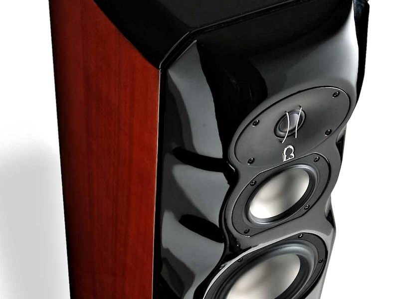

A newer Revel speaker is the F228Be, which has an extremely smoothly changing directivity index: Revel Owners Thread - Page 407 - AVS Forum | Home Theater Discussions And Reviews. Interestingly, I believe that Kevin Voecks posted in AVS Forum that Revel's listening tests still have the Salon 2 as the top performer, which I believe that he related in part to the very low diffraction enclosure for the smaller drivers, due to the round-overs.
It does seem to fit that the higher DI speakers may be preferred in certain contexts (audio professionals or studio engineers, good recordings with recorded natural ambiance, etc) and the lower DI speakers in others (listening for enjoyment, the majority of commercial recordings with close-miking, more reverberant listening spaces).
