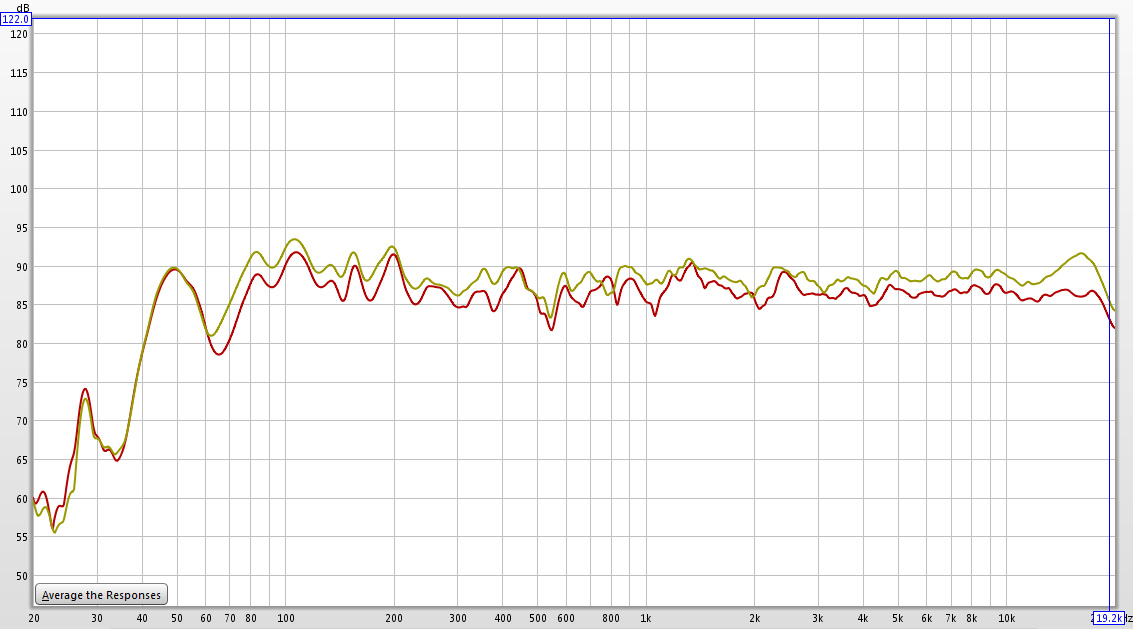

1) Possibly the best example is this: at AVS Forum, two speakers which both share nearly identical response were evaluated. Despite one having more headroom, the direct radiator was preferred. The speakers were Revel Salon versus JBL M2, both Harman products and designed with the same target criteria : Speaker Shootout - two of the most accurate and well reviewed speakers ever made - AVS Forum | Home Theater Discussions And Reviews

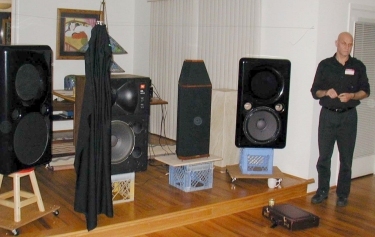

2) I did my own dumb version of the above test. At the CES this year, I listened to the JBL 4367 back-to-back with a number of Revel speakers, including the Salon. My conclusion was that the Revel speakers have dynamics that are surprisingly competitive with the 4367, while creating a soundstage that was bigger and more diffuse. Similar to the SH50 versus Vandersteen thing, the direct radiator speaker was not as 'pinpoint' but the additional reflections in the room created a euphonic and pleasant ambience. If cost was no factor, I might consider the JBL, but the inexpensive Revel is a third of the price.
DSC03693 by Gary Eickmeier, on Flickr

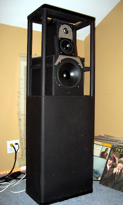

Back when I was a bachelor, I tried my Summas all over the house. Everywhere from the living room to the TV room to the main floor. At one point I had a crazy looking set up, where these giant loudspeakers were about three feet from my head.
Similar to this. Looks silly, images great.

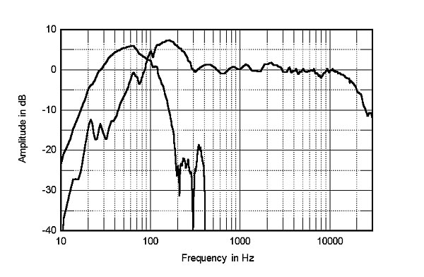

Infinity PFR, designed by Andrew Jones, anechoic response on tweeter axis at 50", averaged across 30° horizontal window (1996)
Revel Ultima Salon2, designed by Kevin Voecks, anechoic response without grille on listening axis at 50", averaged across 30° horizontal window (2008)
JBL 1400 Array, designed by Greg Timbers, anechoic response on tweeter axis at 50", averaged across 30° horizontal window
JBL LSR305 polars from JBL
JBL LSR305, frequency response measurement from noaudiophile.com
If you look at the JBL, Infinity and Revel measurements, going back to the 90s, a clear pattern emerges:

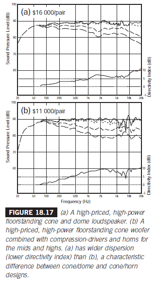

Patrick, I don't think that's quite right.
I have attached the image from page 399 of the previous edition of Floyd Toole's Sound Reproduction. I'm virtually positive that Speaker A is the Revel Salon 2 and Speaker B is the JBL Array 1400. The bottom dotted curves show the power response. I believe that it would be accurate to say that Harman seems to aim for a similar listening window curve for their speakers. Stereophile's measurements usually include a sentence like "the broad rise in output in the upper bass will be mainly due to the nearfield measurement technique" (from Salon 2).
Interesting, thank you!
