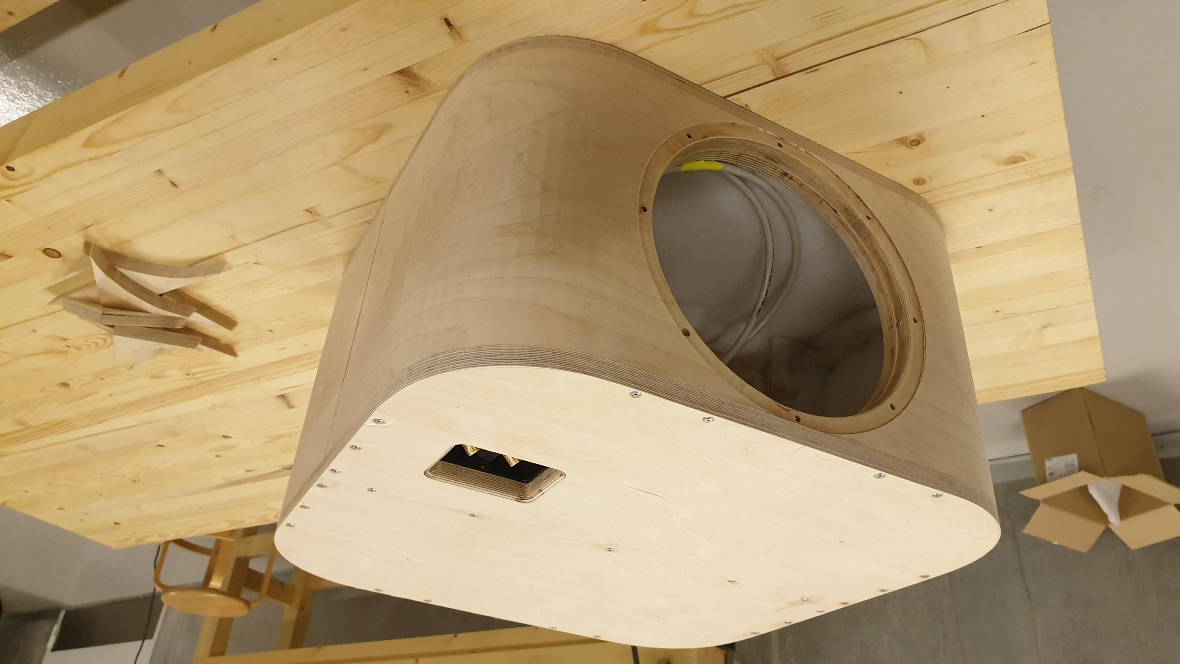

I have designed and am in the process of gathering the materials for my WAF friendly Pouf subwoofer.
This will be a dual opposed 12" sealed, passive sub, DO mainly because i don't want vibrations in my feet or cabinet vibrations traveling to my neighbors.
I got a deal on 2 lightly used (allegedly) Eminence LAB12 drivers, so those are locked.
I modeled the design in 3D and adjusted the size of the box to end up around 85L netto using boxNotes, which gives a Qtc of 0.76 in WinISD.
I end up having 35hz at -6db with I believe is fine for my hybrid HT living room.
I will be building the box myself, but the upholstry is something I may be getting a professional to do, as it is outside my comfort zone.

I've attached my 3D drawing of the design and an exploded view.
The transparent designs are only size comparisons to commercial Poufs that are wife approved.
As this is my first sub build I'd greatly appreciate if anyone sees anything I should consider before I start building!

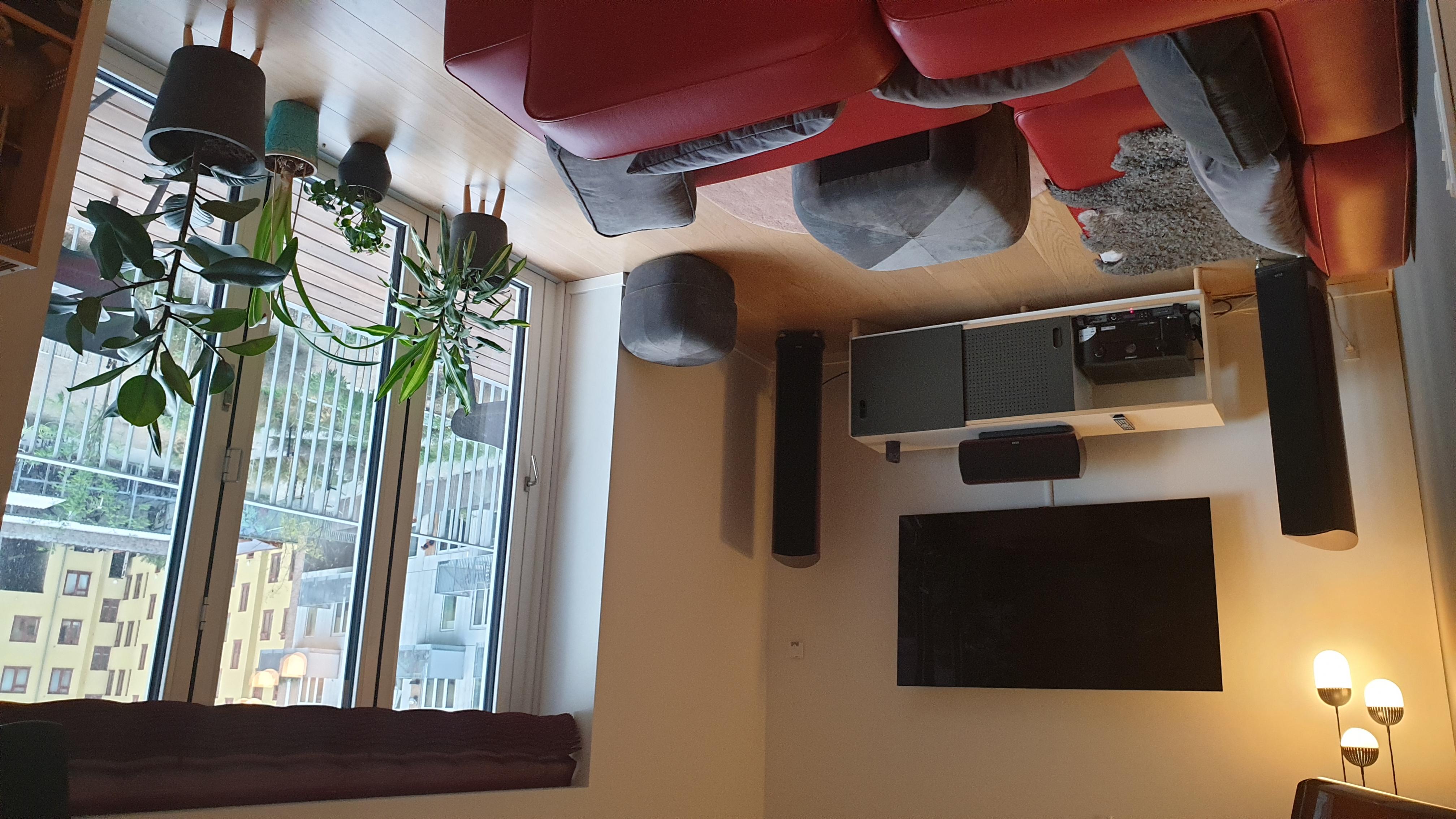

Your room looks like you live in a Copenhagen apartment, so quite small room? Often they have soft walls making bass sound better than the old swedish concrete bunker apartments...
Having a subwoofer in the middle of a room can be difficult. Have you tested that 2x12" sealed gives you the SPL you are looking for? Wall placement vs middle of room placement are very different.
Hi Johnny, thanks for chiming in.
You are right, it's in Copenhagen, it's an appartment building from 2018, entirely concrete on outside walls, ply + drywall inside, including one wall next to the sofa. The appartment is 95 sqm with an L shaped space for kitchen, dining space and TV area.
The TV-area is 3 meter at the screen wall, 3.6M on the side and open at the back to dining+kitchen.
The good news is that the appartment is extremely well insulated, when neighbours or us have a loud party on occasion it it completely inaudible, but let's see if that hold with a sub in the mix 🙂
I am not looking for maximum SPL, just enough to give movies a solid bottom, and most of all WAF. I'm hoping the fact that it will be near-field will reduce the need for precision placement, I could be wrong though. One driver will be aimed directly at the well polstered leather couch, I'm guessing that will dampen one side quite a bit, it'll be interesting to see what that means over all.
The amp I got has some nice DSP built in, so I should be able to compensate for some of the issues I'm inviting.
Yeah, lot's of guesswork and wishful thinking, It may just end up being an expensive learning experience, I wont know until I try, right!

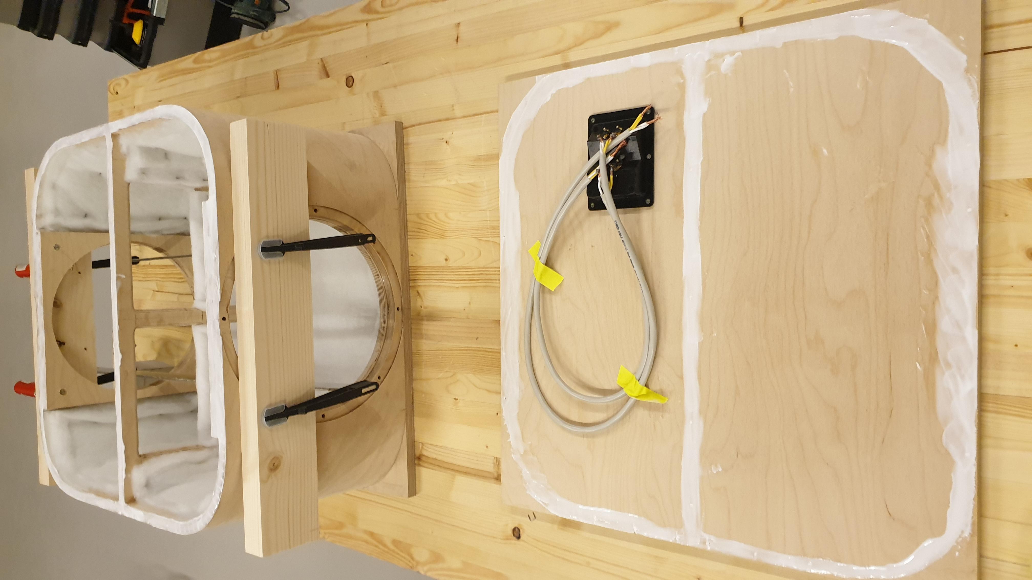

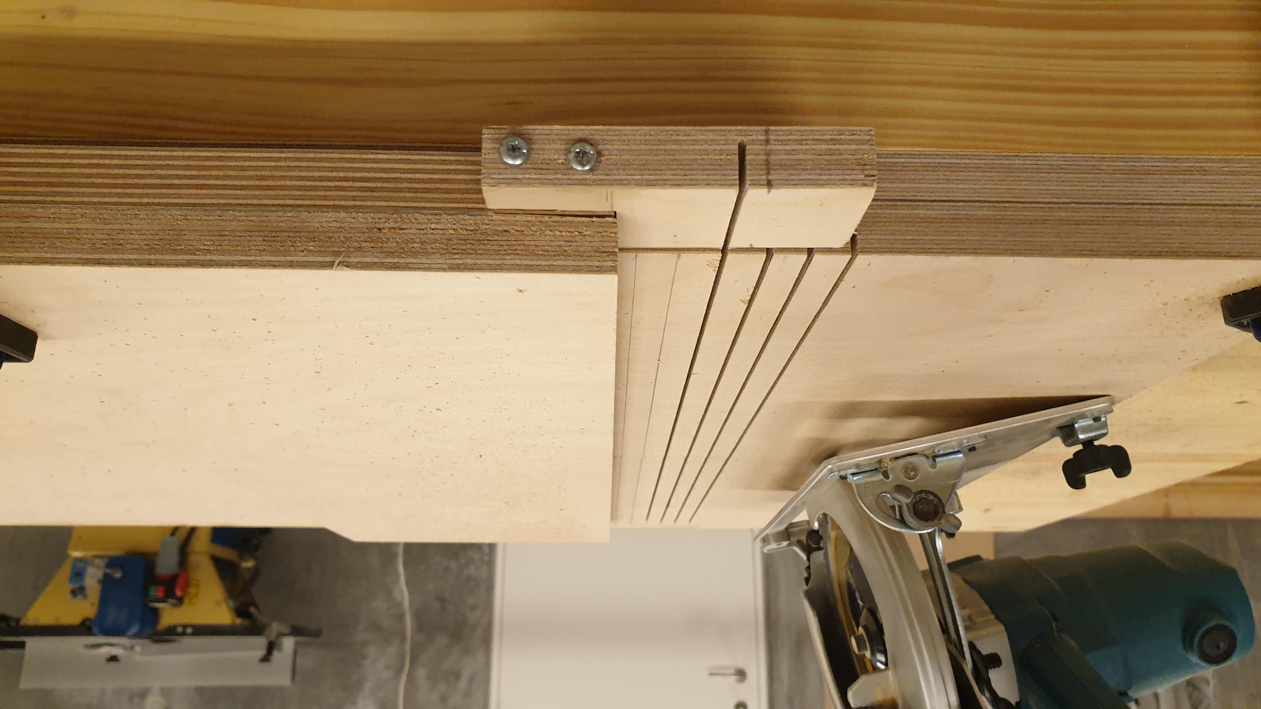

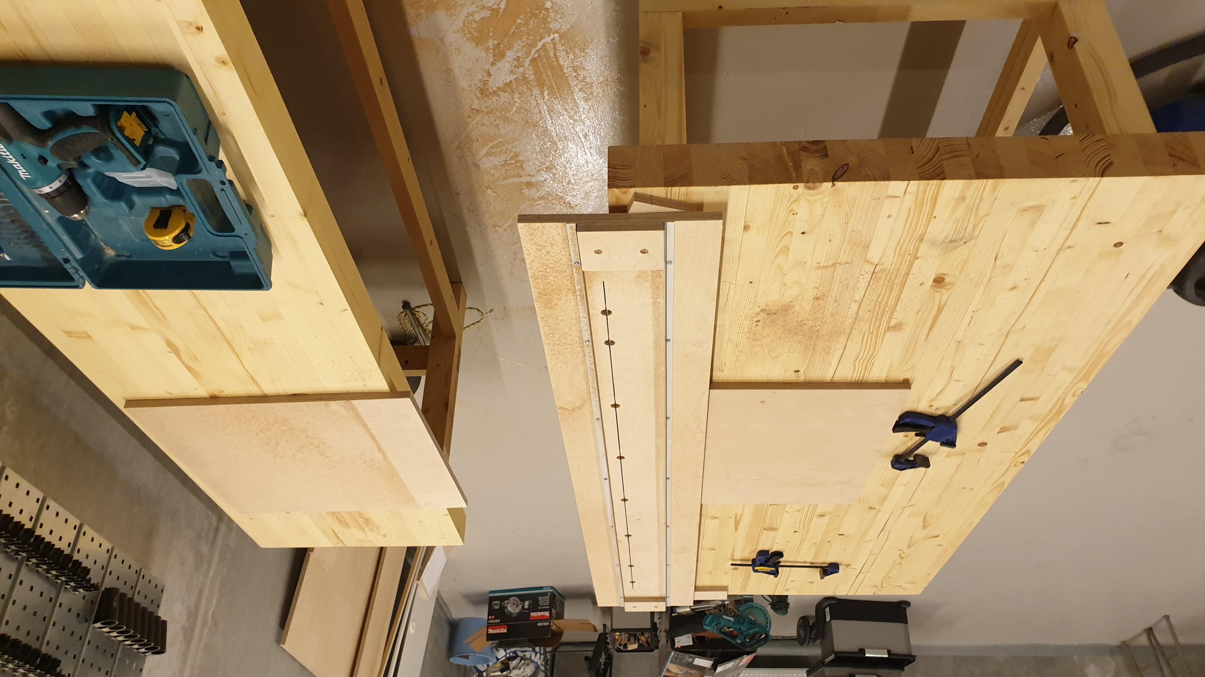

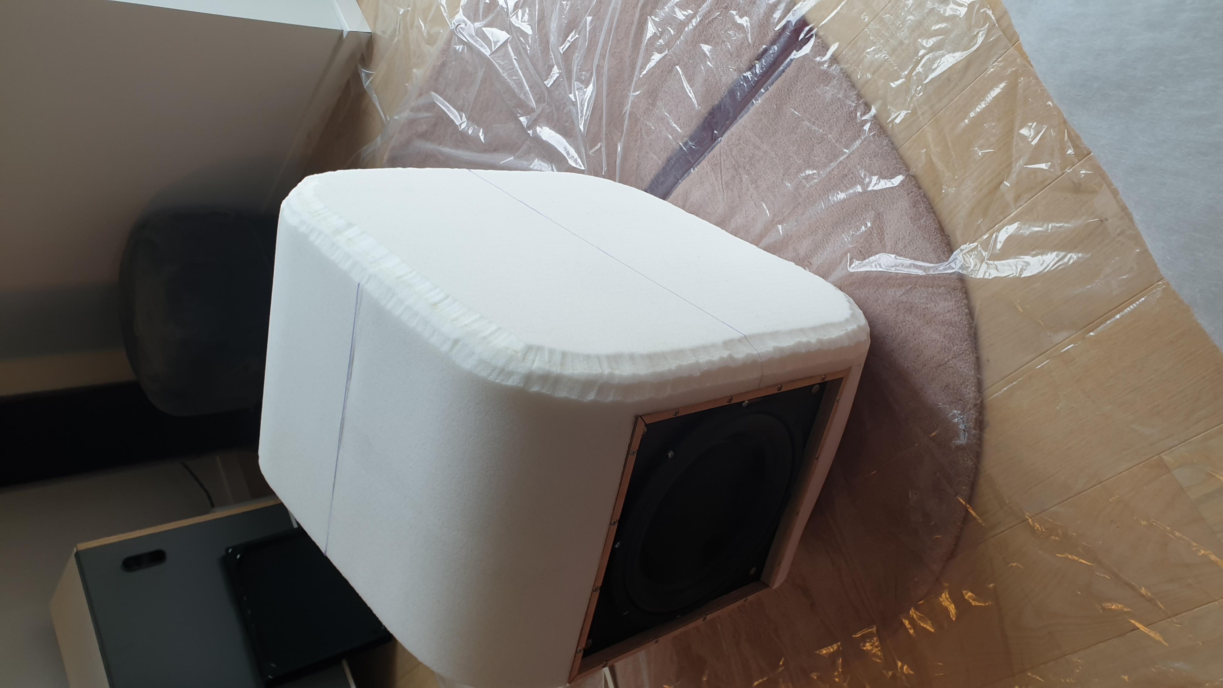

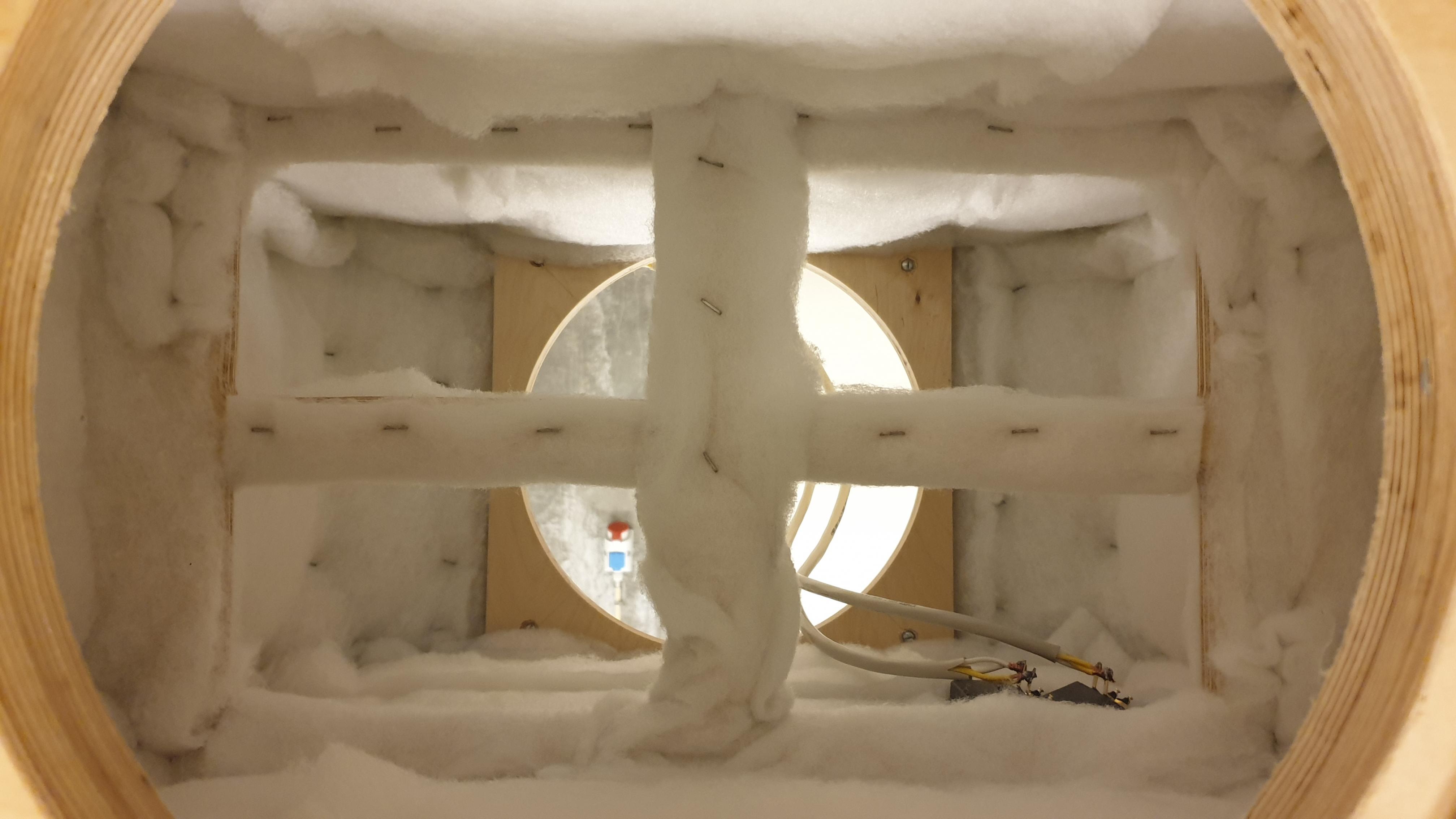

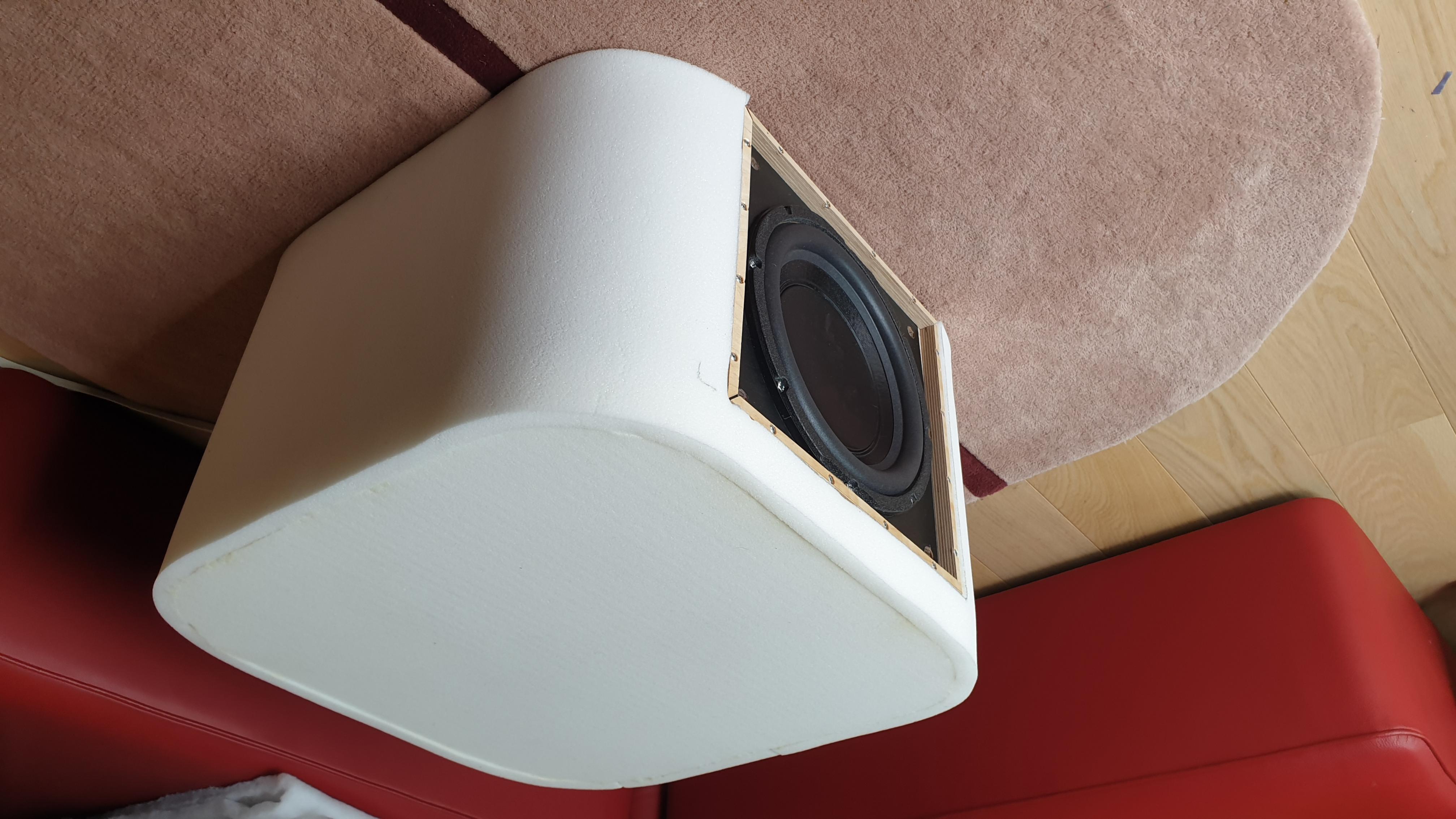

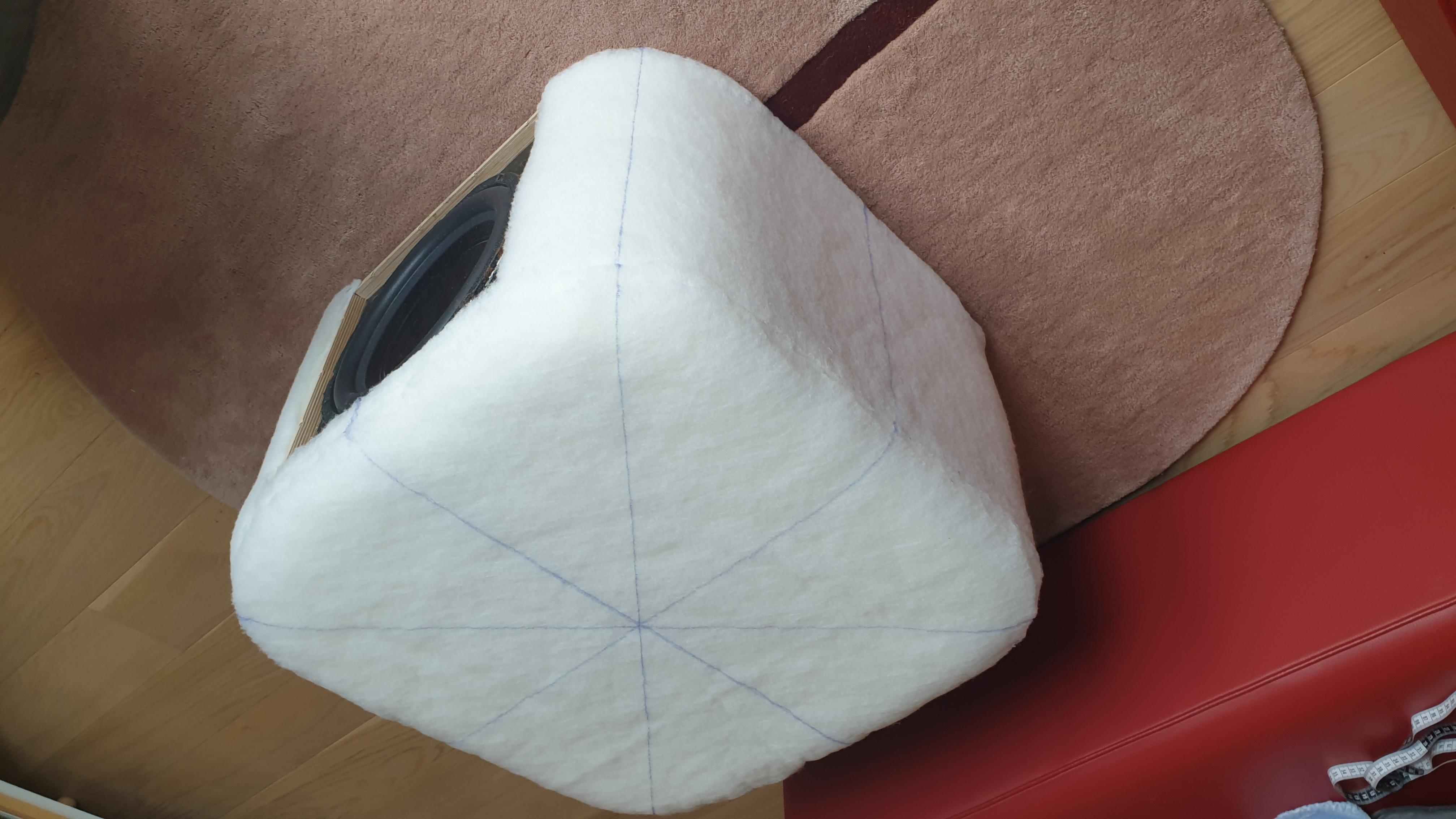

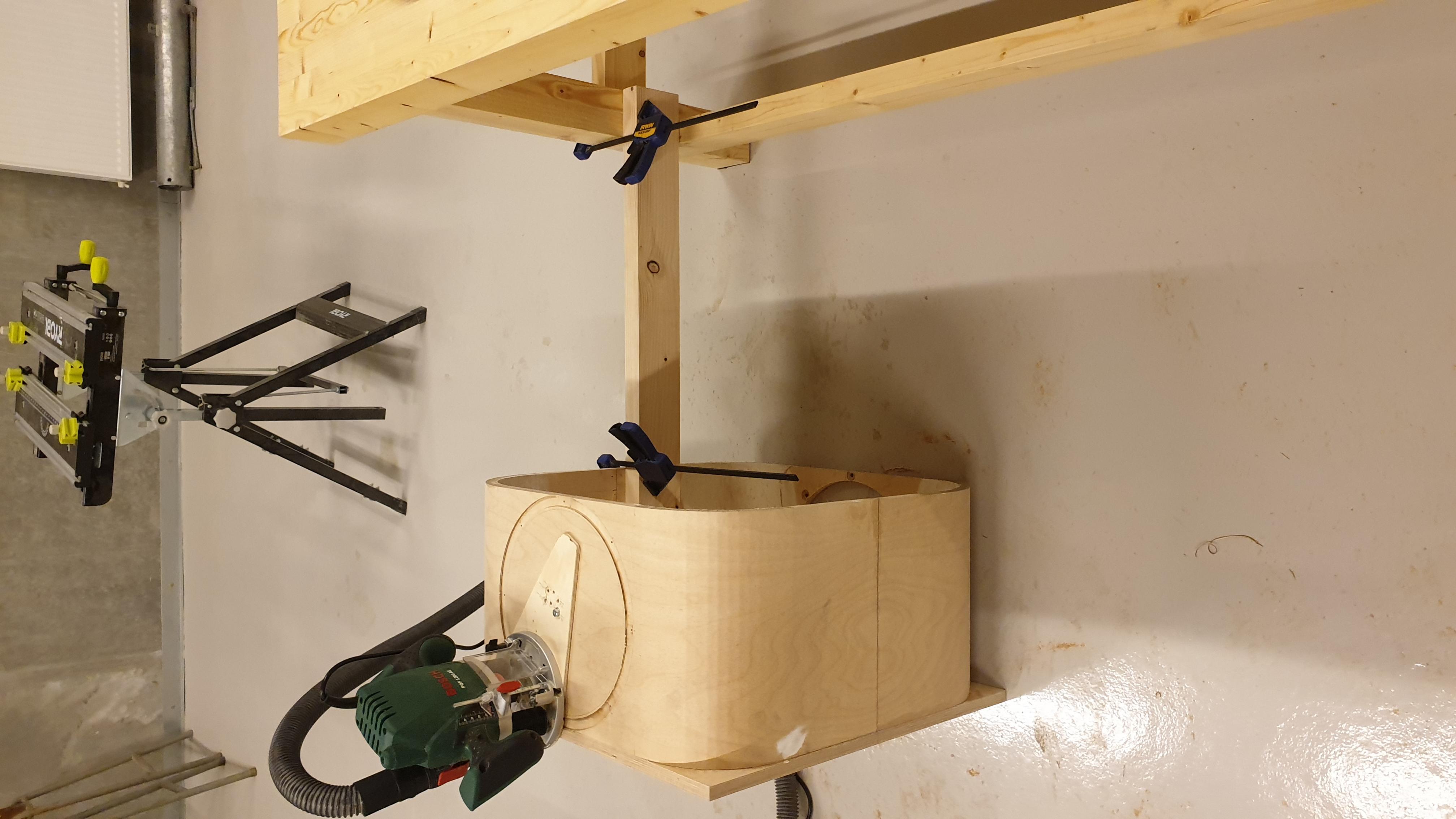

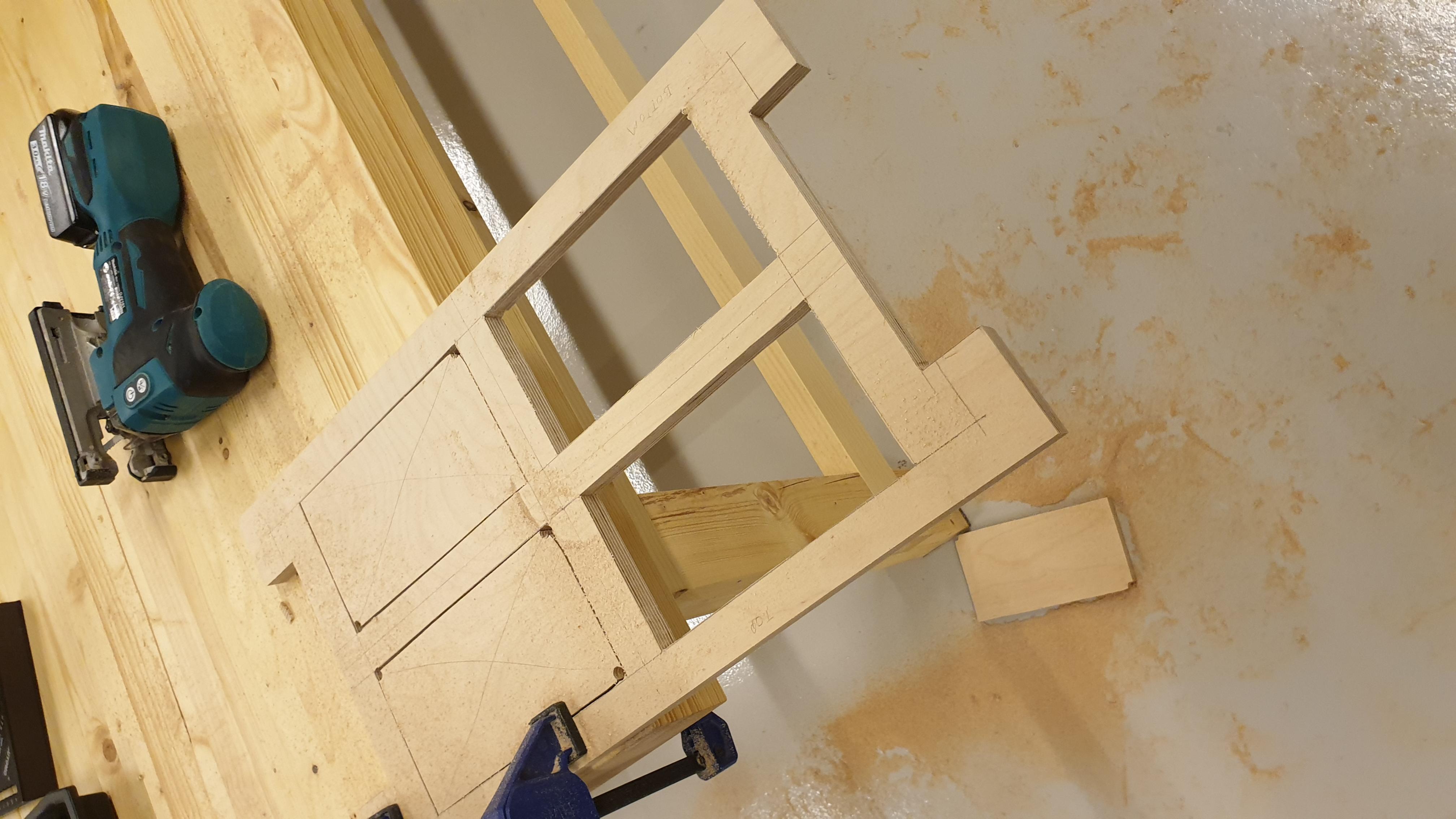

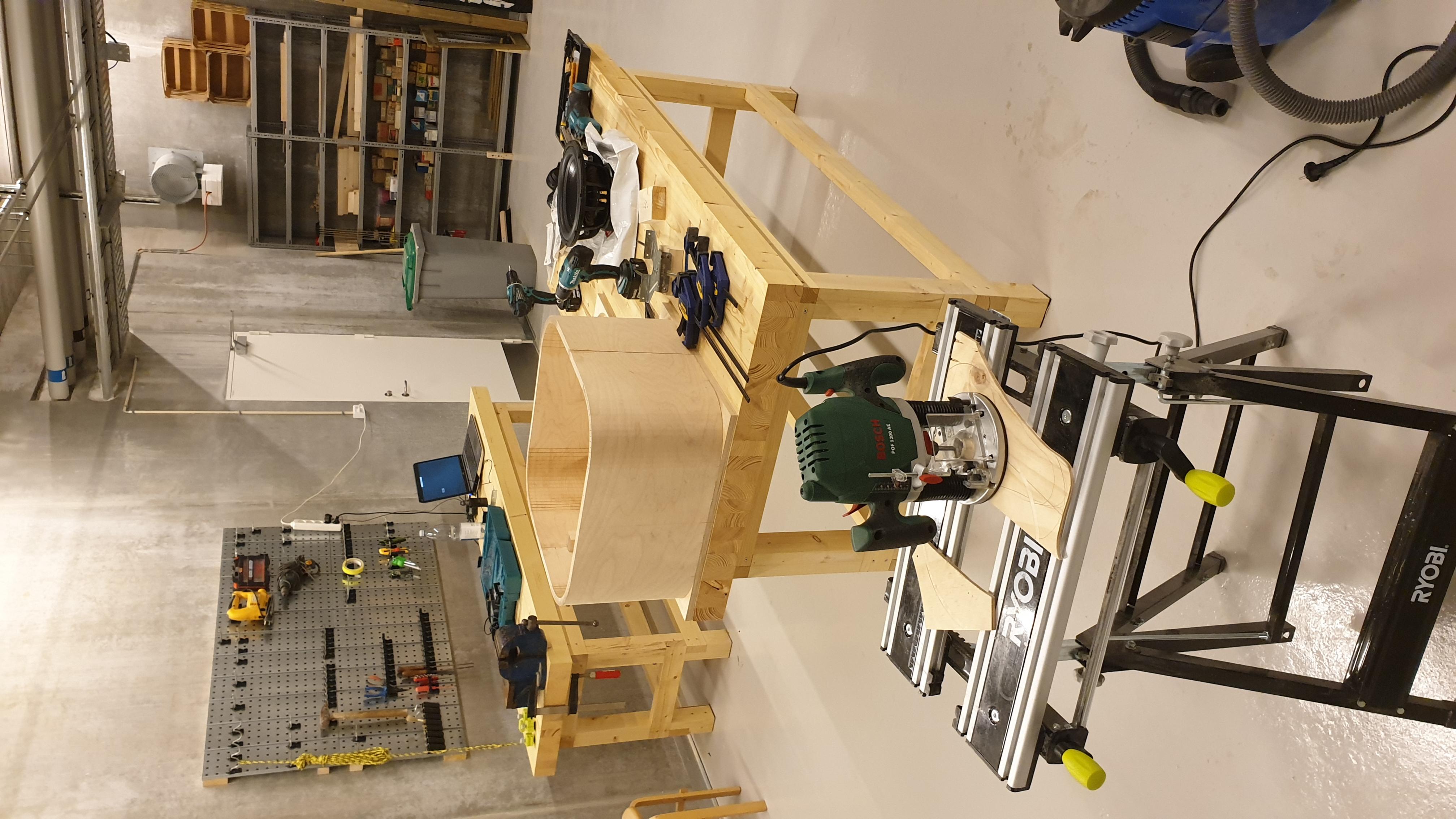

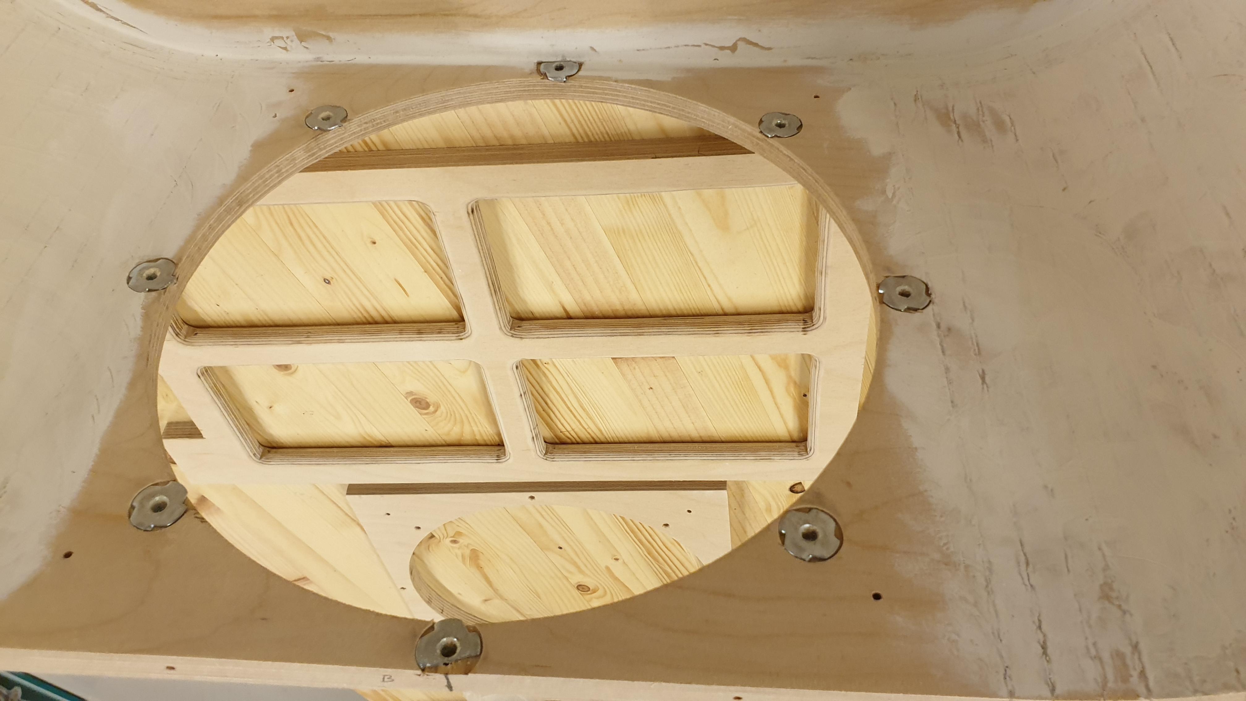

I finally finished the Powerpouf, and i'm quite pleased with the appearance and sound.
This post has the box build, next post will have some upholstry pics and a REW measurement (var smoothing).

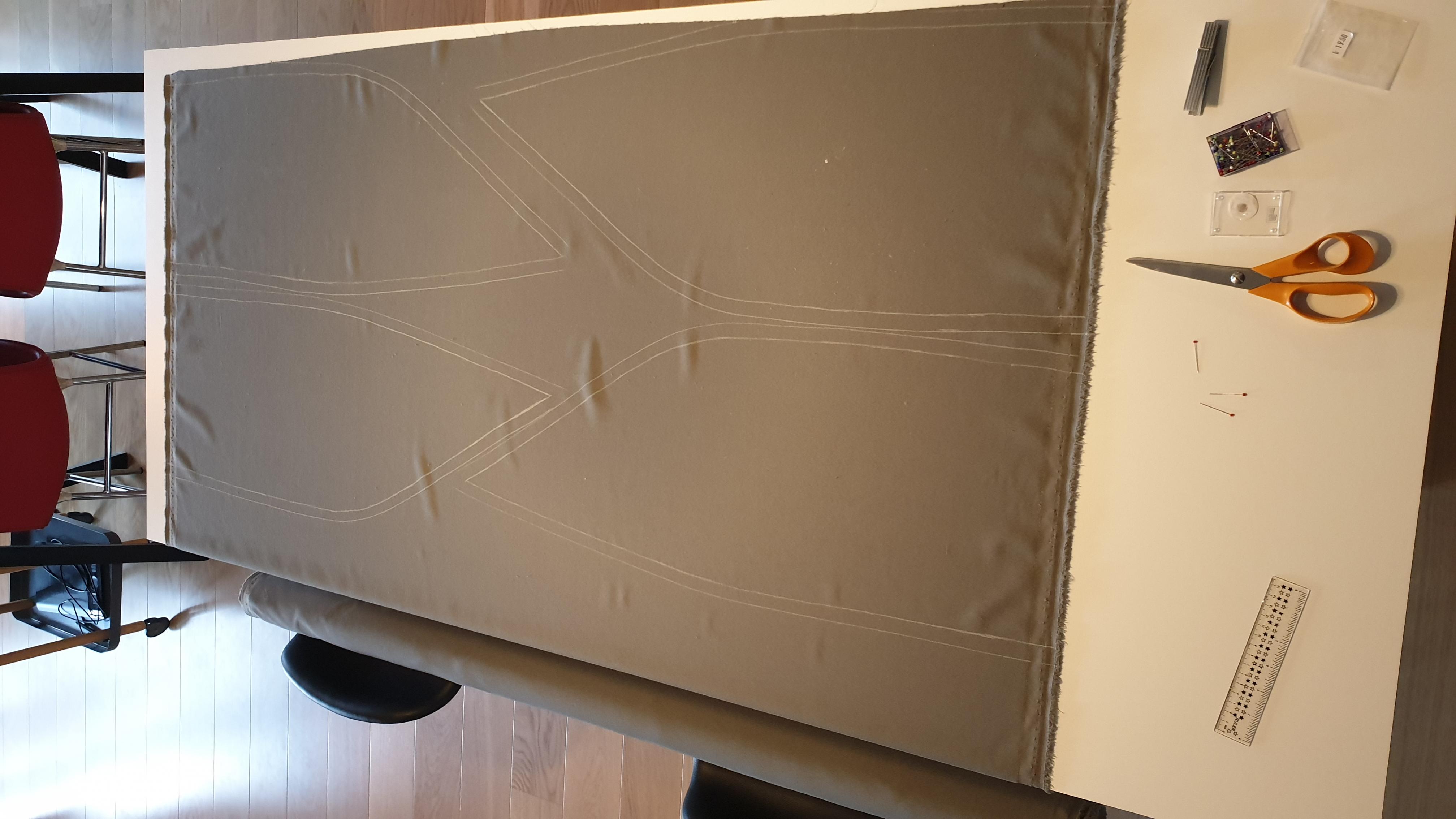

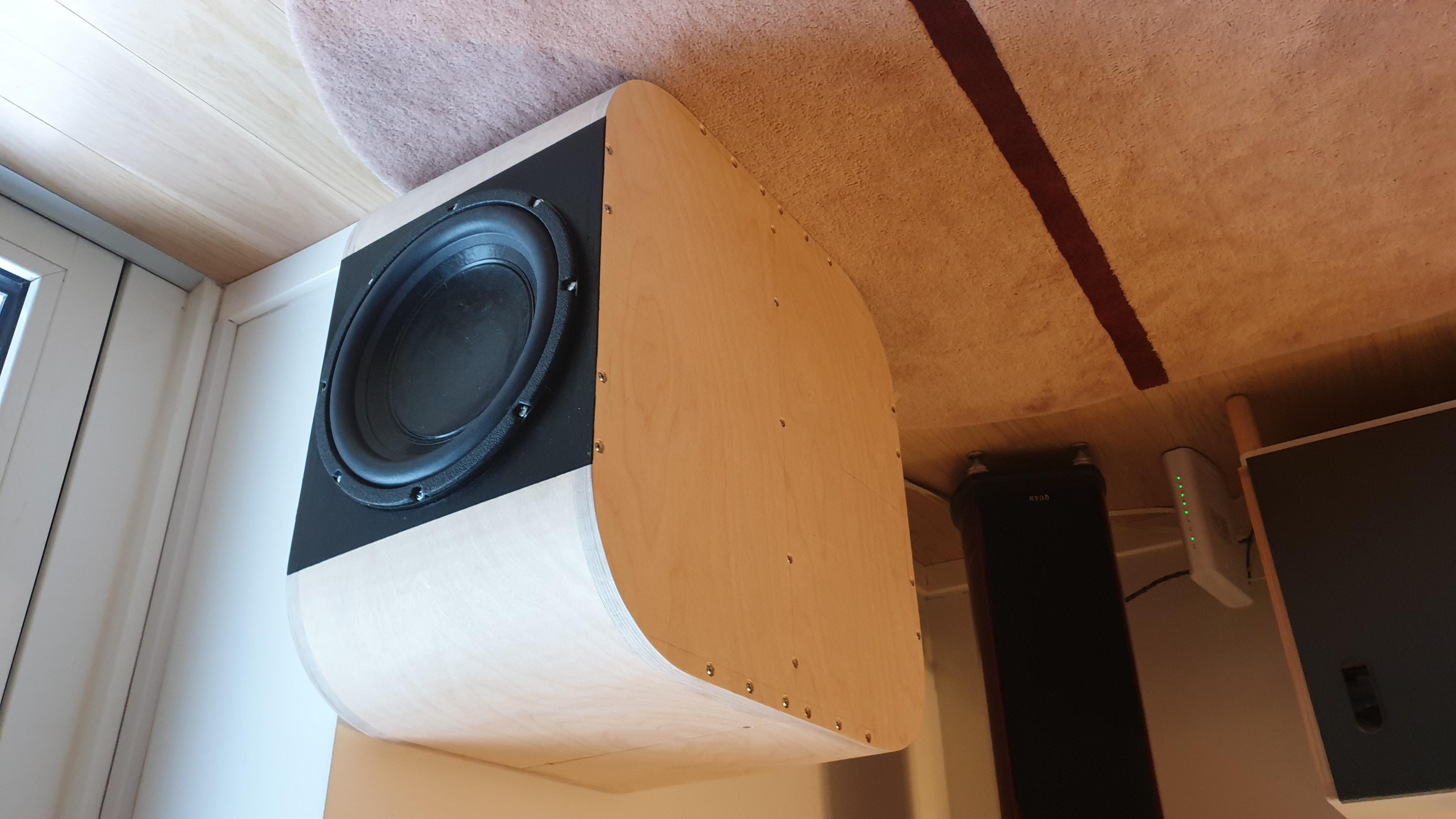

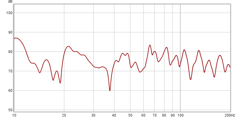

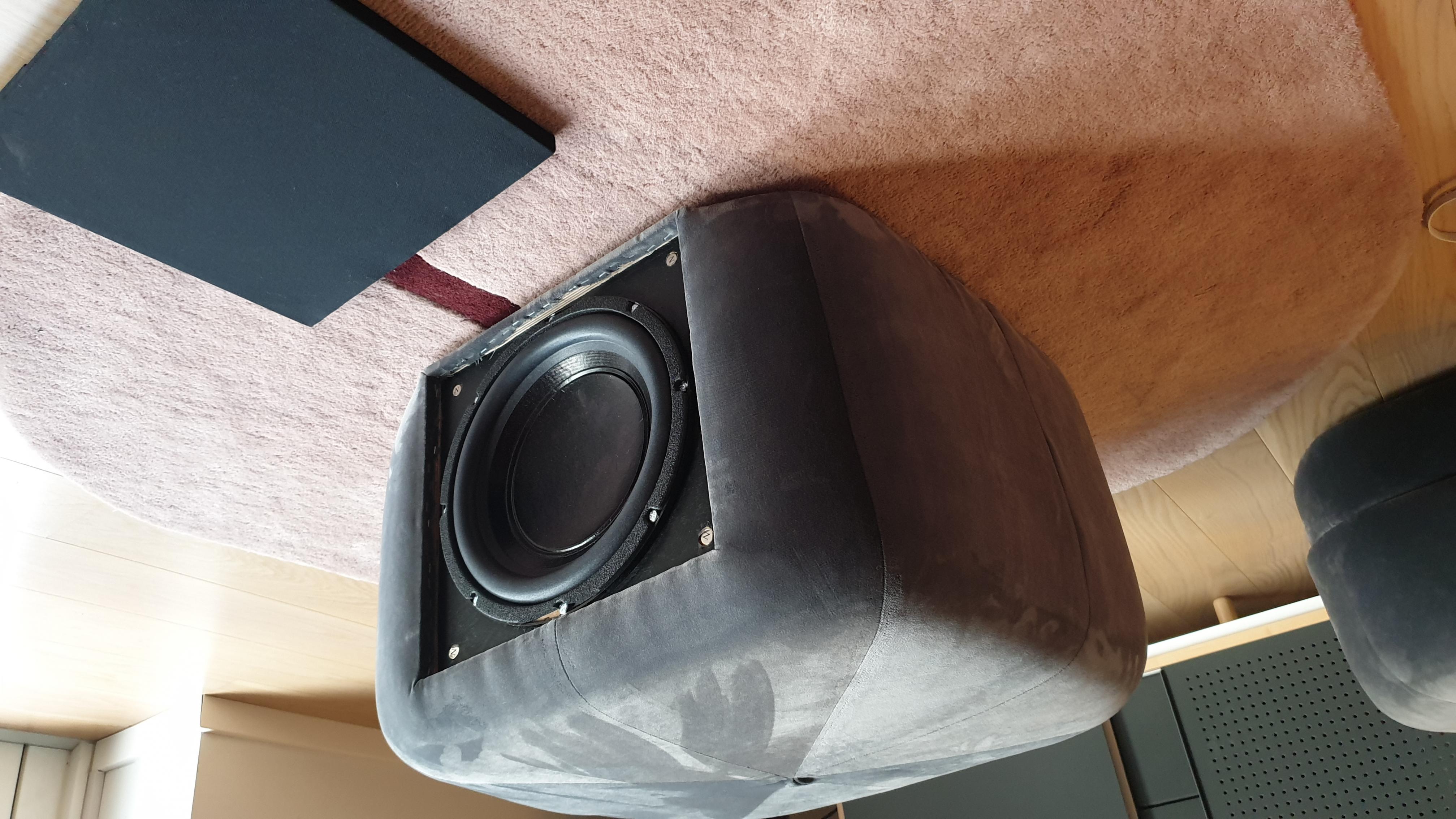

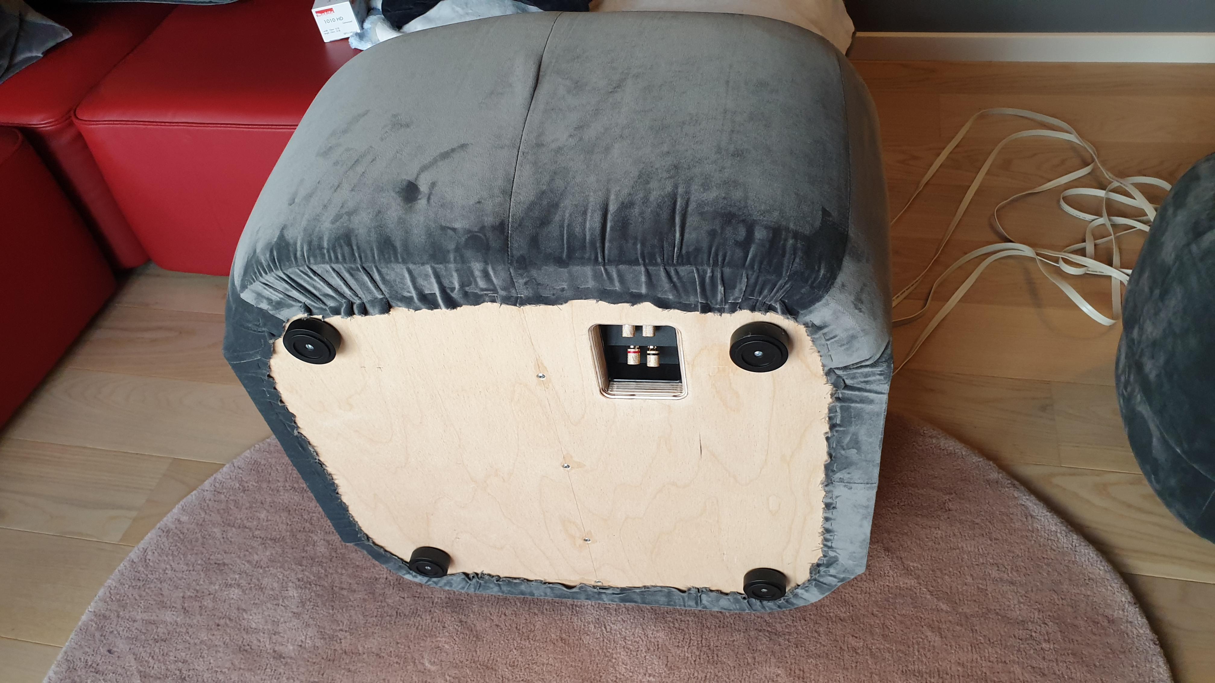

Upholstry and a measurement. Room has a mode at 37, I can't really fix it with DSP and moving the pouf is obv. not an option. It does still sound very nice, not boomy but punchy when it needs to, it's mostly used for films.
feel free to ask questions.
