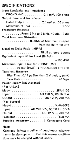

hi, when I connected this KHA50 to my system with a DL103 , I was supprised how quiet it was. Then I searched for the schematic, and there I found a very interesting design of a symmetrical power supply.

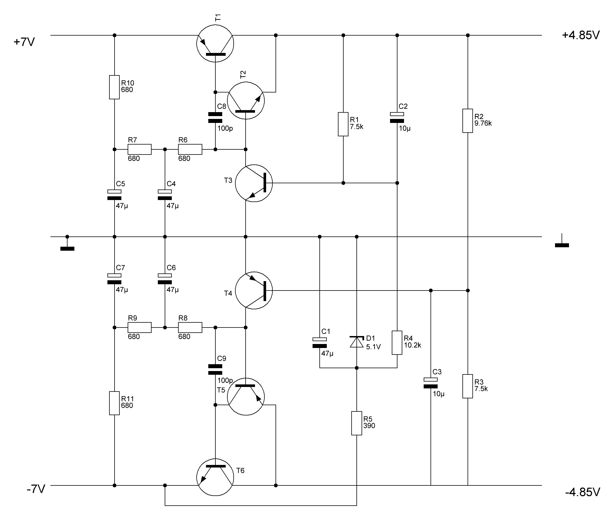

here is a clear schematic and a lochmaster layout from above circuit.
The KHA50 working voltage is a little below +/-5V. But I think it can be adapted
also to other voltages

It seems IC1 should be in the schematic as it creates a virtual GND. What is the type number?
I think a design with CLC filtering and both LT3045 and LT3094 can be made way smaller and with less noise as well.

BTW I just looked up the schematic of KHA50 and I would use best available quality caps for the 4 pieces 100 µF 10V at the inputs. I have searched my stock of SAL caps because of another thread and if you like I can sponsor replacement of the input caps with superb 128 SAL RPM solid aluminium caps. I have those in 47 µF 6.3V and 68 µf 6.3V. Since these tolerate almost non polar application and have ultra low leakage I think they will outperform the current parts. Well I am sure of that, certainly if the original parts are still there. I hope the tube guys see the schematic only to conclude Kenwood used a "shorting to GND" muting relay 42 years ago 😀 For many this is too modern even today in 2021.
The output sections seems unusual with 2 caps in series. In the complete schematic it is clear that IC1 creates virtual GND and keeps symmetry.

You omitted IC1 too (if you will use a single PSU feeding the circuit). But that is not what I mean, I mean the original circuit seems to have some errors.

I do not need a virtual ground for my purpose, because I intend to use a
double AC supply which gives me a ground, or a delon quadrupler
which makes from a single AC supply a symmetrical voltage, when the middle voltage is used as ground. Thatsway I do not show it.
