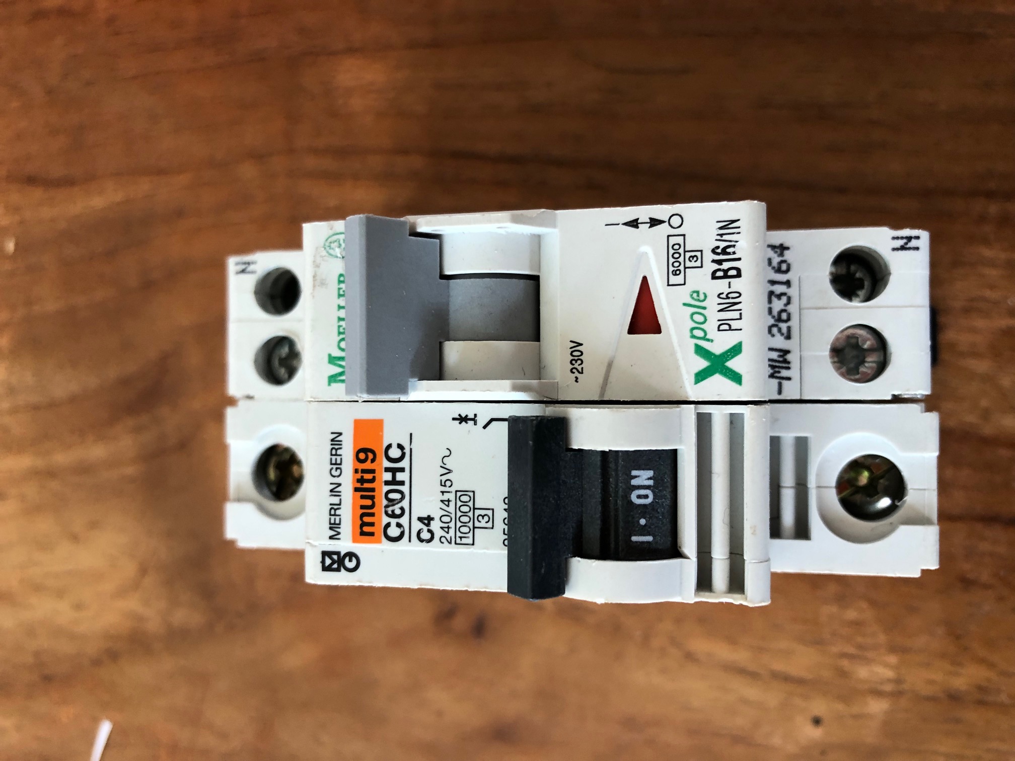

Low current breakers exist in DIN rail format. But ... wiring still needs to be the standardized gauge here (2.5 mm2 for L, N and PE, 1.5 mm2 for switched wire to light points in ceilings). A new house owner may decide to install let's say a few 20W LED fixtures per room and a 16A breaker on that light group....
At the left an old breaker 4A C class, at the right a 16A B class. That specific 4A version is now forbidden, can you tell me why?

The 4A is a C Class single pole unit. is that why it is banned?
